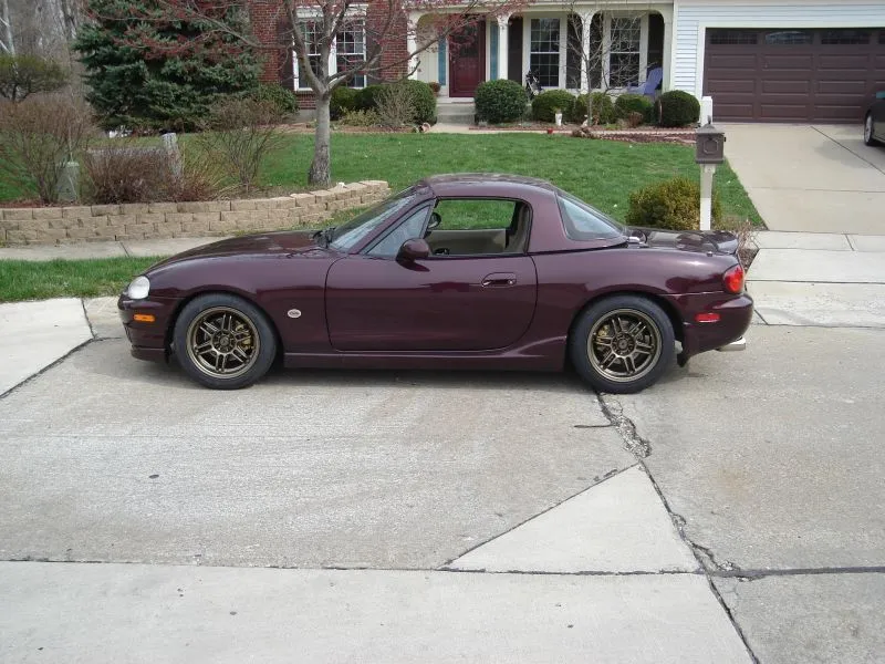

Picked up my hardtop from my buddy who got it for me while I was gone.
Installed my shift boots and Beatrush lower bushing last night. Couldn't see how to easily replace the lowest locating ring, it was in good shape so left it in. My lower boot was torn all around, the upper one looked new but had a small tear. The wave washer located above the upper locating ring was missing, so that upper ring wasn't doing much of anything. I'll find out today how shifting has improved.
Chief posted a picture?!?!?!?!?!?!?!
Hahaha, just kidding man. Looks good!
Yeah, yeah. Make fun of the old man. Just remember I have a long memory...
Thanks Phen.
