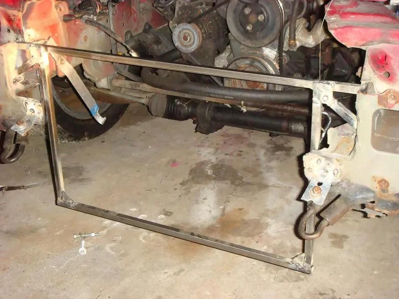

Not done, but here's what I did yesterday. :) Plenty of room now. Although not pictured, i made some braces to support the corners. If I press my foot down, there is no deflection :) Going to get a aluminum crossflow radiator (24"x16" overall 2 1" core) to mount behind the support, and the intercooler fits perfectly up front. Still need to make the brackets for it.

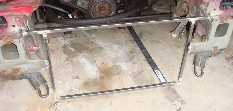

Ok. got another pic taken of the new core support. Once the raditor gets here, I'll make tabs on the bottom to hold it, but need the final measurement.

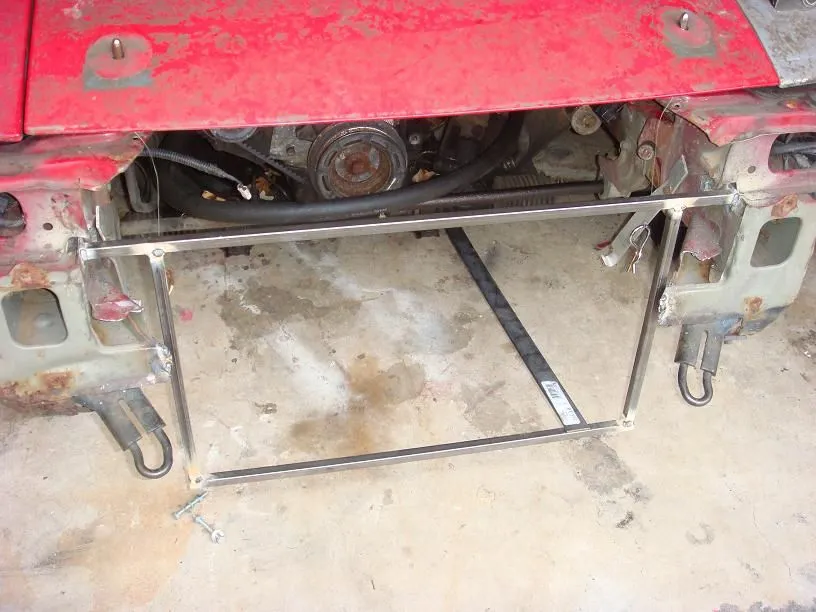

Are you going to add any additional support to tie the two frame rails together? I foresee a significant amount of torsional twisting in the front end with that much metal removed at the front.
Fadi,
yes i will. But honestly I don't see that much force that far up. It's well ahead of any suspension component. But i'm planning to add a bar up from to act as a bumper/support.

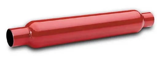

Hey folks wondering how the miata will sound with this glasspack (cherry bomb). Option one is change oem resonator for glasspack & stock muffler, option two is change oem muffler for glasspack & stock resonator. Remember header/cat/pipes will remain stock on both options.
Opinions on both sounds will be appreciated! (yippy)
Thx!
