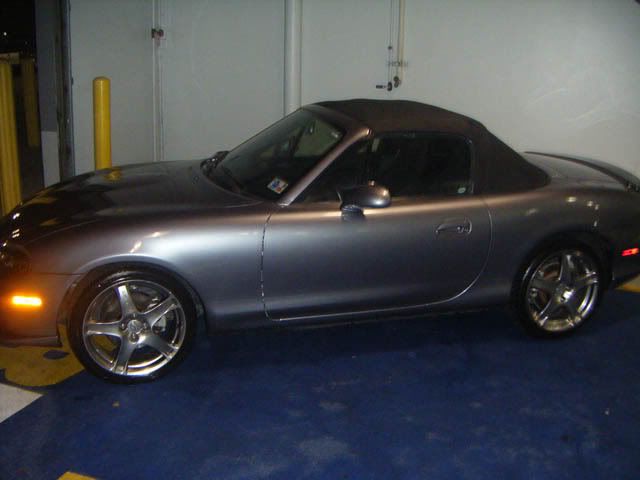

05 Mazdaspeed Miata
27K miles
Probably gonna do the 30K tuneup before i start pushin her to hard =)

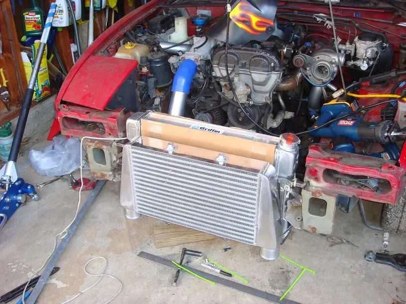

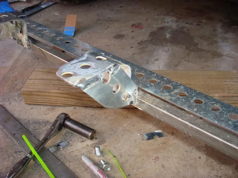

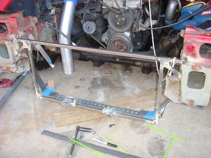

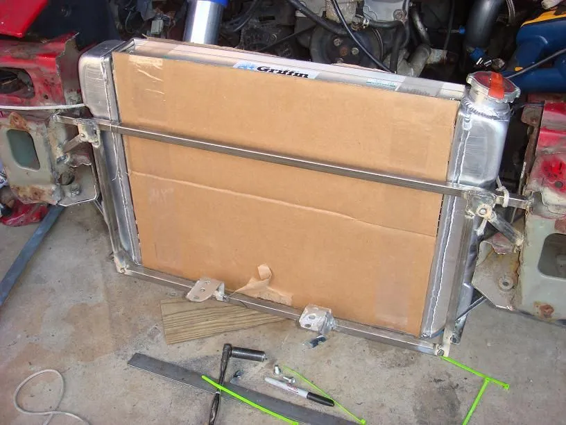

Redid the core support after rethinking everything. I've decided to raise the radiator and intercooler and have the intercooler pipes run under. That way if/when I do have 'off', if there is damage, the pipes are cheaper and easier to replace than the intercooler or radiator. Also the higher mounting will make it easier to make the extraction hood :) The radiator is a Griffin 24x16x3 universal 'Ford' style, and uses saddle mounts. I put rubber pad down to cushion it (just held in place with tape for now until I take it all apart and paint it).

You weren't kidding! That is a chunky I/C. It's coming together nicely. I look forward to more progress pics :).
+1 on that fmic.
However, I noticed something rather odd.
It appears as though you will have to run your IC pipes down before you can go up. It may pose a problem with clearance...?

clearance? I have a whole 4.5". that's plenty unless I confuse the Miada with my truck and take it off road... ;)
oh non lowered eh? LOL.

No, it's lower 1.5" :)
