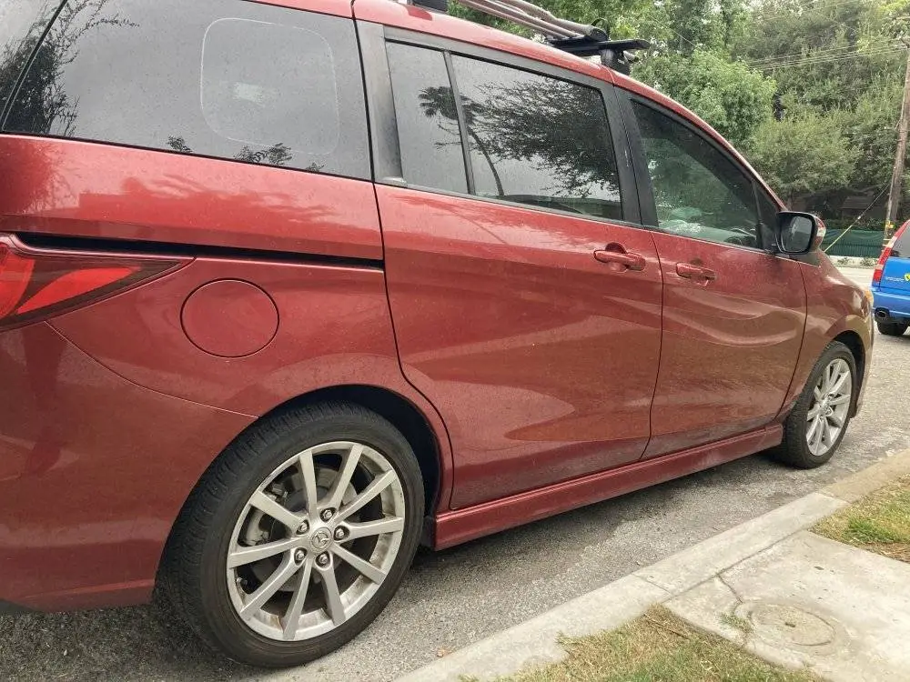

Miata rims. This is really the only mod the micro van ever needs. Instant better feel on acceleration and room to clear mazdaspeed calipers. 👏👏👏

I would skip the 16" wheels and go right for a set of 17" Miata wheels. Paired with a set of 215/50-17 tires will transform the way the car feels.
em, you are saying that with 17" Miata wheels. Paired with a set of 215/50-17, it will feel like a car?
Anything else? Appreciate if you could expand on this?
So those wheels transform the Van into a Car like feel! Anything you could elaborate?
So I did some digging, and it looks like you have a Sport model with the OEM 16 inch wheels, and you don't drive all that much. The 17's will be an upgrade to the OEM 16 inch wheels. The 17's will give more road feel, and improve the handling from the stock suspension. They won't give a magical transformation to make it feel like a sports car, but they will help it not feel so remote on the road. Our Mazda5 with the OEM 17's was a bunch of fun to drive, but it still felt like a tall wagon. m Not running economy focused tires will help in the handling department, too.
What do you want out of the "car"?
Would the CX-5 2008-2015 rims/wheels the same as Miata?
No. The advantage to the Miata wheels is the weight. Miata wheels are much lighter weight. Mazda5 17" wheels are ~22lbs, CX5 wheels are about the same. Miata 17 wheels are ~17lbs. Lighter wheels will help with acceleration, braking, and handling.
