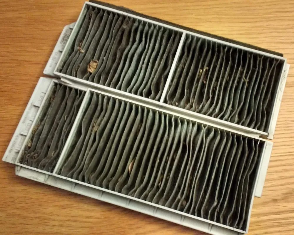

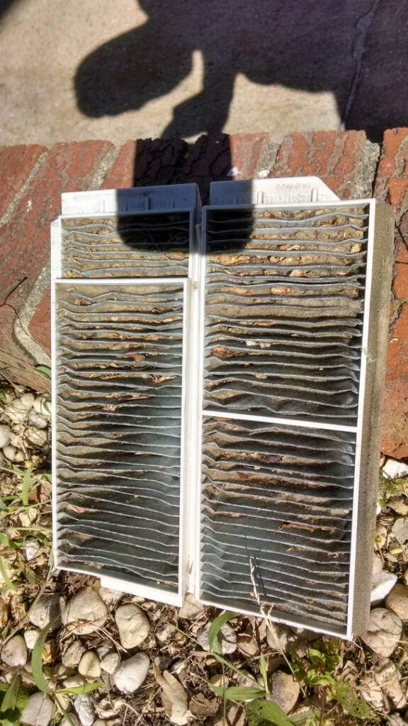

Changed a forgotten filter
Today I learned not to assume that since all the other filters were changed when we bought the 5 off the lot, that someone must have changed the cabin filter too.
(Pile of leaves removed for clarity.)

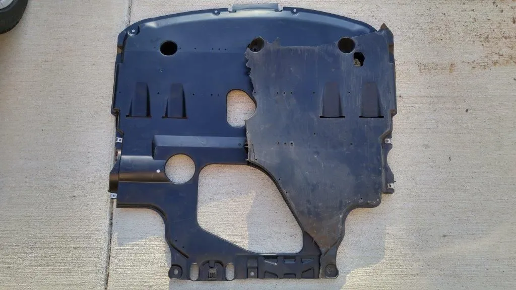

First oil change...and lower shield replacement!
My new-to-me M5 GT got it's first servicing this weekend: R&R the original battery, and then an oil change.
That let me swap out the original lower engine shield with it's replacement. I'd noticed a piece of it was broken when I examined the car during my test drive.
Turns out: about 2/3rds of it was GONE. Judging from the what was left, I think the original owner scraped over a cement parking bumper and ruined it.
All tidy looking now with the new one. I like how they left some service access openings in the new design, that was a bit of a pain to have to R&R the whole thing for each oil change on 2010 (and I didn't feel like cutting a hole in that one!).

Preetty sure my '14 doesn't have the access hole on the left which is probably for draining the transmission. "Lifetime fluid"... (rolleyes)
I think the one on 14MY looks the same. When I removed it prior to my first (and only so far) ATF drain, I got CG15-56-110A off of the sticker on it. I think the same part was used for all 2012+ 5's. I could not figure out a way to drain ATF with the shield on so ended up removing it. That hole is probably for something else. I do appreciate the oil filter access though!
My new-to-me M5 GT got it's first servicing this weekend: R&R the original battery, and then and oil change.
https://www.mazdas247.com/forum/
I used a 5" hole saw to make a filter access hole on my 09. Very silly they didn't consider it themselves.
