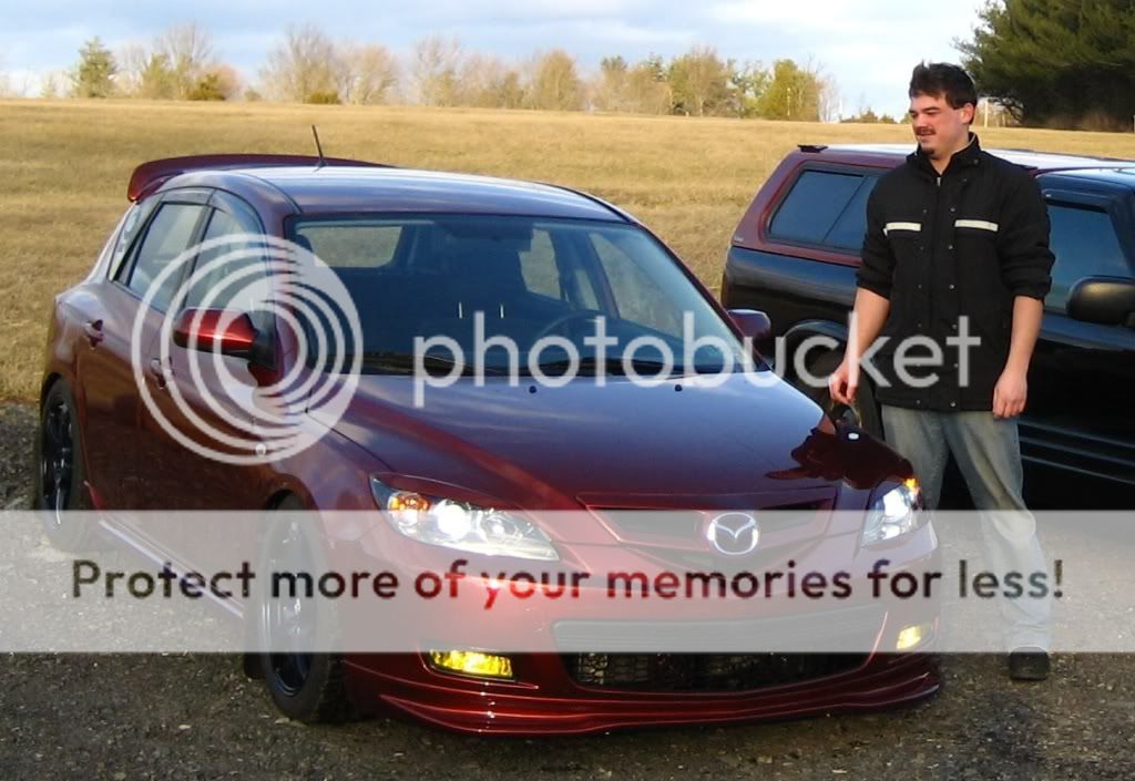

Nice splitter. It looks good, and if you ever track the car it should help w/handling stability at speed as well.I installed a GV replica front lip and autoexe replica spoiler. The 3 sure turns some heads now.
