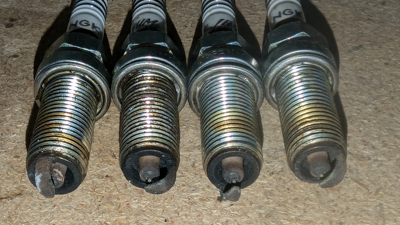

The tops of your spark plugs have oil residue on them. Either overfilled oil at some point or a valve cover leak , possibly.
Def not a valve cover leak as stated my cx9 was fully inspected and all was good. It’s still new virtually at no even reaching 38k miles yet. Your is based more than likely on the time previously mentioned when the tech didn’t put the washer which caused a drip by the filter. I overflowed it until I took it back for service that year.

For reference, here are my plugs, changed early on my NA Skyactiv 2.5L at around 65,000miles. The car has been tuned for premium for approx half that mileage. Most that mileage has been light load, and a relatively light foot. Nonetheless, you can see the difference in cleanliness of combustion chamber conditions between NA vs. Turbo Skyactiv.

The main things your spark plugs tell me, is likely hard use. I would have suspected a hard pedal, but you said that it's a family workhorse, so that explains it.
Turbo Skyactiv's run richer than the NA, and it shows, looking at the thread on your spark plugs. They're dark. The turbo requires more frequent spark plug changes.
The light golden coloured on my spark plugs thread potentially point towards lean AFR's, which the NA is known for.
Other than being more gentle on the throttle (seems you are at half throttle alot, based on your pic) I would suggest to change oil sooner. :)
@Hhova29 oh and, the oil residue on the ceramic white insulator portion of your plugs indicate significant overfill. Be careful with that. (Highly unlikely your valve cover gasket is leaking from the inside.)
The stain is called Corona stain and it has nothing to do with oil overfill. My old plugs got more stain than that and I've never ever overfilled my oil.
Then what is it? Because I had a valve cover leak, and I noticed oil built up on that section of the spark plug.

Your plugs look completely normal. I'm at 120k kms now and I've done two plug changes, and each time the plugs looked the same. Same corona stain, same "darkness" at the electrode. Perfectly normal for this engine. No need to worry about changing what you're doing - as the dealer said, you car is in great condition and they gave it a clean bill of health. As another 2.5T data point, I change my oil every 7-7.5k kms.
Thanks! I presumed, (and still presume that it can be) due to oil. I saw some wet oil deposits in that same area due to either overfilling or a valve cover gasket leak (the outside has long since resealed and dried, maybe not on the inside...) the staining on his plugs looked significant, so that's what I thought it was.

The link describes corona stain as an oil build up, so you're half right. It's just not due to a leak, or overfilling. Wet oil on the threads, on the other hand, would point to a potential valve cover gasket leak.

I understand. My threads were dry. However, I did notice some wet oil on the ceramic insulator portion. You're saying its a leak/overfill only if on the threads themselves?

No, I'm just saying that if there is wet oil on the threads, that is most likely due to a valve cover gasket leak.
Google says that wet oil on the ceramic insulator may be due to worn piston rings or damaged valve seals, or it could be from excessive crankcase pressure or a failing PCV valve.
