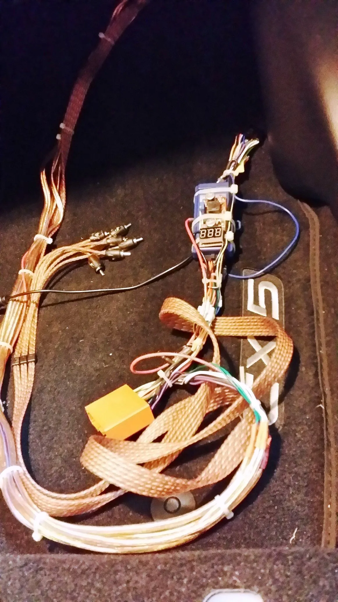

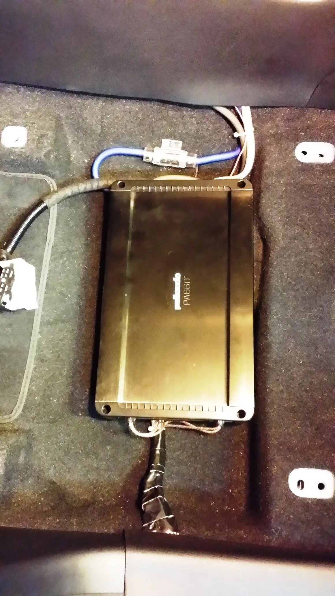

Here are two pictures, about today's work.
I'm not done with the install. I'm making it in steps, when I have some time.
The 0 gauge wire, is installed from the battery through the firewall where I have used a plastic cord gland connector. It is ran all the way under the driver's seat and it is split into three 8 gauge wires.
One wire, will go in the back for an inverter, that I will have to install.
The sub amp, it is installed under the driver's seat, the wires are ran all the way to the back and all the way under the passenger's foot area.
The four channel I have installed today with all the speaker wires, RCAs and remote wire all the way to the passenger's foot area.
Next time, I will have to replace the stereo with a Kenwood DNX6990HD for now. I may be able to repair a DNX9990HD and if I'm successful, I will replace it with that.
After that, I'm moving in the trunk are to install the sub.
I'm soldering everything, no taps here.
This is my first install, I hope that it will work from the get go. That steering wheel control and Kenwood wire it's pretty scary. Hopefully I won't have accidents.

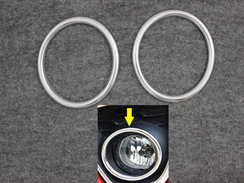

Just the pics & lighting. They are stainless steel and look like this in better lighting.
Similar to Mazda3
