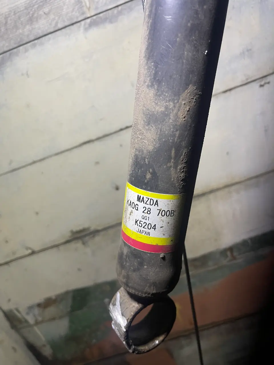

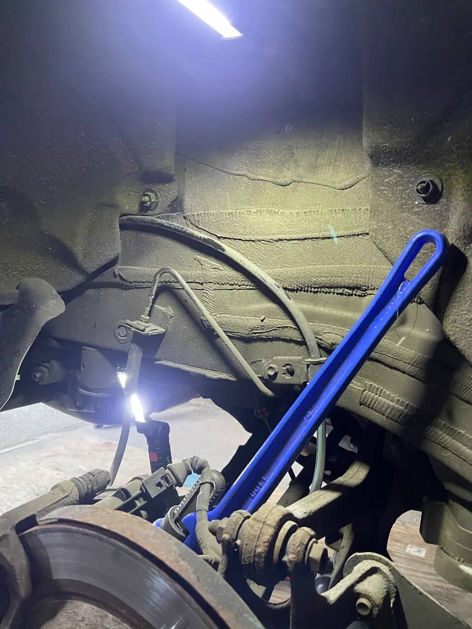

Replaced some parts on rear driver side:
- rear trailing arm + new hardware
- rear lateral arm + new hardware
- rear lower control arm + new camber kit + new hardware
- rear link kit
- rear spring
- rear shock + mounting plate + new hardware
Camber bolt was seized in bushing so had to sawzall it.
Spring was broken off near bottom.
Shock bolt was seized in bushing - had to angle grind the shock and take it off the bushing, remove the rubber and take it off with lots of heat and time. Not fun at all.
Was surprised to find KA0G28700B shock — can’t find this part number online to cross reference ?
Just about 250k km / 155k mi
Passenger side is next.
Cheers
Finished passenger side last night.
Replaced same stuff as on driver side:
- rear link kit
- rear spring
Just like driver side:
- shock bolt was seized in bushing --> experience from driver side --> grinder to get shock off + 24" pipe wrench to turn the seized bolt
- camber bolt was seized --> sawzall to get out
Hit 252k km.
I hope I'm done with suspension work for this year lol.
Next gonna do both inner tie rod ends this week and book alignment.

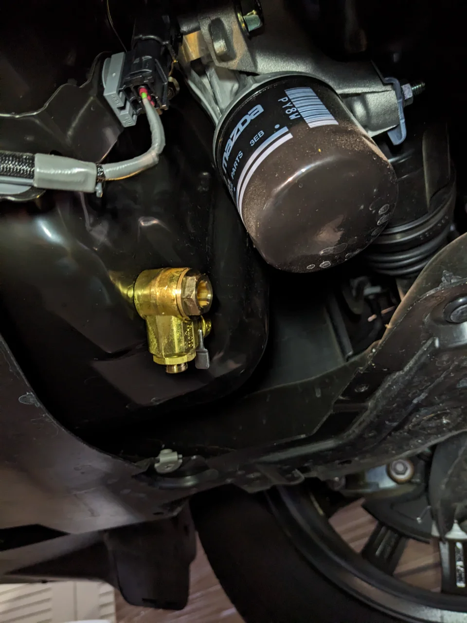

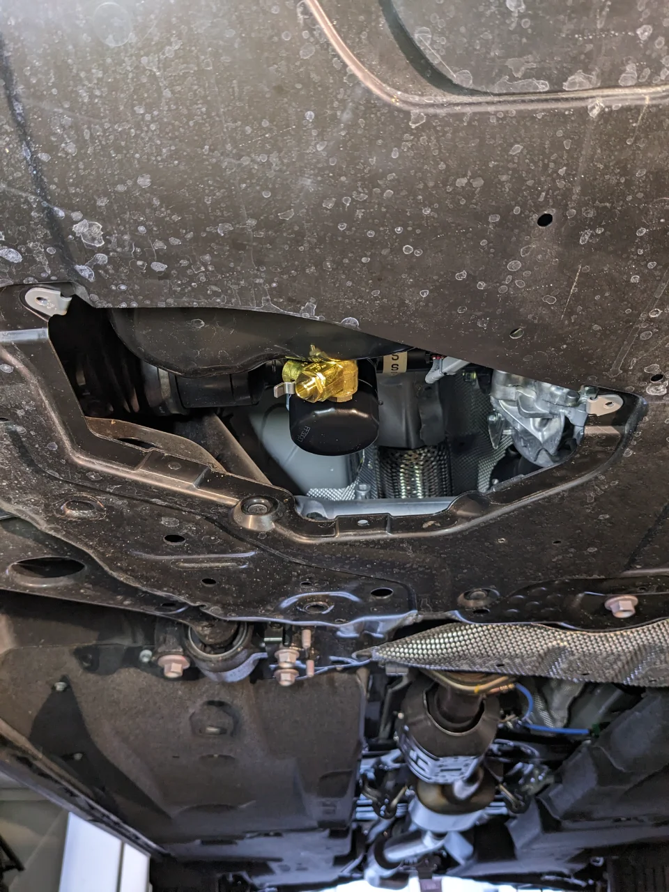

Oil change in progress. I don't use an oil drain pan.
@N7turbo -- Just wondering which specific Fumoto drain valve you installed. Was it the F106SX (M14-1.5) model?
I'm considering one for my 2016 CX-5
That's the one. Did I really need the adjustability? I'm not sure. I have it rotated slightly toward the passenger side so it clears the plastic cover. Maybe a lower profile one would be better, but this works.

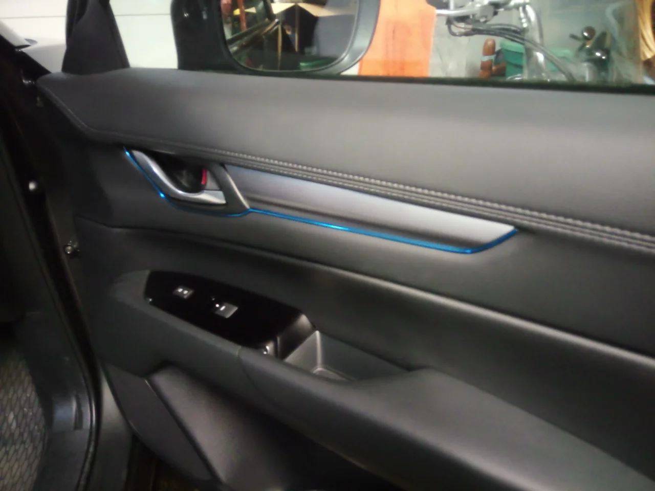

I put some trim looking decorations in

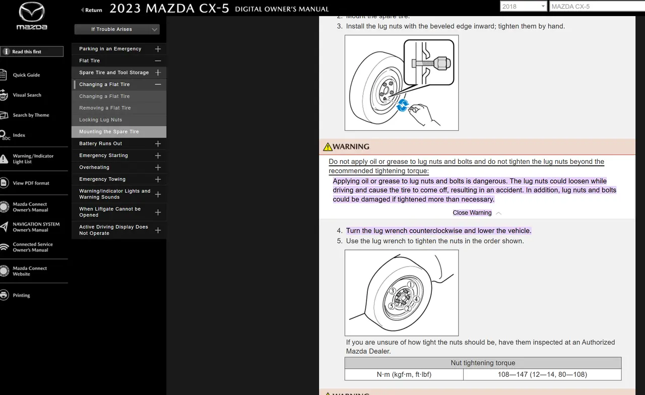

Don't forget the anti-seize compound on the lugnut threads!
I just now googled this question.
Lots of answers both ways. I've always used it and from what I've just now read, I'll continue to do so.
No lugs nuts are going to come off because of the use of Anti seize compound, not if they're torqued properly. Did I torque em properly? Most would say not, since I didn't use a torque wrench, only by 'feel' and my calibrated arms.
I've been doing it this way forever without issues.
YMMV

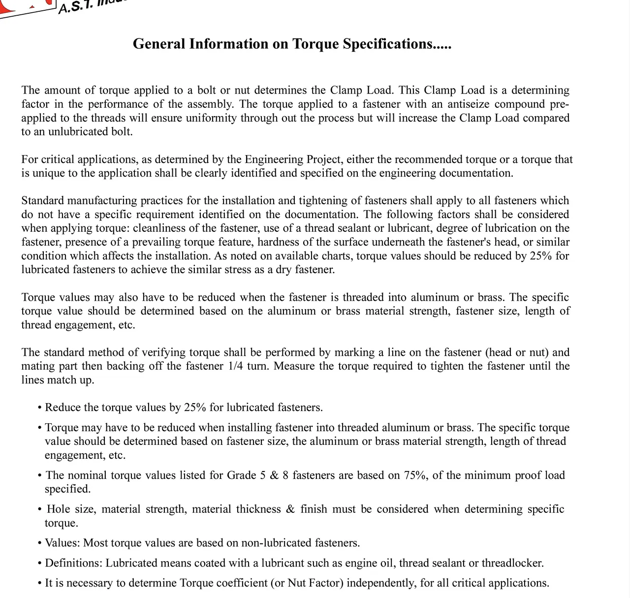

You spent $$ on an impact wrench but not on a torque wrench? Hmm…🤨
When I installed my aluminum wheels, I put anti-seize on the hub where it contacts the wheel. I was careful to not get any on the threads.
When it came time to re-torque the lug nuts, I noticed they had dropped from 95 to around 80 lb ft. That seemed like a big drop to me.
The next time the wheels came off—about a month or two—I noticed some anti-seize had gotten onto the threads. I cleaned them off the best I could, and also cleaned off the inside of the lug nuts and the mounting holes of the wheel. I realized that when you install the wheels, if you don't perfectly line them up and slide them on on your first try (rarely happens), the anti-seize that transferred to the wheel mounting hub will contact the lugs.
