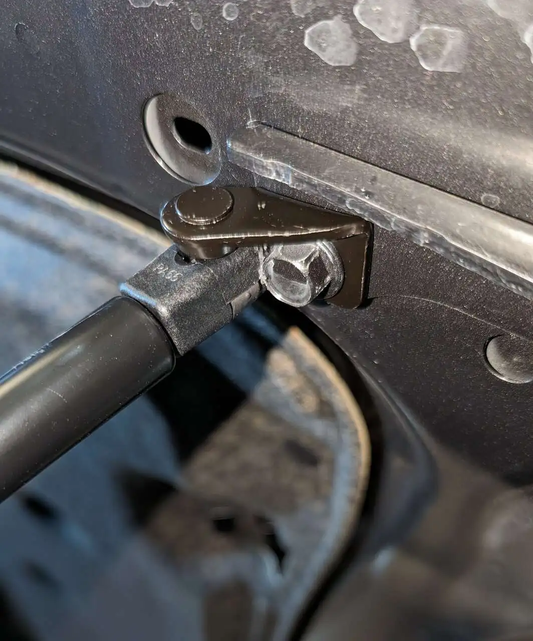

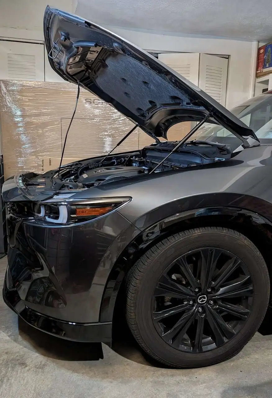

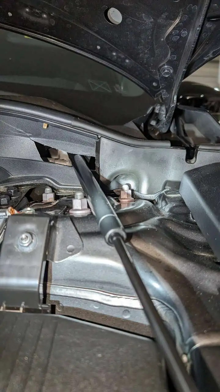

It popped off again. I think this strut is defective. It positively clicks on but won't stay on the ball. It also doesn't sound like the other one when extending. Normally you get that hydraulic strut whirr but this one sounds rough. Just my luck...
It went full send. Never go full send.
Another thing is that the socket on each end is plastic which I don't feel great about. And they rub against the hood bracket bolt. I don't know if that will cause any issues but it's already scraped off some of the plastic and I've only articulated it a dozen or so times.
I might ask for a replacement but I need to think on it. Is it cool and helpful to have them? Definitely. Do I question their long-term durability...yeah, I do.
The struts themselves seem too strong, even with the heavy CX-5 hood. I've traded faffing with the prop rod for having to pull the hood down with force because the struts are crazy strong. Not sure which is worse...
Edit: I found the problem. The upper strut connector rubs against the hood bracket bolt, pushing it out of the socket. I mounted it the same way most people recommended (and who never reported any problems) which is to have the bracket facing forward with the ball inward. The issue is that the bolt has a lot of play within the hole so you have to put force against it so that it is all the way to one side and clears the plastic strut connector. There are no instructions telling you this and it is not obvious at all when you are installing. Make sure the bracket is pulled forward as far as it will go. Connect the top of the strut first and move it through its range of motion, making sure it clears the bolt. And it still rubs at the bottom of the range of motion, scraping off some of the plastic. It's not a good design. I hope people see this and avoid damaging their car.
Also, now my hood is not aligned properly when closed. That will take removal of the struts and more fiddling.
What a night. Thought this would be a simple install and I ended up having more problems than anyone else. Wish I wouldn't have bothered.
Boy sure glad I signed up to this forum, I purchased the same hood damper, about to install them, until i found this post. thanks for sharing @N7turbo, at the end of the day, are you sticking with them or changing them out?
Install fiasco aside, I think the functionality of them will have me keep them on.

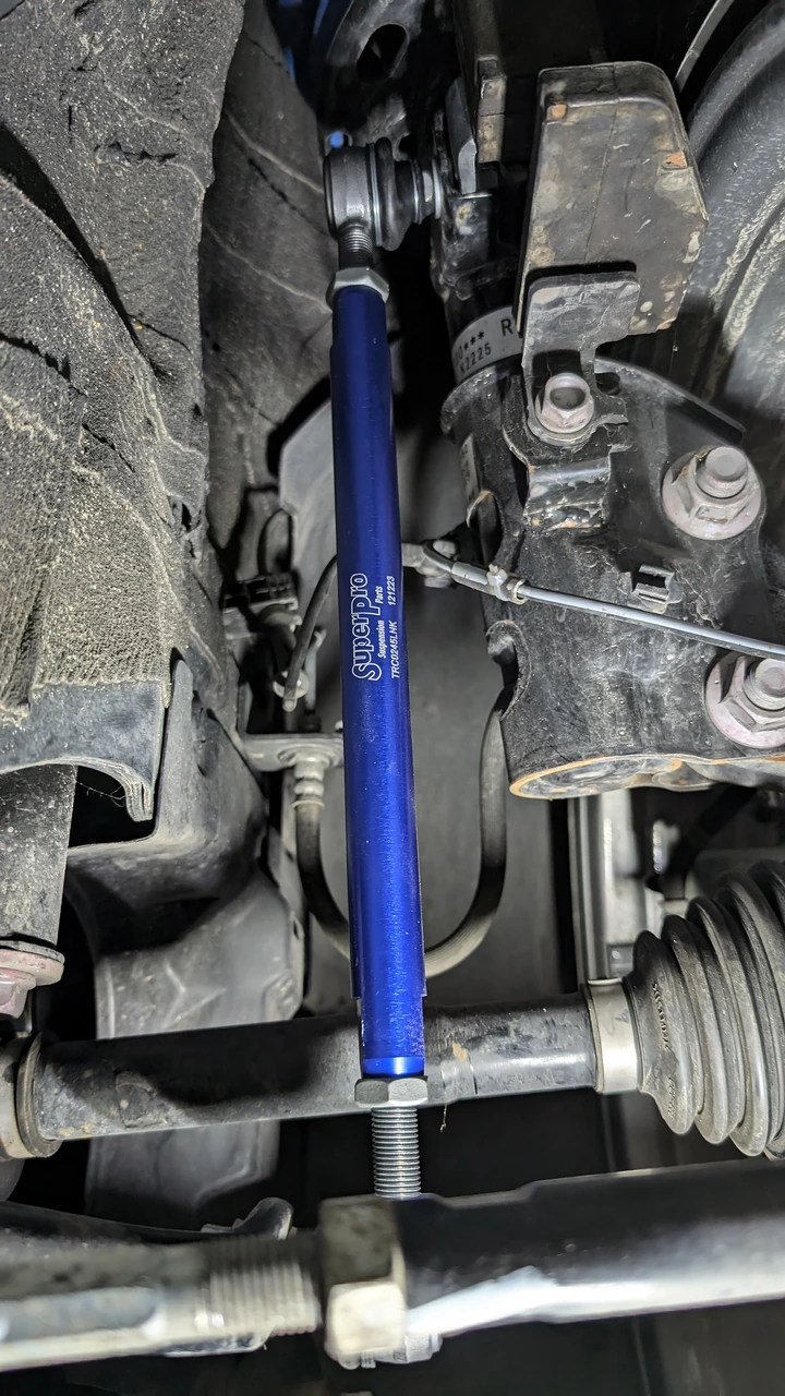

Tightened down this bugger and tripled down on the threadlocker because it was clunking like crazy...starting to wish I could get non-adjustable links made to any size needed.
Sorry I can't upload better resolution, guys, we're stuck at 1280x720 like it's 2005!!!
