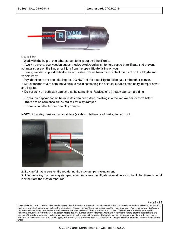

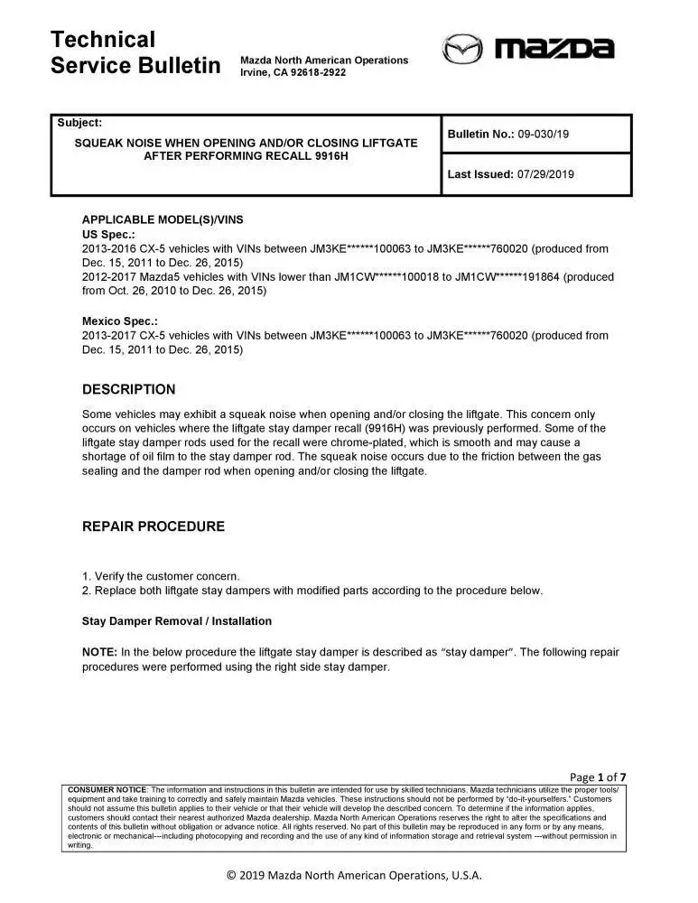

Ha, most gen-1 CX-5 owners, including me, regretted doing the liftgate struts recall as the replacements are weaker and shorter. Some started having noise very soon, and the liftgate opening height becomes lower and easier to bump to the head. At least one member had to replace the replacement struts again with his own expense.

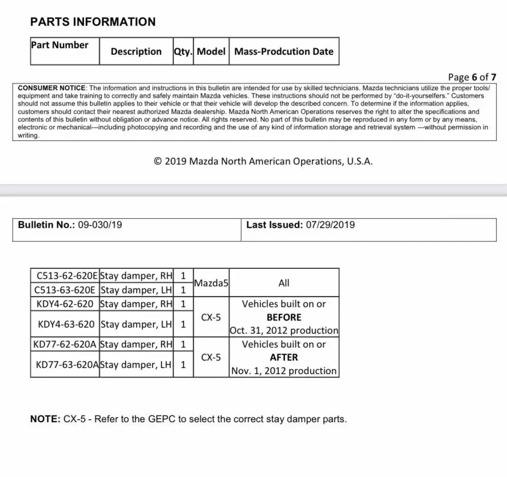

For what its worth the part number for the replacement struts on the invoice was KDY8-76-61X Kit,Stay Dampers, Looked up the cost on the site that Necroposts part numbers linked to and they came up at 46.08, a few bucks more than 1 side of the ones he ordered…..”cheap“ is what the recall replacements are lol.

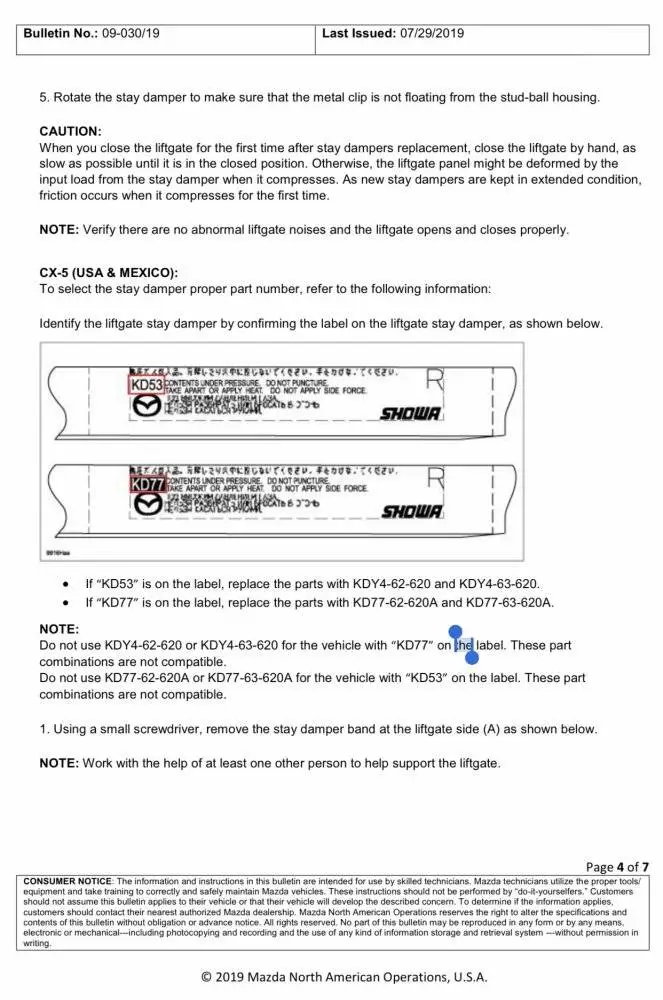

Interesting. So struts used for recall are different from struts on Mazda’s parts list? You have one part number KDY8-76-61X for both side from the recall, but Kedis82ZE8 got struts with 2 different part numbers, KD77-62-620A (Right) and KD77-63-620A (Left)?

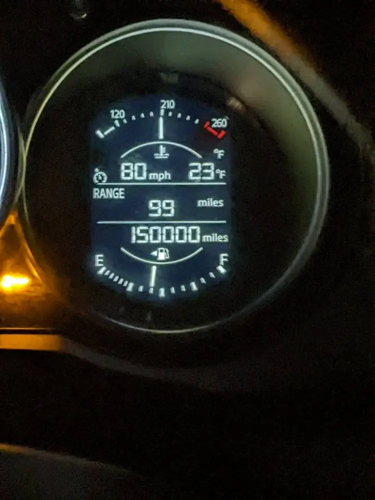

Hit 150,000 a few days ago on my 17 CX-5 Sport. Had my Rear Differential replaced a month ago, otherwise it's running like new.

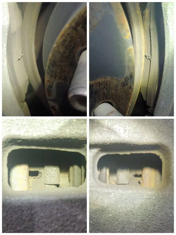

Tire rotation and brake inspection. 41.5k miles on the 2.2 diesel (USA) and pad thickness is Front 10mm and Rear 7mm and even wear between inner/outer and left/right side.
Everything is free moving and little corrosion. Rotors look and feel great. I see no reason this won't make 100k + before brake service is needed.
So based on this TSB, there’re two different liftgate struts for gen-1 CX-5, KD55 and KD77, and they’re not compatible?
And not sure where the KDY8-76-61X strut set are coming from for Westy16’s recall?
Just a quick follow up on this, did a search on the part number of the strut they used on my recall and found this https://static.nhtsa.gov/odi/rcl/2016/RMISC-16V644-4585.pdf
see page 14 it shows the part number used on mine in red type, hoping Mazda changed vendor they were getting the struts from or had the part updated since the recalled ones were failing.will post if my updated ones fail in the future (hope not).
