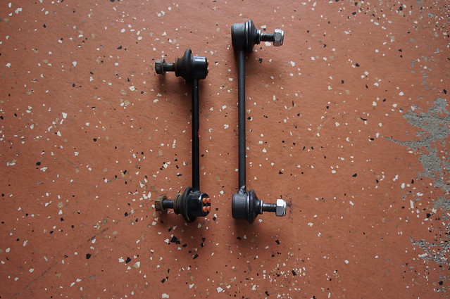

That's the difference. I'm still on stock springs (my wife hated the ride with the H&Rs), since the Corksport bar lever arm is shorter it ends up at a different angle when using the stock links. The ones I'm getting should restore the angle so it is closer to stock.

Installed the new end links yesterday but wasn't able to take a drive until today. Despite it being wet enough that I couldn't push too hard I noticed a marked reduction in body roll. Sway bar lever arms are now parallel with the ground, there is approximately two inches of clearance between the end link and the body so no chance of contact. I haven't tried jacking up/lowering the rear to see how it moves, that will happen when I change the oil in a day or so. The stock links are 5 15/16" in length center to center, the new ones are 7 1/2" center to center. If you are running an aftermarket rear sway with stock ride height consider doing this.

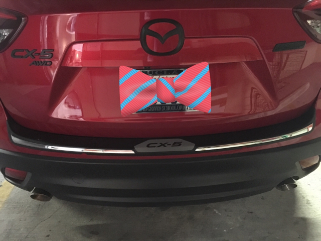

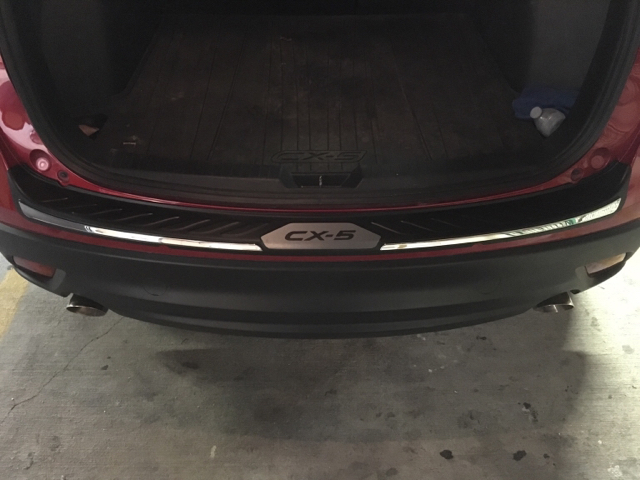

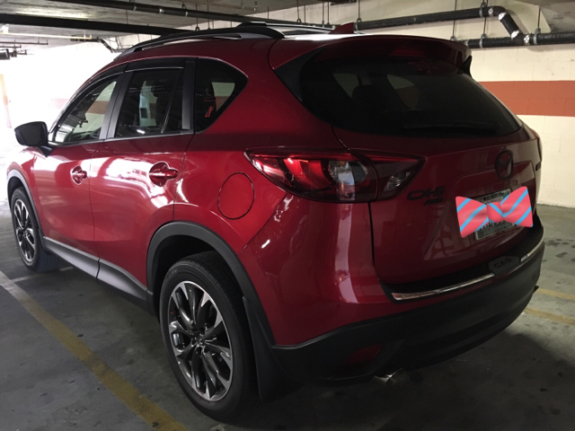

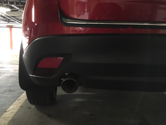

Installed exhaust tips and rear bumper protector. Sorry for the garage photos. There was no parking available outside -_-
I'm not digging the chrome on the bumper too much. Will plastidip it when I have time.
Don't know how I can make it any clearer. I am not on the same setup as you. Glad yours is working as advertised, mine didn't so I took steps to correct it.
