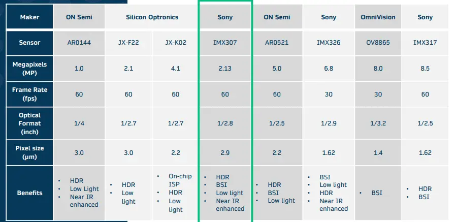

This chart is useful to see some of the popular sensors and what they can do. I am not sure why one of them is highlighted. I guess it was a featured sensor in the document.
You can see the three levels of sensors. The middle is what you see so often.. The top 3 sensors in that chart are much more serious.

  • In the chart, the only sensor that can actually do 4K is the IMX317, which is what I have on my A129.
