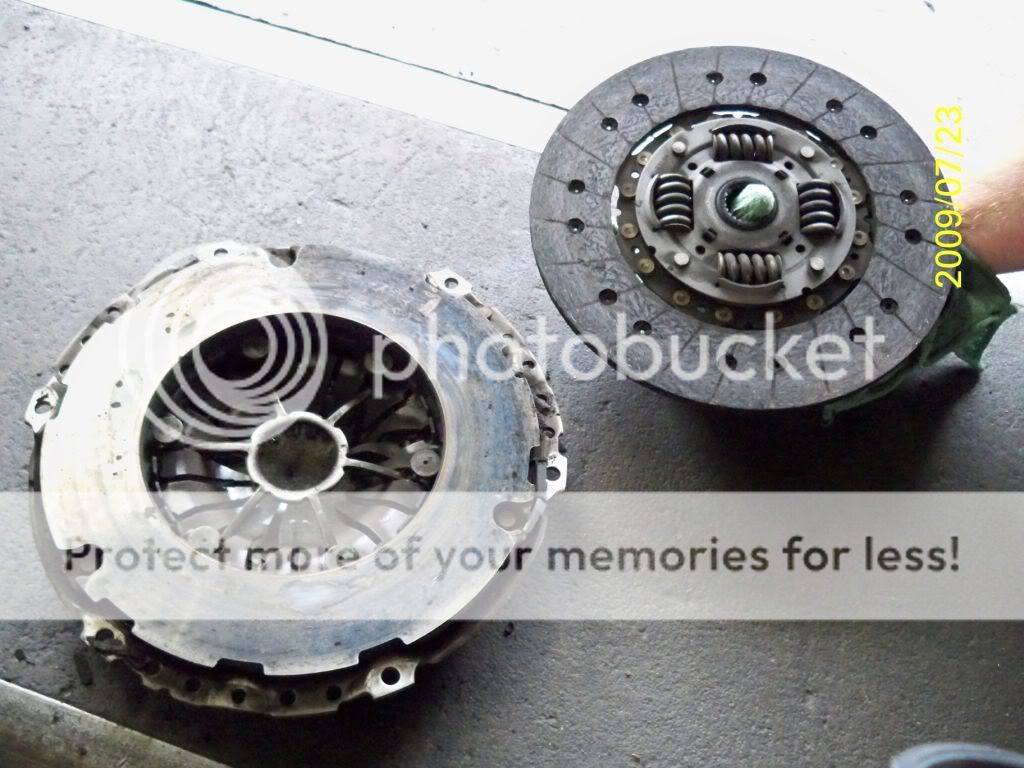

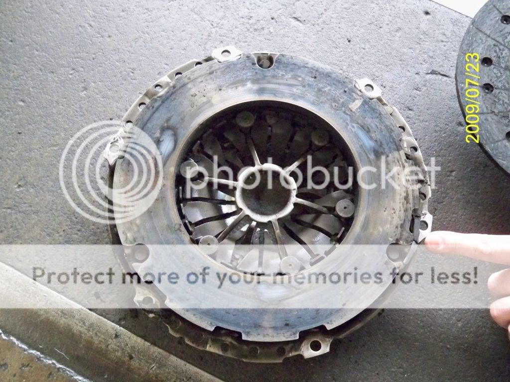

So I was told that I have a hot spot on my clutch but I don't know that much about car yet lol so I dont really know what that means. First of all what causes a hot spot on a clutch to form. And what really does a hot spot mean?
Also I had a problem with my 2nd gear popping out and they said that it was due to some broken gear teeth. Here are some pictures they sent me
slipping your clutch on a hill to keep from rolling instead of holding with the brakes can cause hot spots
the flywheel is a dual mass flywheel and will most likely need to be replaced, the oem replacement are expensive. Many will tell you it can't be resurfaced, but it can and it may be hard to find someone to do it.

basically the metal has gotten sooooooo hot that the metalergy has changed and it doesn't work as well as it should. yea coulda been trying to stay still on a hill or starting out in 3rd from a stop, lettting the clutch out too slowly. any number of things that would inherently cause major heat

That could easily explain the clutch damage but not the broken transmission (gear damage).

Ya I don't use e brake anymore I can start fine from hills now it was just in the beginning I was kind of harsh. But ya mazda is fixing the tansmission after they declined the claim at first, they changed their mind from my annoyance. I was told today that it will take 4 weeks for the part to come in to fix my transmission :(

the hot spot means one area, or in your case three, have taken the brunt of the abuse. thats because the theorectically flat plates and disc are not truly flat when you add heat and axial pressure and speed differentials. during small periods of time you have a stick/slip/stick thing going on, during the stick phase, cooling takes place as the parts are actually locked up and motionless to each other. when it starts to slip again then the heat builds back up. this is commonly called chatter. with the harmonics of the situation added in, the "slip" and cooler "stick"happen in the same physical area of the disc, locally heating one area more than another. carry it far enough, and you get the metalurgical change in the crystal structure the other poster mentioned. checking is another, where a fine pattern of surface cracks appear, plain warpage will cause one or two highspot to form which obviously are always first to contact and make more heat
