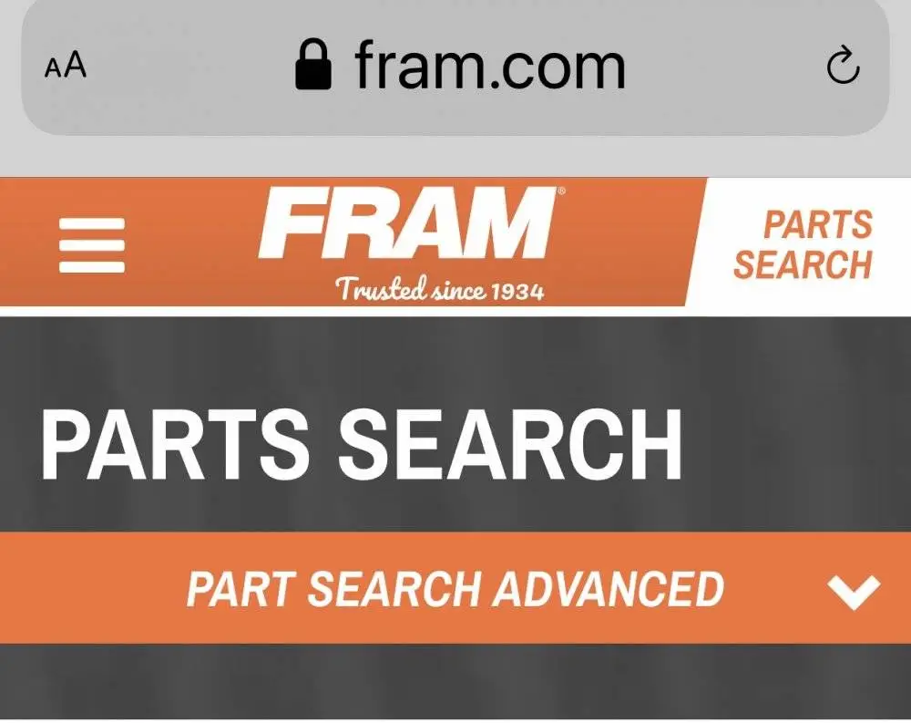

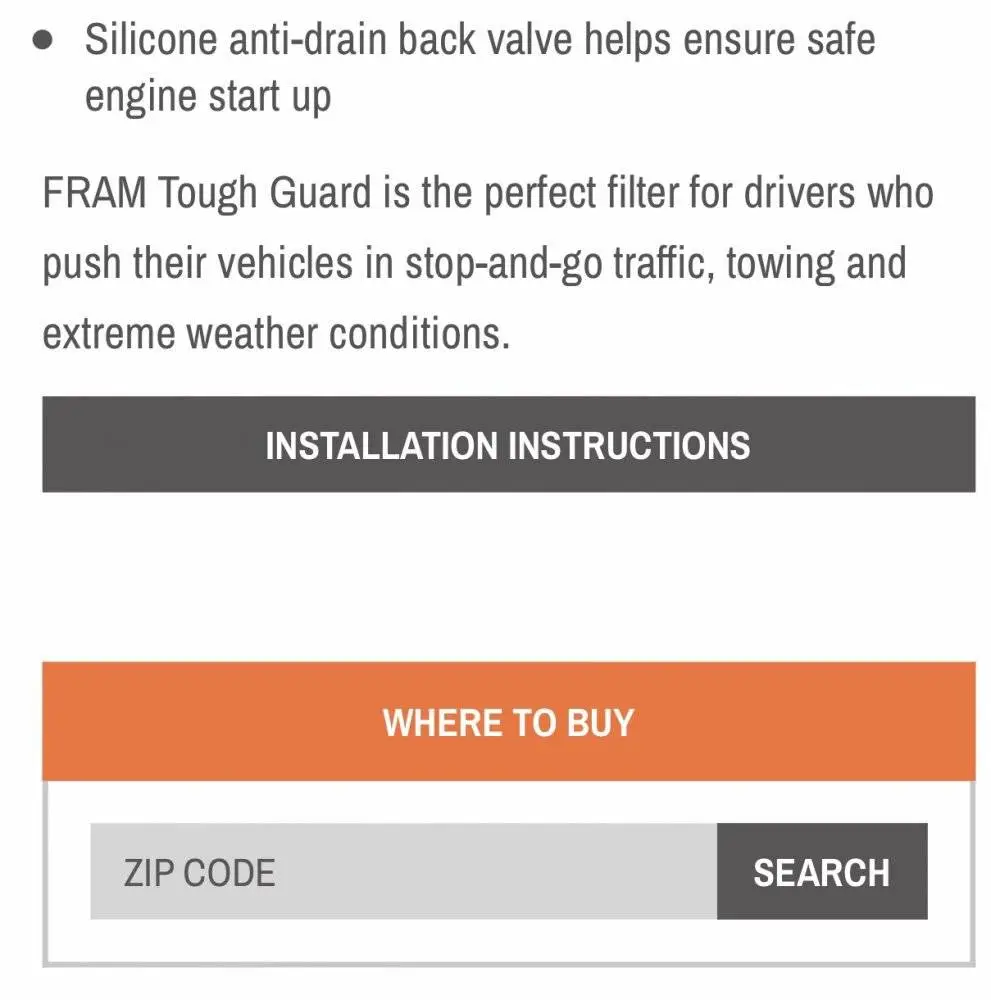

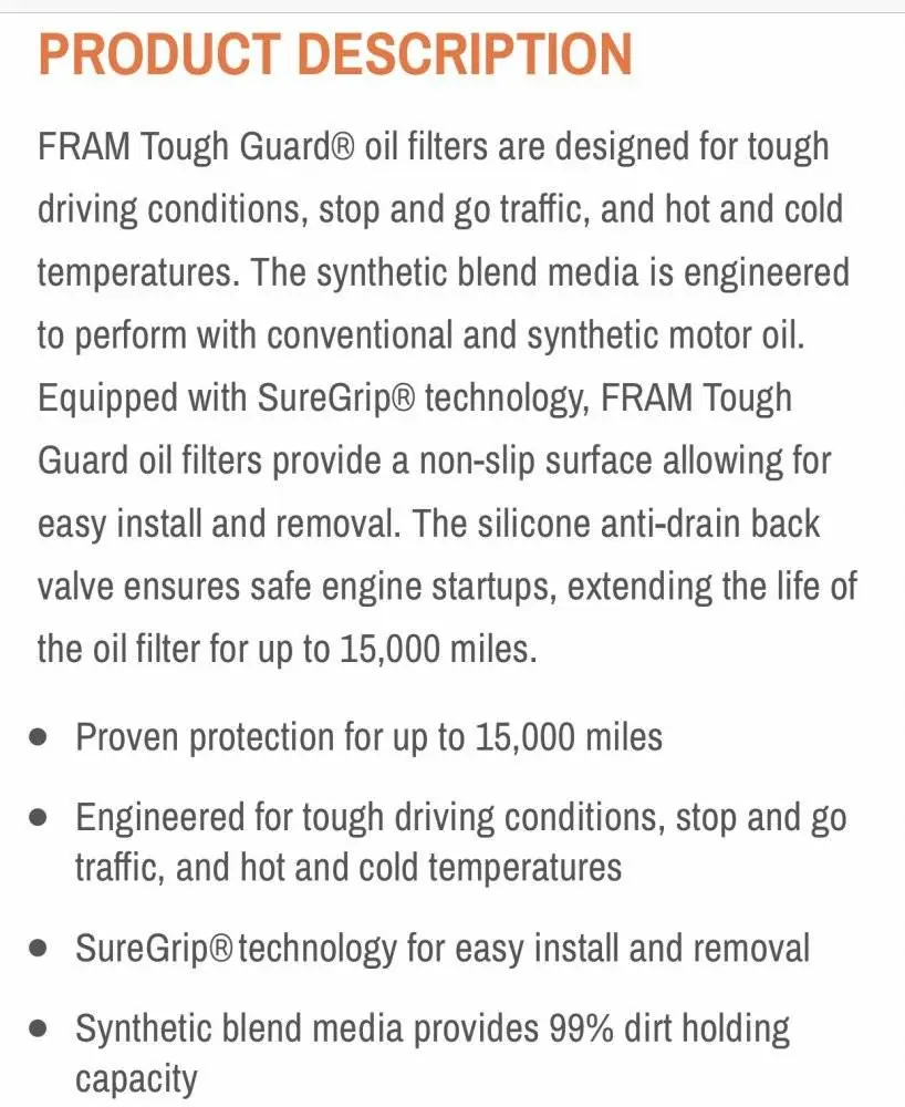

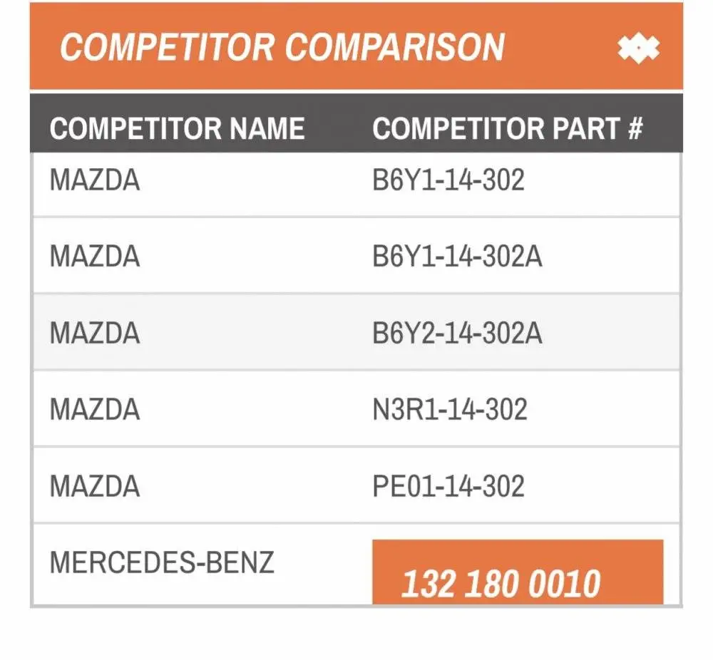

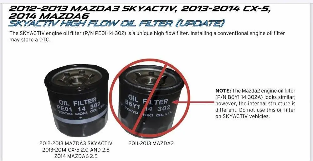

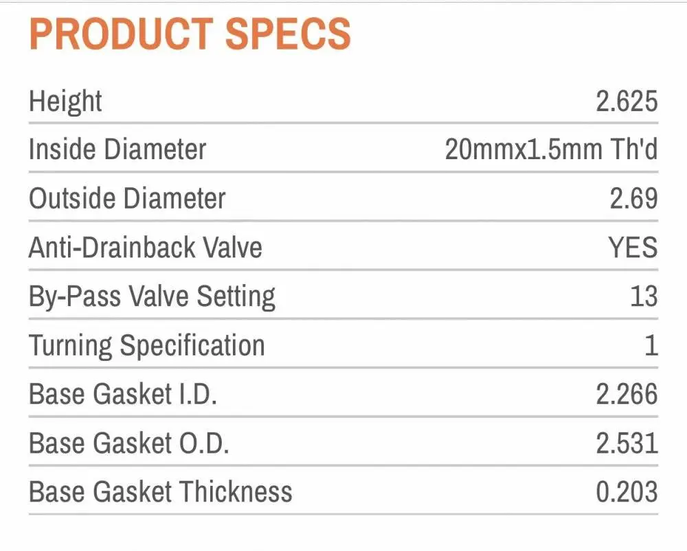

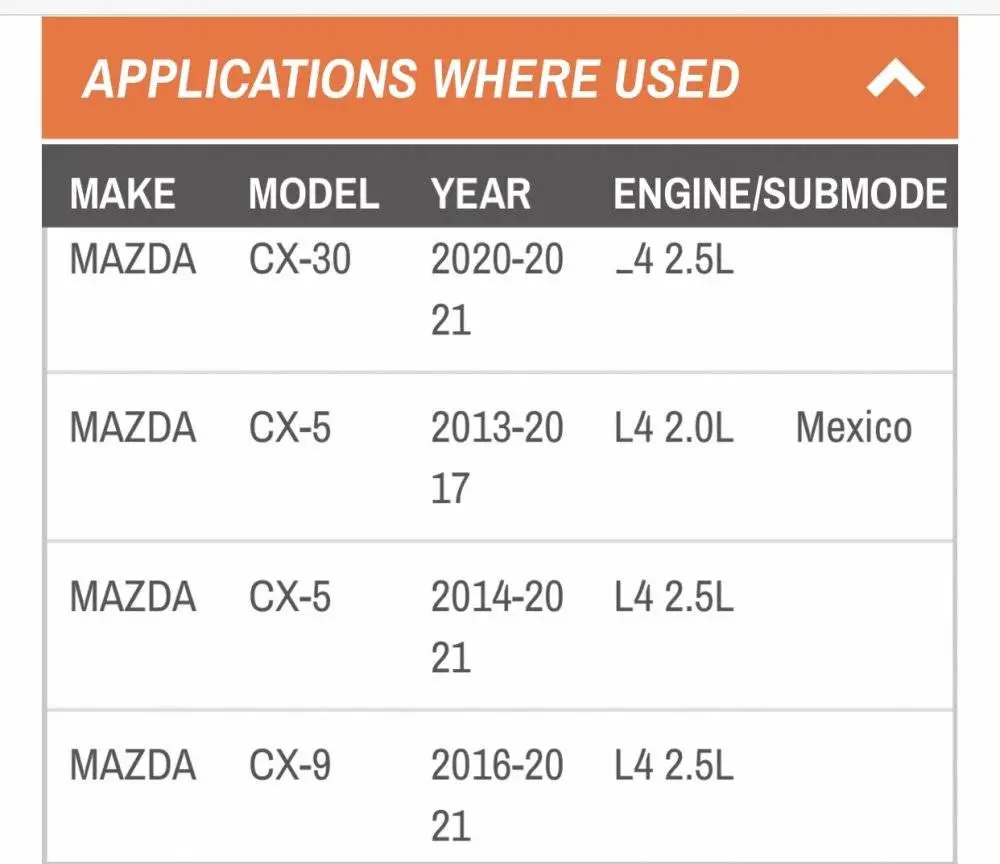

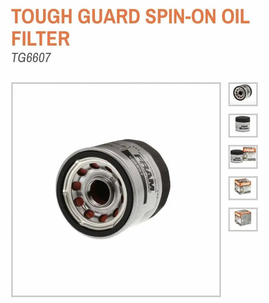

Based on Fram application chart Mazda CX-9 with SkyActiv-G 2.5T uses Fram Tough Guard TG6607. And TG6607 is said to be used by almost all Mazda engines including R2 1.3L rotary engine. Fram claims TG6607 oil filter is compatible with Mazda’s OEM B6Y1-14-302、B6Y1-14-302A、 B6Y2-14-302A、N3R1-14-302、PE01-14-302 oil filters. Notice that the compatibility list doesn’t include any of the 2 OEM oil filters used by the 2.5T. B6Y1-14-302 is an old OEM oil filter used on early Mazda2’s 1.5L mentioned in this Mazda document and it isn’t supposed to be used by any SkyActiv-G engines.
Further, Fram TG6607 is also used by 120+ of different engines from Chevrolet to Toyota. This’s a “one-size-fit-all” oil filter which is very common practice by aftermarket parts manufactures. There’s no way the specs of Fram TG6607 will meet the OEM PY8W-14-302 / 1WPY-14-302 oil filter, and the price difference between OEM 1WPY-14-302 ($6.16 online; $8.93 MSRP) and Fram Tough Guard TG6607 ($6.82 Amazon) is almost nothing. The choice is clear.
