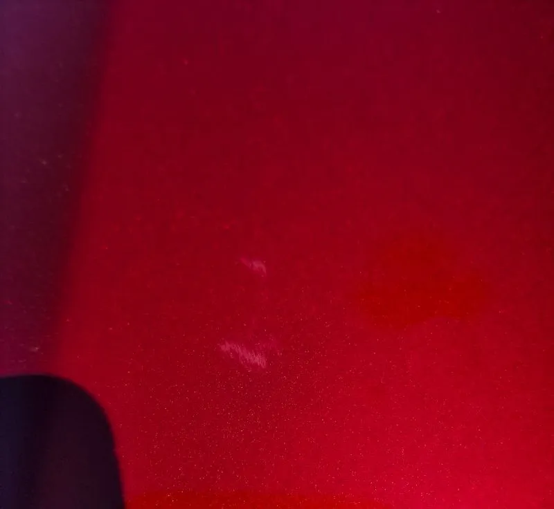

I have a 4-week old CX-5 GT-R in Soul Red and last weekend, it took 3 hits from rocks in about 5 minutes. Two are pin head sized chips that I didn't bother to take pictures of, but the chip looks light gray so the paint may be entirely missing. The biggest hit happened at an oblique angle and looks like it may have only damaged the dealer applied ceramic coat or possibly the clearcoat as well.
I have attached a pic of the latter. There are two close spots of damage, the larger about a centimeter long.
I know the pin head chips are impossible to fix, maybe a spot treatment of CarPro Essence+?
The surface damage pictured here, I have no idea what to do. Is this where a clay bar would help? I am new to all of these new car products and techniques. I already have the Essence+ in my stash of new car care products, but not a clay bar.

Jim,
Try Scratch Removal. It costs about $10 per bottle at AutoZone.
If the damage is only at clearcoat level, you might be able to buff it out.

Thanks, Ceric. Sounds like a plan. Should I then all the Essence+ nano coating on top if the buffing works?
I'd contact a local professional detailer before trying anything. I'm sure most would be willing to look at the picture and suggest something based on what you have available.
Personally, I'd try a polish first, then a rubbing compound if the polish wasn't enough. Then follow with the Essence+ to restore the ceramic coating and add protection.

Thanks for the tip. Do you have a favorite polish you might recommend?

Meguiar's Ultimate Polish (as well as the Ultimate Compound) should work just fine, and is readily available at local stores like Walmart, Autozone and such.

Since no one mentioned it, the clay bar does not serve as rubbing or polishing compound. It removed particles of impurities that get embedded in the paint...you can feel them. The particles are too embedded for a regular washing to dislodge...they actually stick to the clay. It does not polish or buff.
