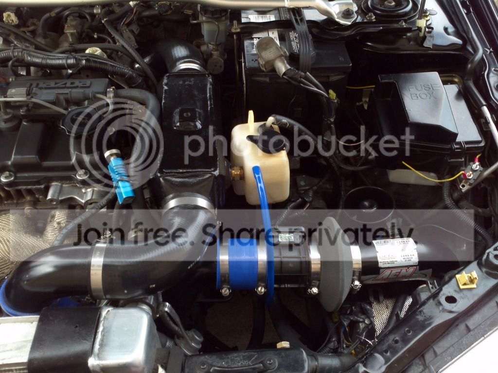

now let me tell you dont follow the instructions they send you as far as just daggling it near the throttle the wire is delicate and looks like will snap after about of week of driving and wiggling. Ill do a small how to later. I have to find some hardware for the thermocouple. I did get some intresting readings while i had it attached to the cold pipe. my temps went up about 1 deg every 45 seconds of stuck in traffic time.
well i ended up drilling a small hole on the side of the intercooler and inserted the thermocouple.
i drilled the whole small enough that the probe barely fit then used a super adhesive to hold and seal the opening.

My temp reading have been 10deg difference from out side temps. when its cool outside it has been 6 deg difference. The intercooler is super efficient. What i cant wait to read is hot pipe temps versus cold side temps.
Wow, if you're only seeing a 10 temperature rise, is is efficient! I'm running the same core as you, but I think I'm running a bigger radiator, now I'm really wondering what my post-intercooler temps are...

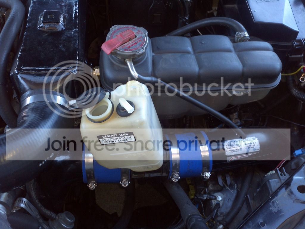

So I have been watching my temps and im going to be swapping my reservoir for a mutch smaller unit. All that extra water just heat soaks when the car is off.

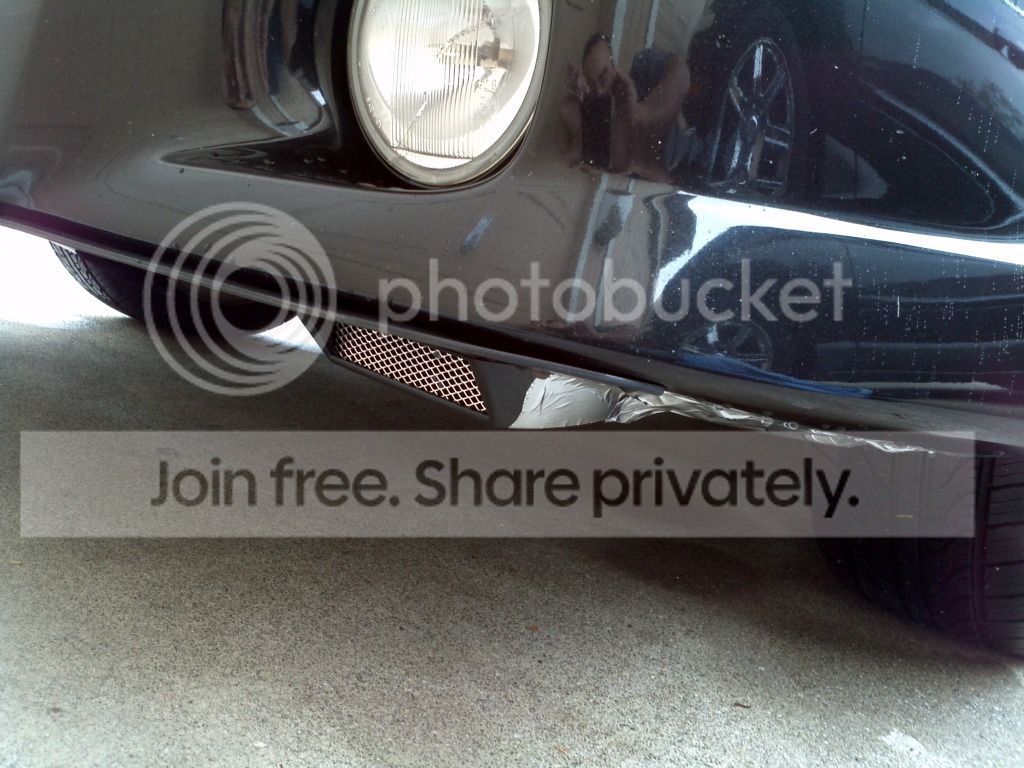

Ive watched my throttle air temp go from 70 to 100 in stand still traffic. Im considering moving the fog lights and creating that ram air system.

trying to figure out in what direction to go to make a Ram air for the cold intake. For now im just going to get a duct to direct more cold air to the filter..
So I swapped out the reservoir. To the smaller unit looks pretty ugly there but the heat soak is super low after driving a while and what ever is present is dropped pretty fast. Also as a plus the air temp is actually running cooler at times as close to ambient by 6 Degrees at times. There is a draw back to having a small reservoir as you boost your air temp climbs a bit quicker but it starts dropping just as fast. ON average Im still about 10 +/- 2 degrees off of ambient after boost.

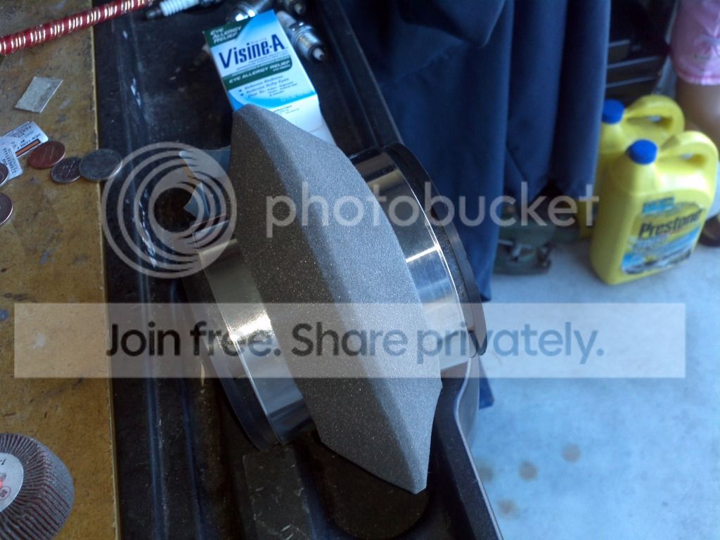

and here is my ram vent. Mind you this is my 1st attempt. I sealed everything i could so it could be air tight but it could be neater.
When it gets warmer ill do a better job..
