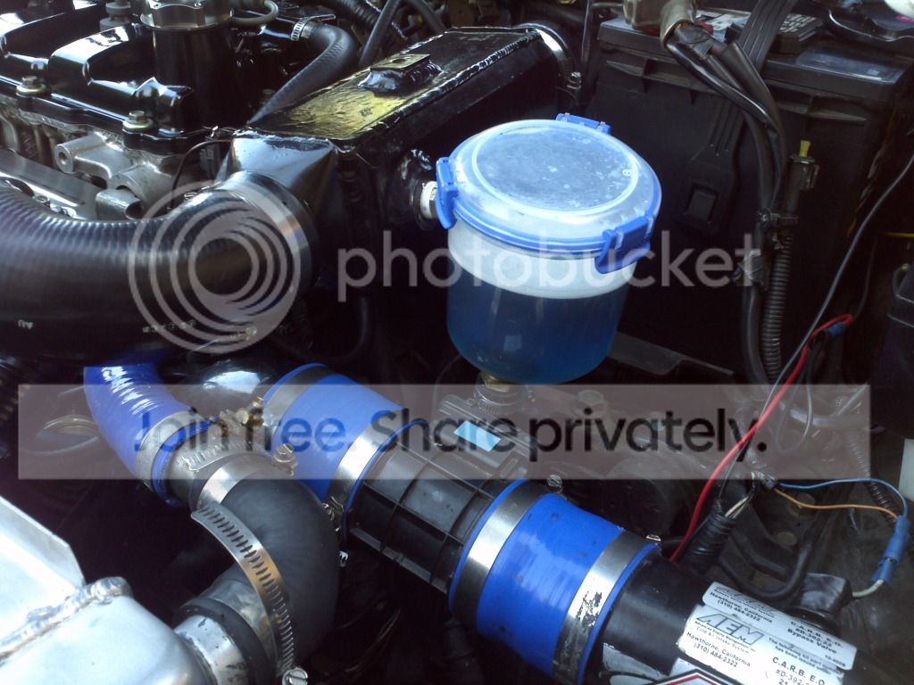

Loving the use of the Lock-N-Lock container for the reservoir.
Here's a picture of my setup in my other car before I made the intake into a CAI, inspired by you guys.
