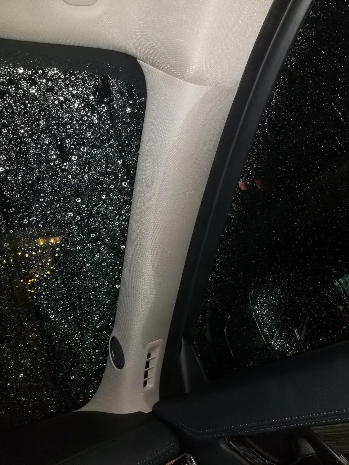

Hey everyone, I have a leased 2018 Mazda CX5 GT that has had a whistling sound from the passenger side door at freeway speeds. I didn't really think much of it, until it snowed in Seattle a few weeks ago and the passenger side A-pillar became wet like shown in the picture. I took it to my dealership after the first time, they said that the sunroof drains were clogged and surprised me with a $96 bill in service fees. Unless the drains get clogged within a week, I'm not sure if they were the main problem. Water is back again on the passenger A-pillar thanks to a nice rain storm that hit this area.
Asking if any other sunroof-equipped CX5/Mazda owners have had this issue, and how to best resolve it without enormous service fees. Would it be reasonable to ask my dealership to examine the car without having to pay again, or am I expecting too much out of a dealership?

Have you changed the windshield at any time?
The whistling noise ususlly is due to bad seal after windshield replacement or a bad seal on the door (unlikely).
you can remove the A pillar for a while (its easy) and see where the leak comes from. The drain pipe is also visible and can be checked.

Nothing has been done to the car since I received it new, other than regular maintenance. I'll have to do that, thanks!

Have you closely inspected the door seals in this area? Can you tell where the whistling is coming from exactly? Take a close look at the seals on the sunroof as well.

I'll definitely go back and inspect it again, but I have cleaned the door seals and nothing appears to be ripped or out of place. The wind noise happens around from window seal so I tried cleaning the plastic portion where the top of the window meets the door frame, but no luck. Perhaps the door isn't fitting properly, not completely sure.

Maybe remove the A pillar and see what's behind it. It's a 5 min job.
Be carefull not to mess around with the airbag thats rolled behind. You can disconnect car battery if you want.
The upper side connector clip that holds it from flying away can be removed without cutting and can be reused.
