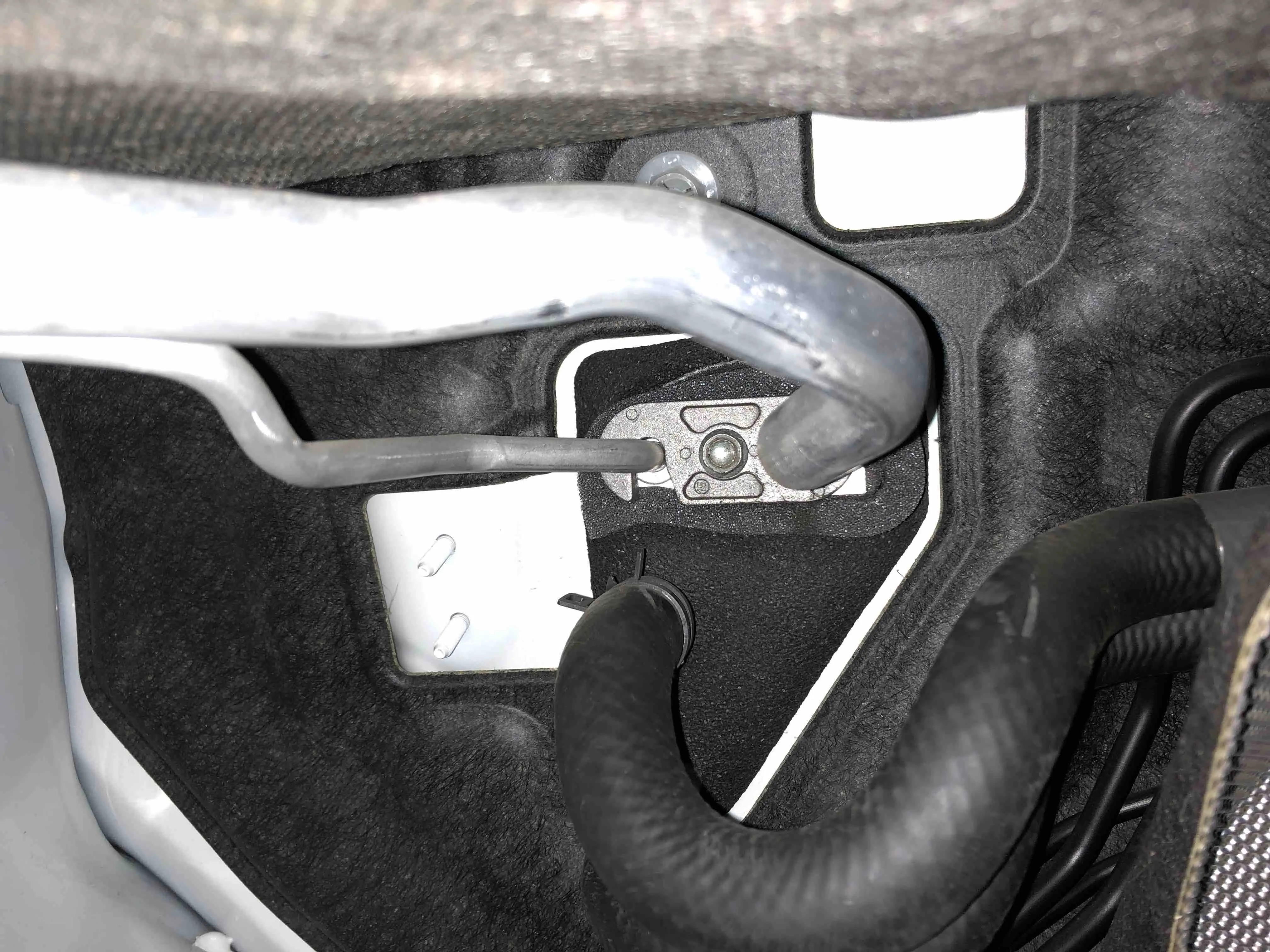

Pic of the outside firewall where the hoses come into the cabin, I saw some foam padding around a/c lines, but I can't compare or remember if that was there before. Can you take a pic of your 17 Cx5 so we can compare. Im assuming thats the foam that was added around a/c line behind the bracket.

I'm posting this in case someone gets this issue too. I was hinted that other vehicles existed with same issue around the country (US) with same issue and looks like they found a solution. Im not sure if a TSB will be issued or its just hand full with the problem. With mine they where trying to find the cause. It took 25 days in shop. Everything from taking dash apart to adjusting and re-torqing engine mounts and more. It sounded like an engine mount gone bad but they where good. All it was is the heater hose bracket vibrating into firewall under engine load when engine vibrates a bit more. I could feel it in brake pedal because its attached to fire wall as well.
