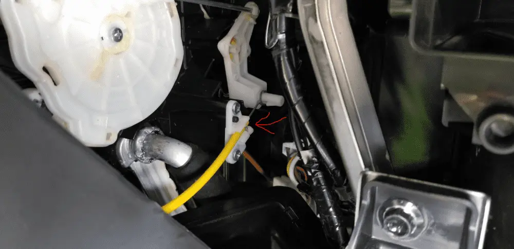

I had a similar issue with my 2013 CX-5. What I found is the small metal e-clip holding the fan mode select switch cable in place had come out of its plastic retainer. When you drop the glove box this cable is easily accessible. Make sure that tiny metal e-clip is snapped firmly in place into the slot on the plastic retainer. I marked it with a red arrow.
