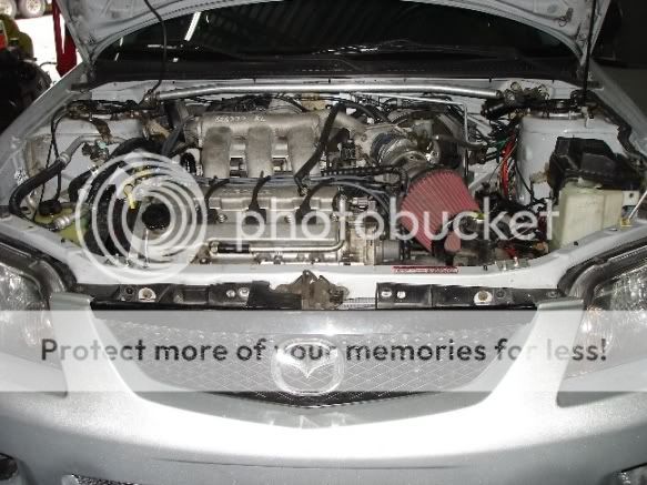

There is a pics of V6 Protege in Quebec...
1st: mine. i run 7000 km and many track day this summer.

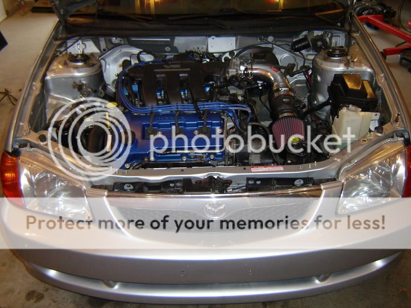

2nd: my second swap for a friend. originaly is a 1.6 2000. note the mod long neck intake and Injen air intake...

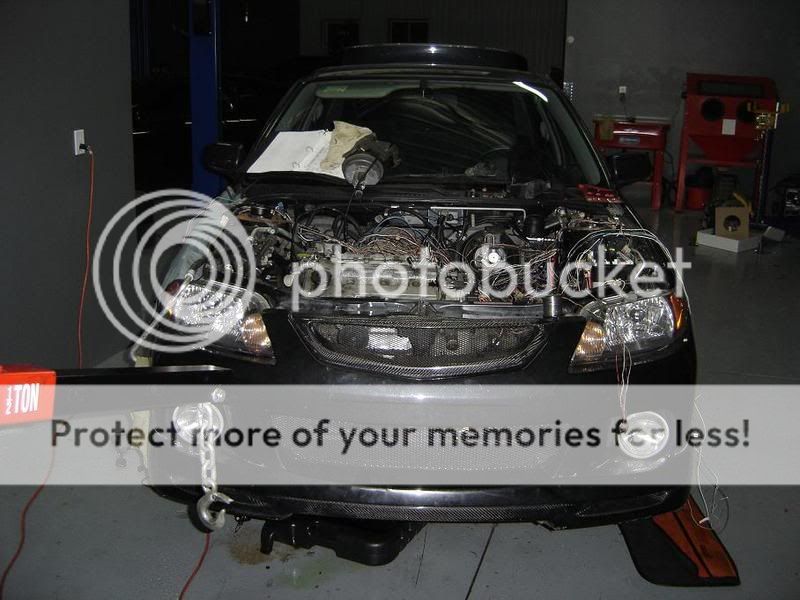

3:i have to work on wiring harness of this car to training a guy for made the 4.
