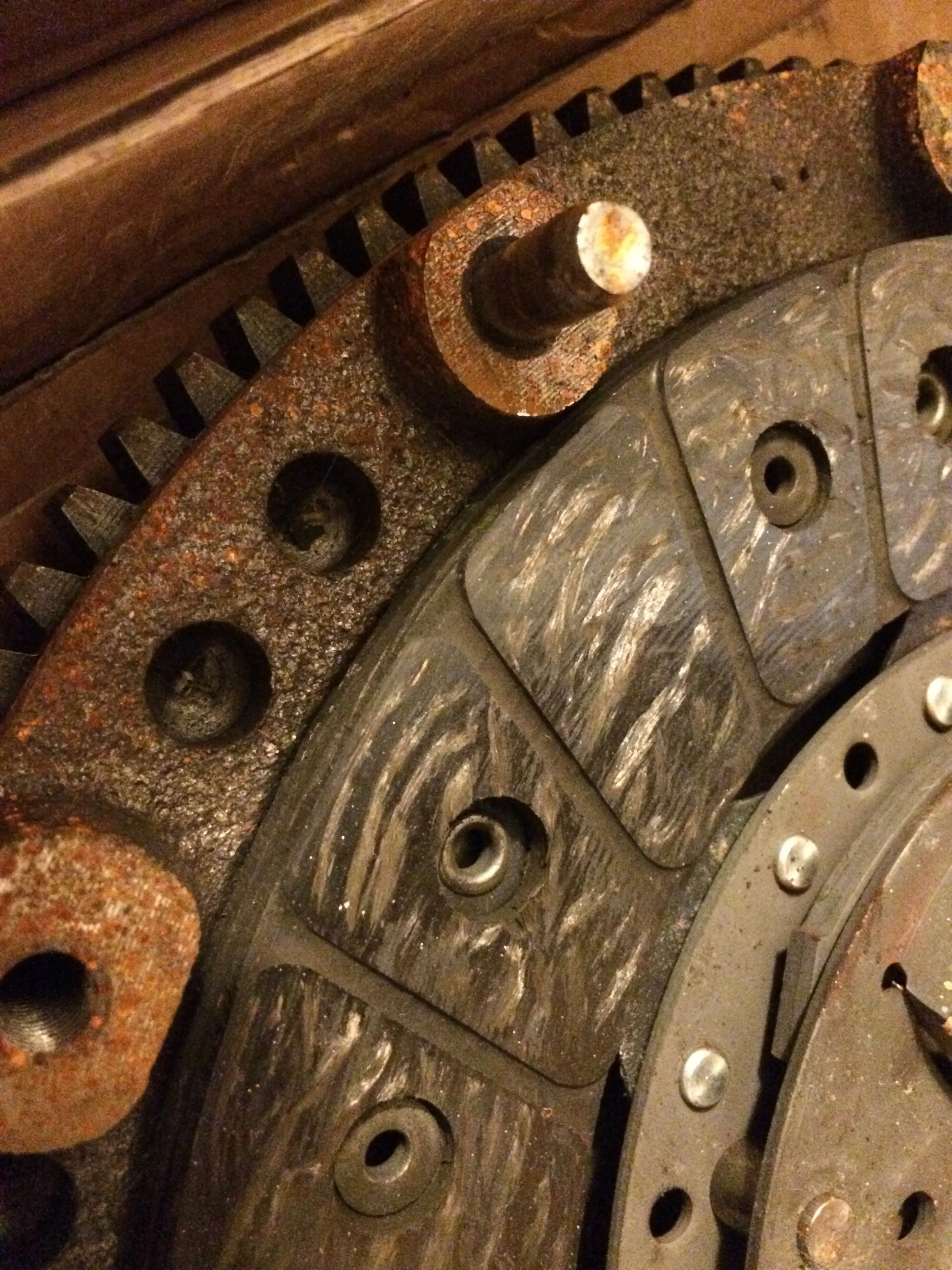

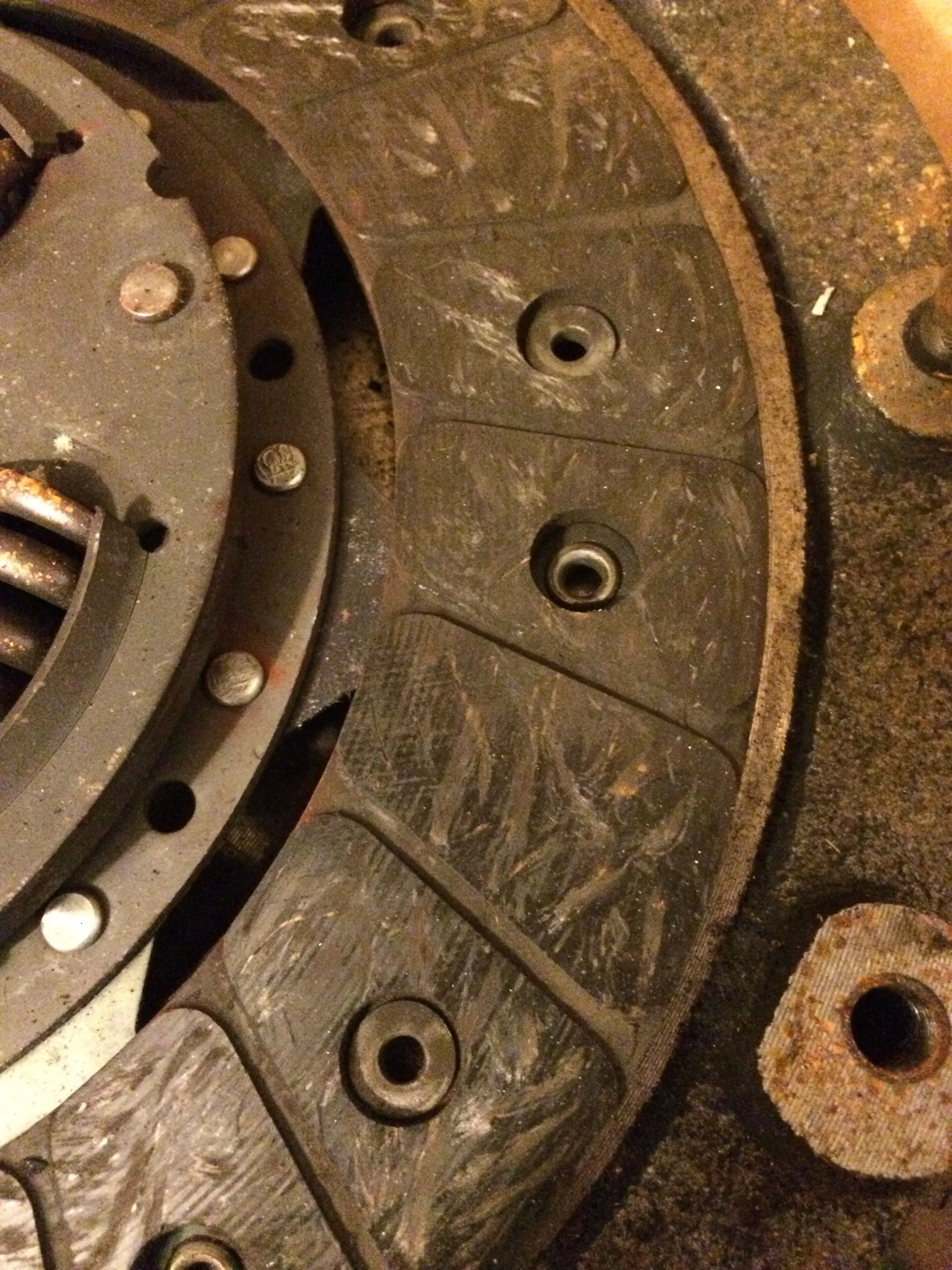

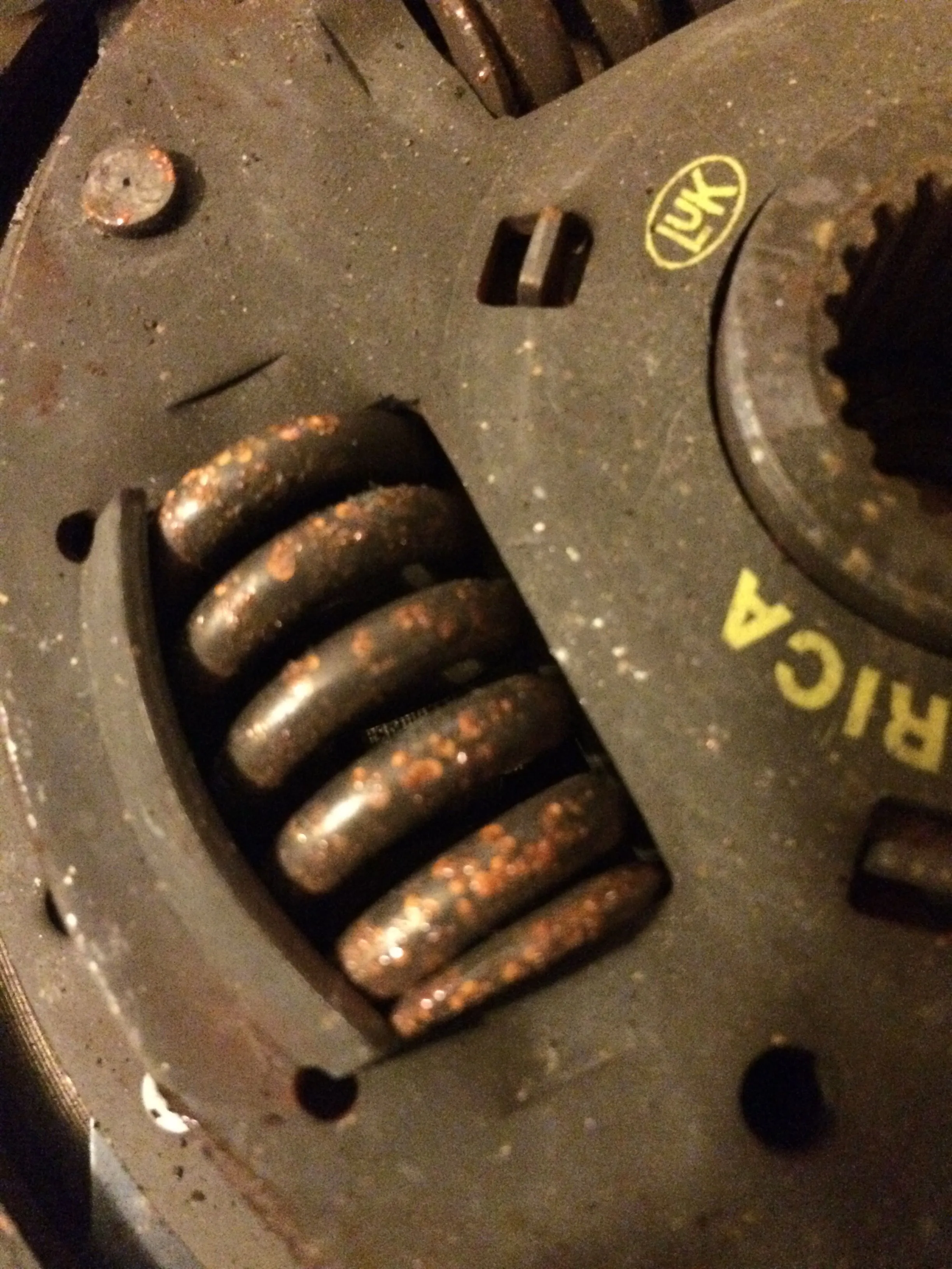

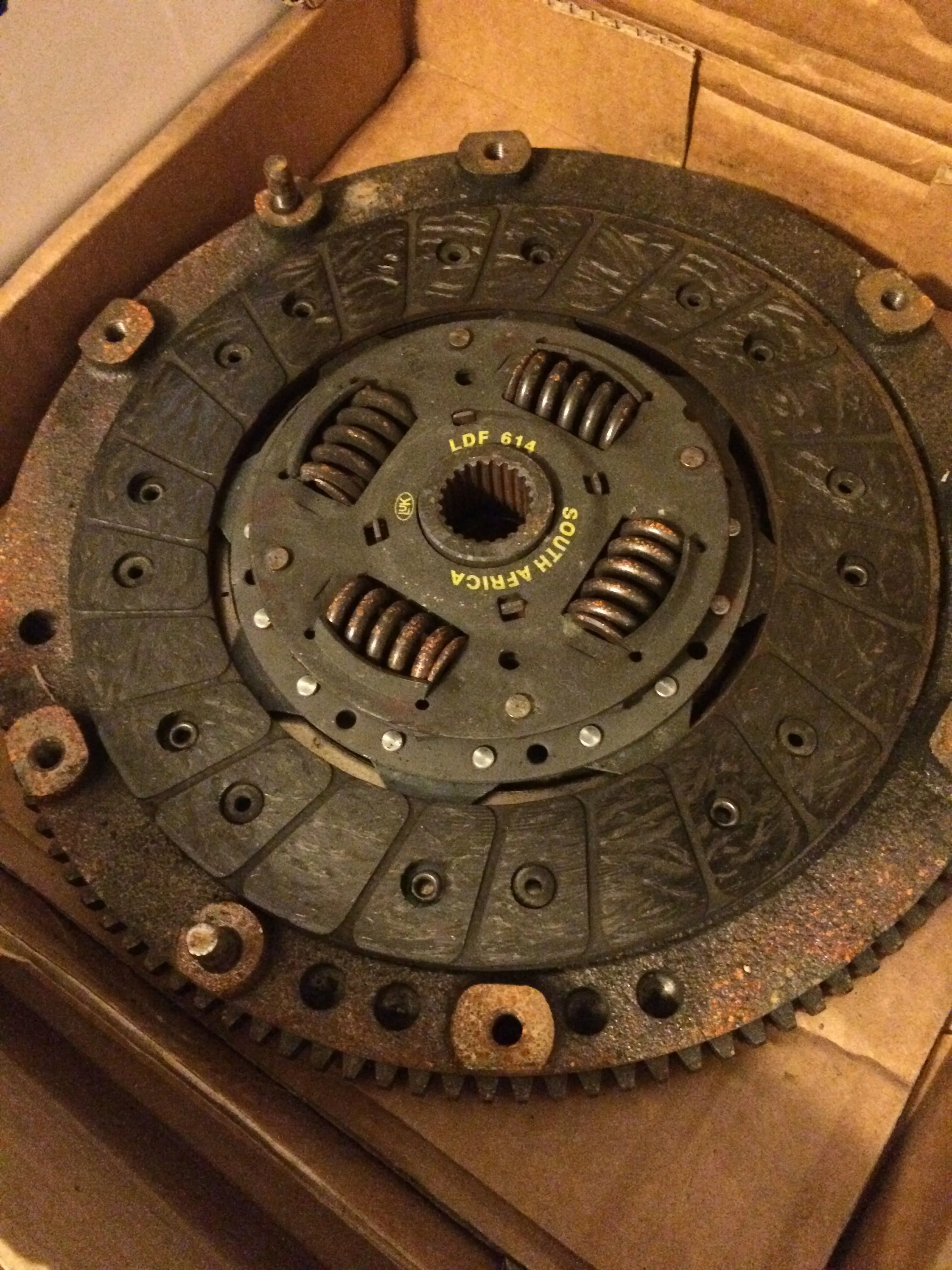

Photos of clutch on flywheel
2015-12-22 08.07.06.webp2015-12-22 08.07.15.webp2015-12-22 08.07.25.webp2015-12-22 08.07.44.webp
your friction disc looks like it's in great shape still. I'd get the flywheel resurfaced since it's out of the car.

Pics of the clutch disc shows plenty of life. Hows the pressure plate and flywheel look though? If they have been overheated, it will show. So post up pics. You can tell just by looking if its goodd. About the only thing you cant see by eye is if anything is warped. but that really shouldnt be an issue.
