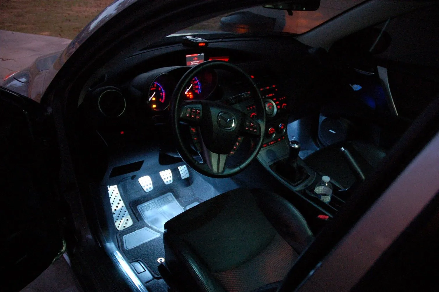

First of all, I rewired the blue floor lights (when you open the door) to come on instead when you turn the headlights on at night (with the rest of the blue ambient lighting). I then used the old wiring for the new LED lights (ordered on eBay) for brighter effect when you open the doors.

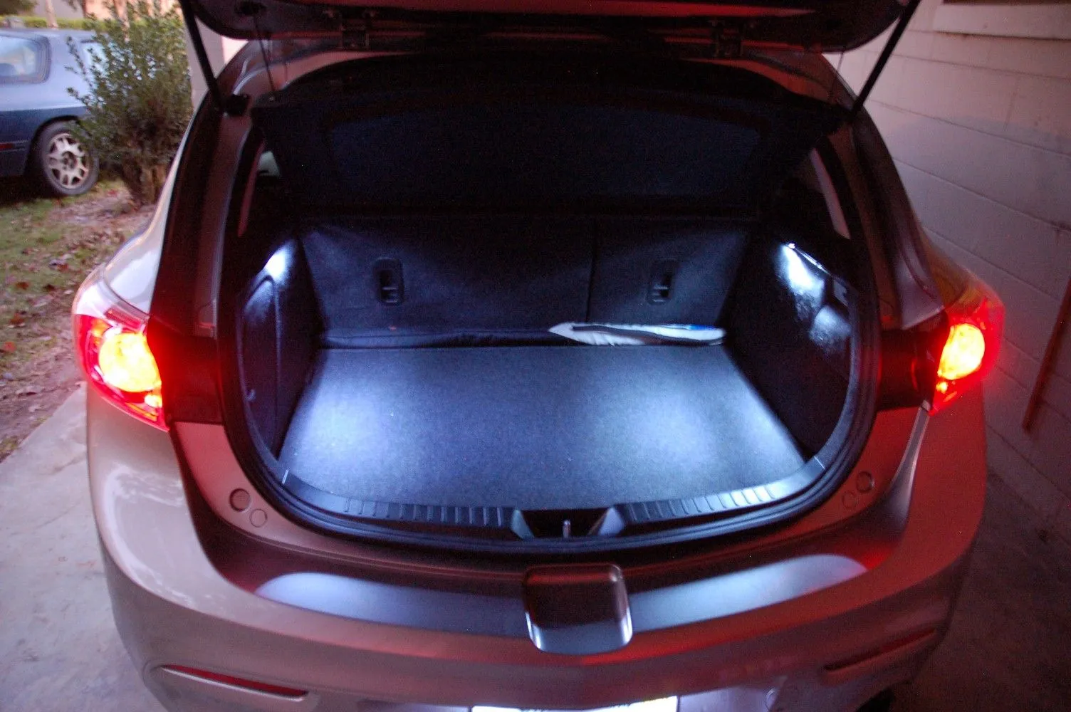

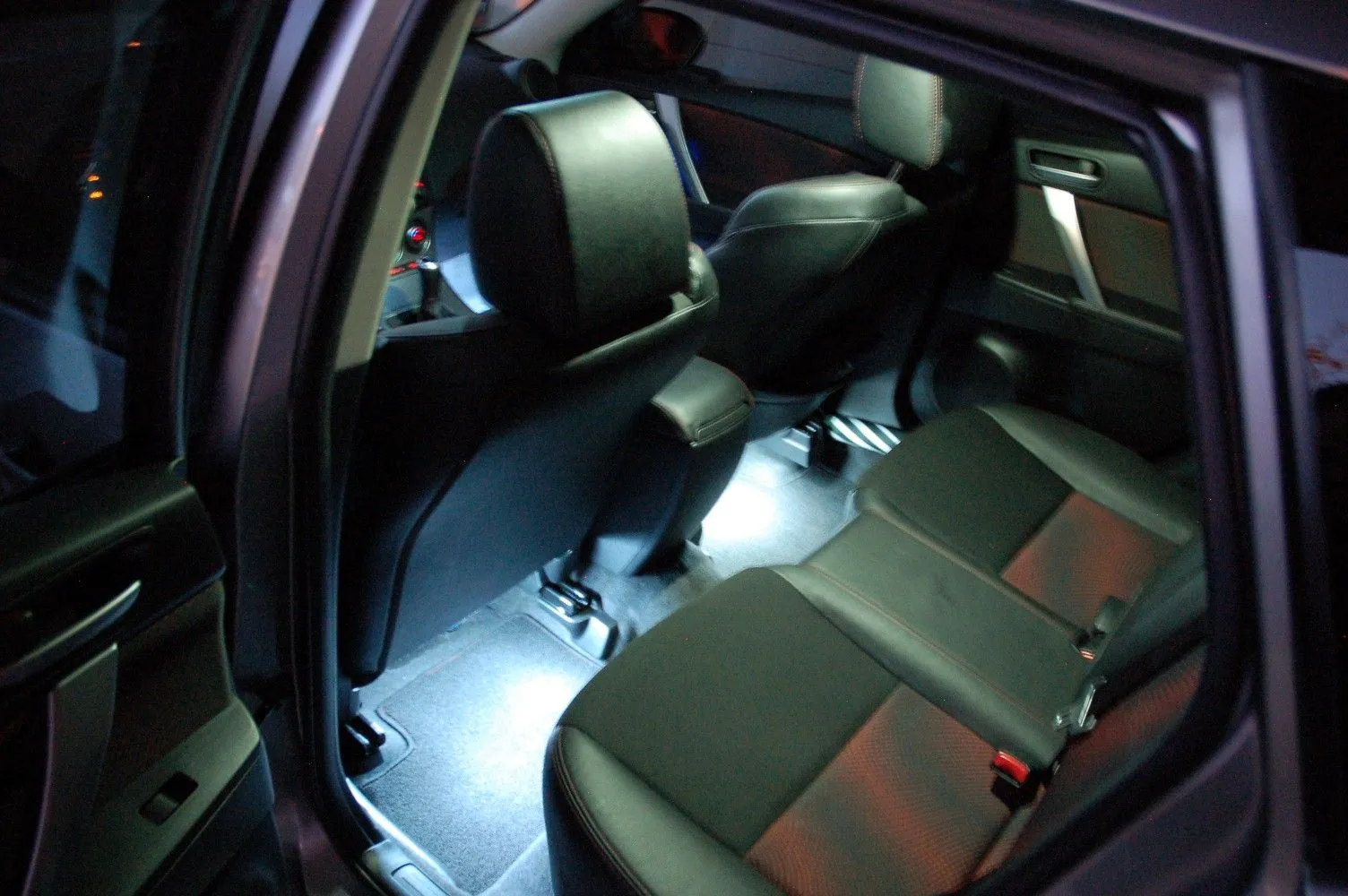

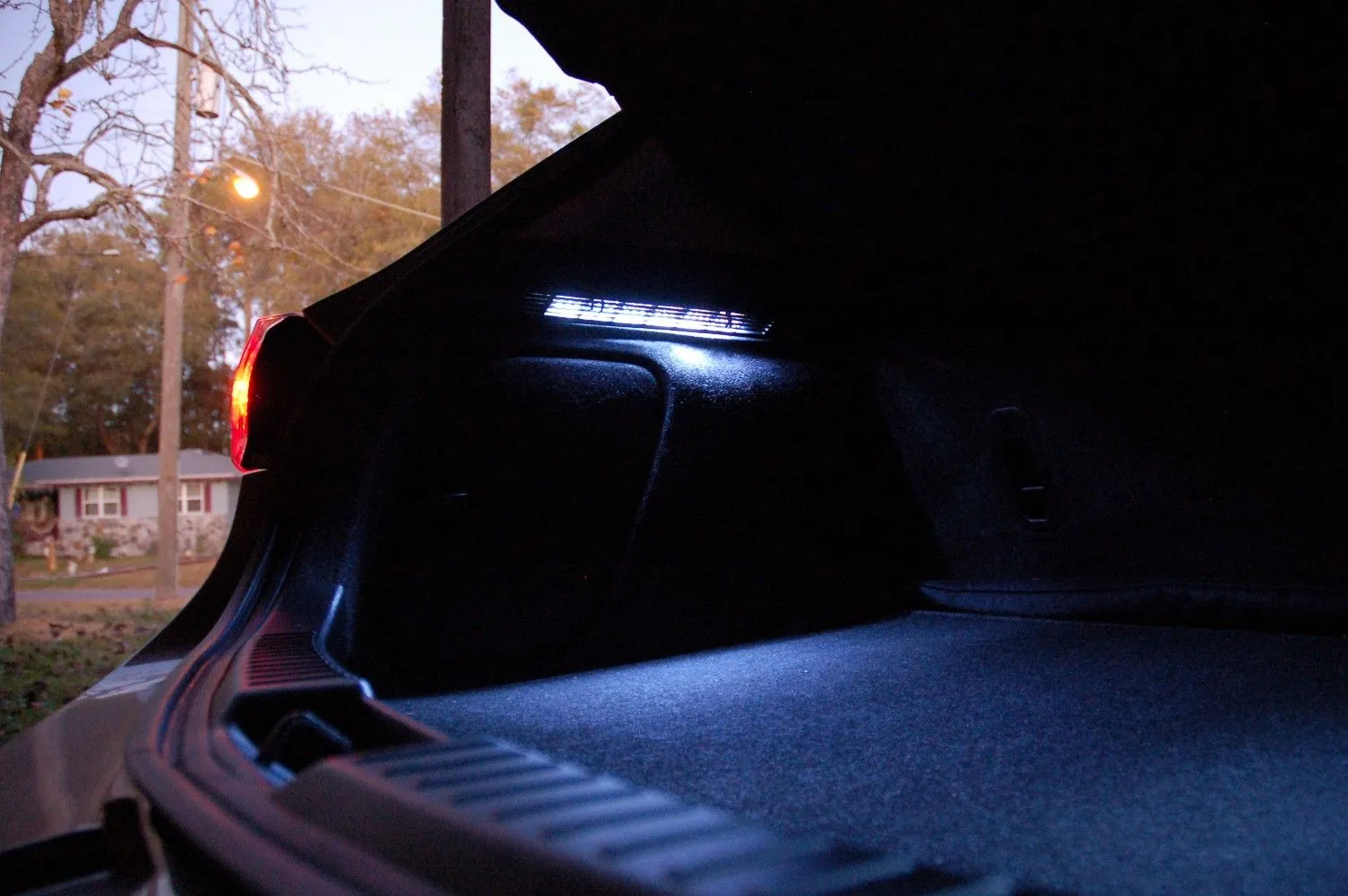

I also wired floor lights to be mounted under the rear of the driver and passenger seat so the back seat's floor glows when the doors open; as well as in the trunk area, there will be illuminated on the right and left instead of the one light.

Took some pictures at night, here is what the cabin and cargo area look like...
