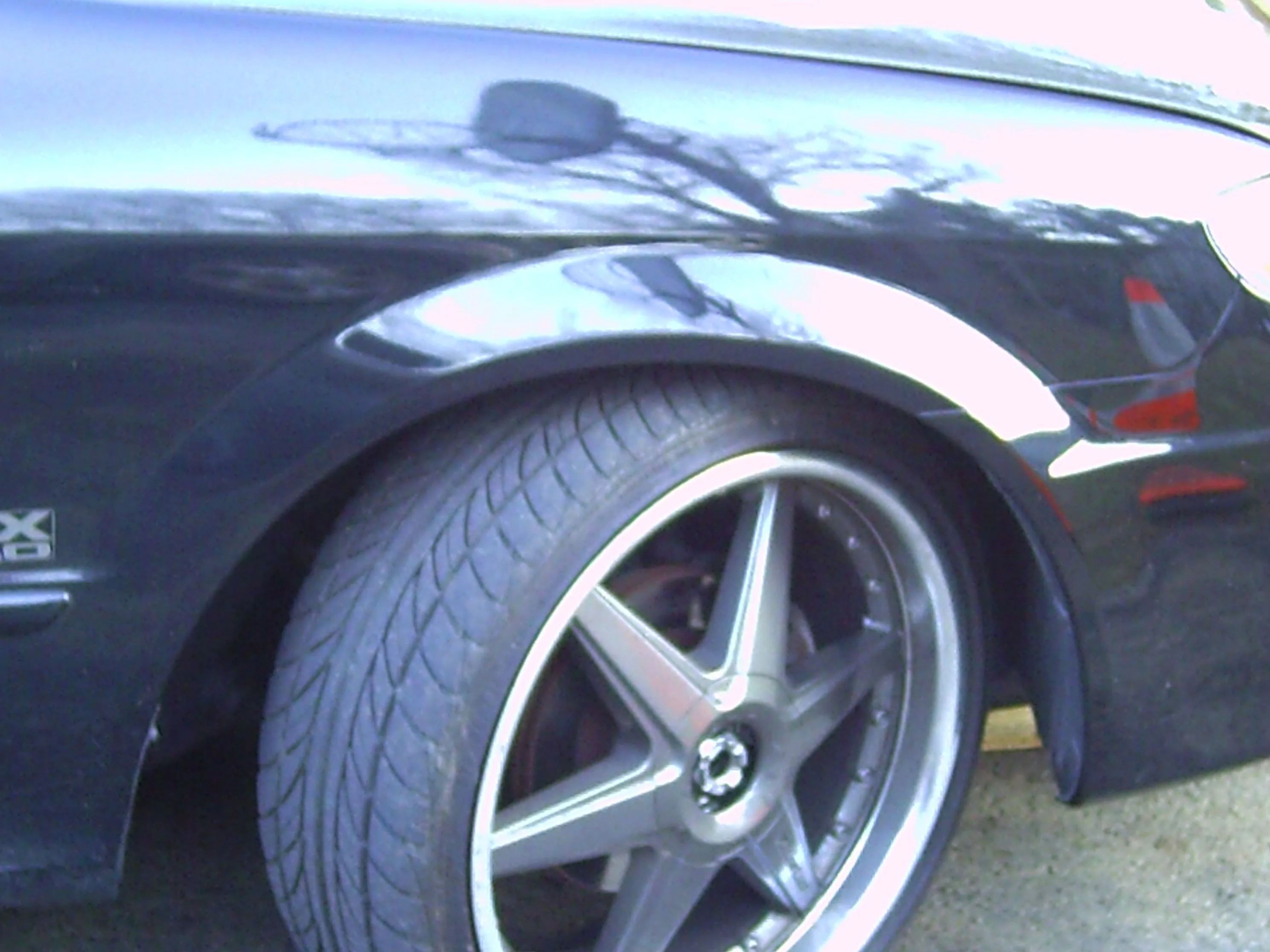

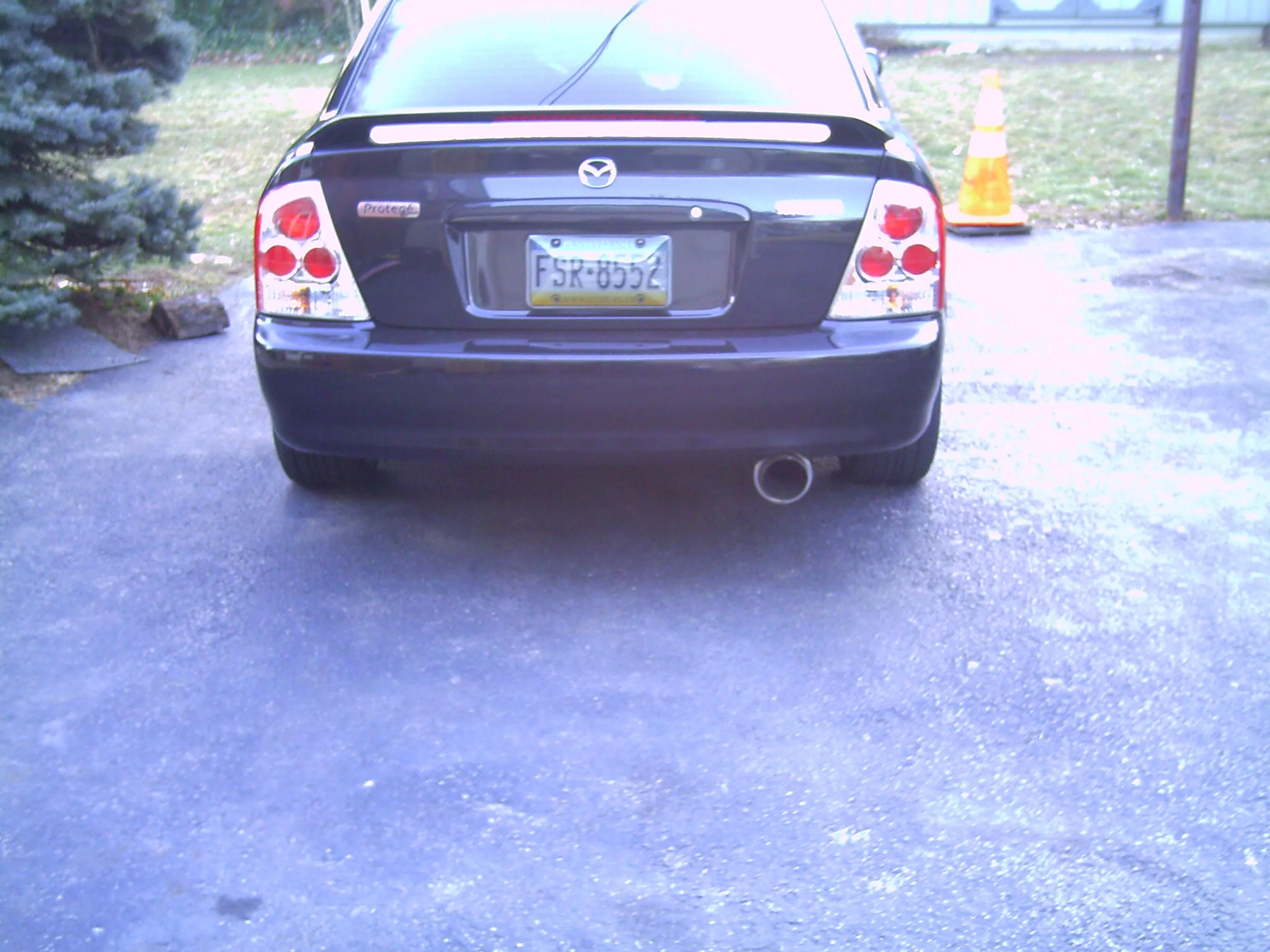

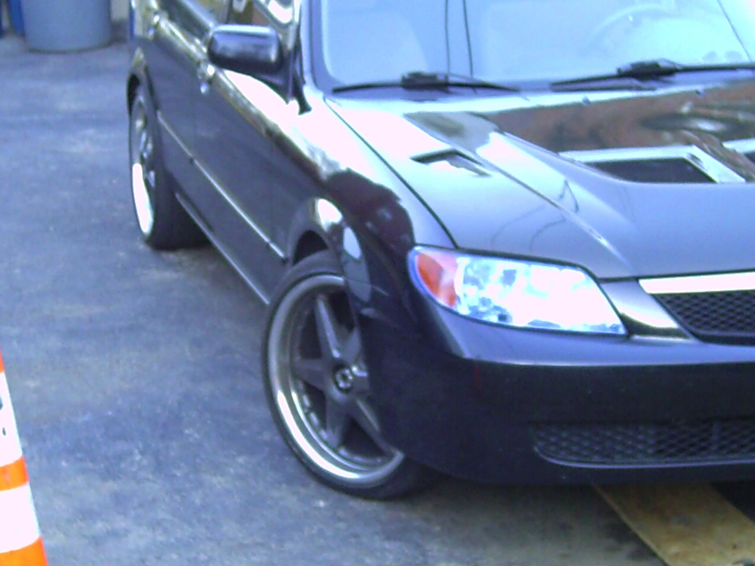

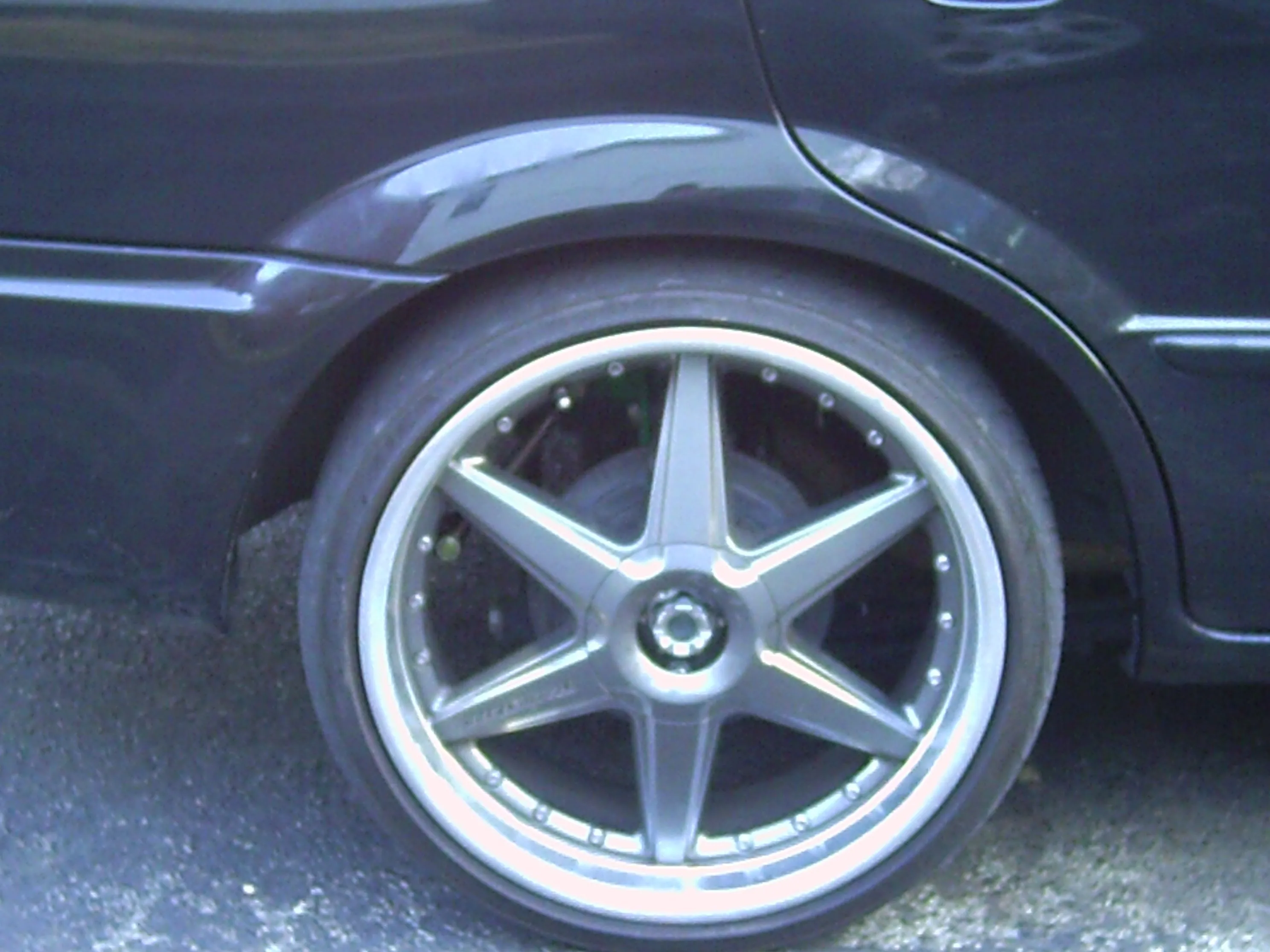

Took a while but I got it done, also wanted to drive it around ... here are some pics... I do plan to go a little lower but I'm getting my fenders rolled by April so I can wait a few weeks..... Also put on an ARW 22mm sway bar with adjustable endlinks... I can really feel the diff when I turn. Felt great on I 95 too.
Thank for all the help
