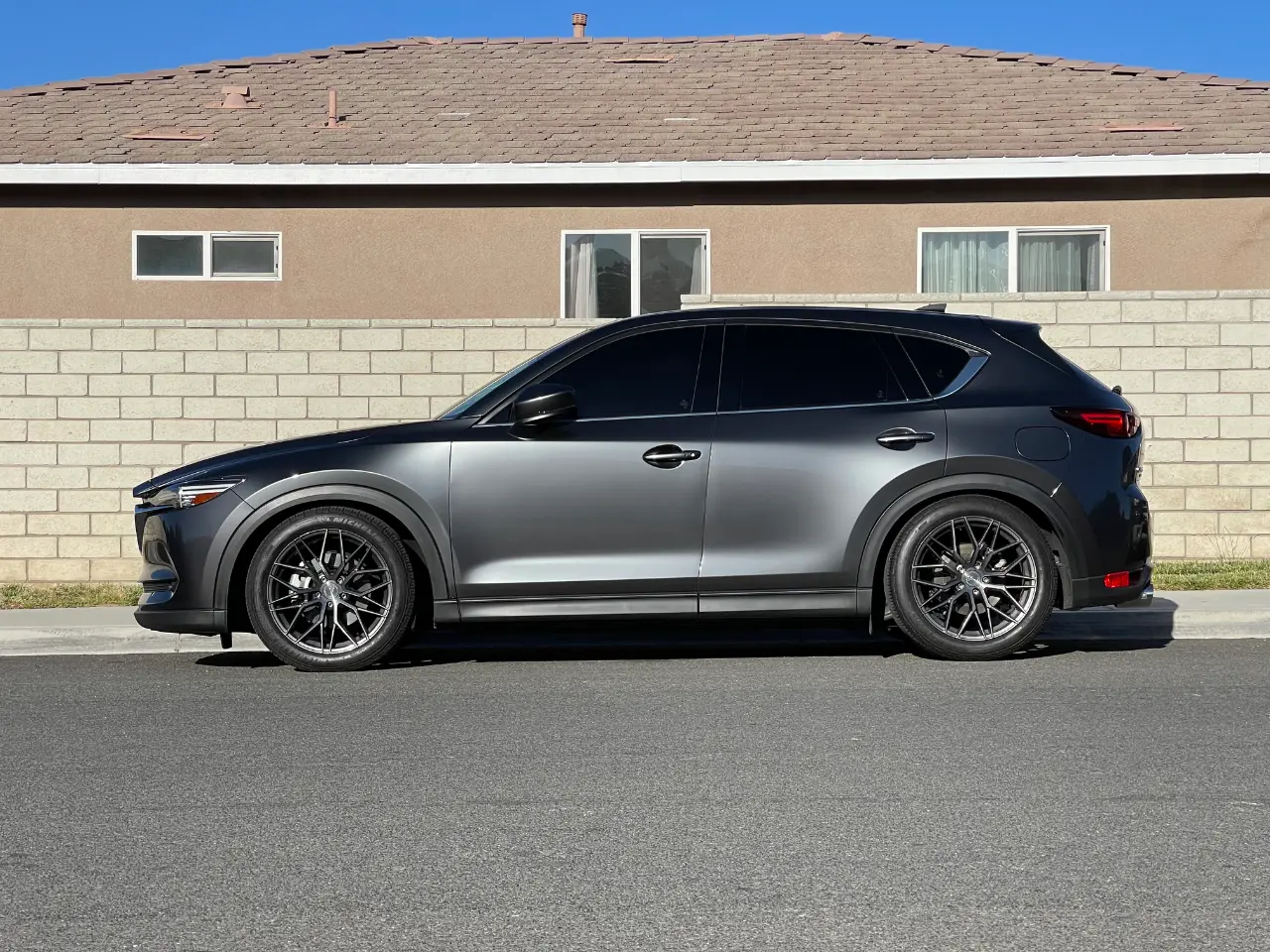

Anyone out there running only coilovers without any upgraded suspension parts? Been lowered on bc racing coilovers for about 4 years now and warranty has replaced both of my front axles. I think I’m gonna go ahead and get the suggested front camber bolts, adjustable rear lower control arms, adjustable rear toe arms, adjustable rear and front endlinks to fix my alignment. I don’t race the car but i go on spirited drives, will those suspension upgrades help with the overall life of the axles?
Look at your cx5 joints, if they are on an angle which I'm sure they are, raise the csr like @PulsarKF suggests.
