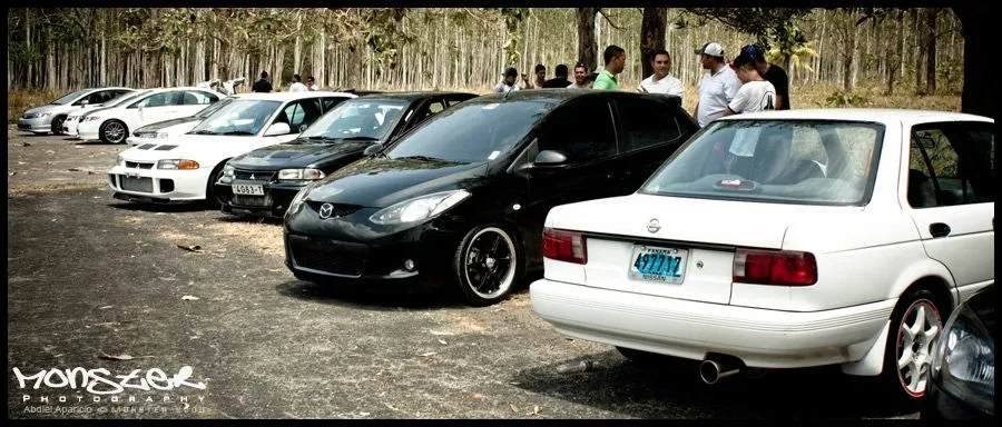

N nito Member : Mazda 2 (Demio DE) Mar 26, 2010 #6 I am currently using 205/40 R17 but in the past I used 205/45 R17. I like both but let me say 205/40 will give you a nice aggressive appearance =D Attachments mg7434.webp 80.7 KB · Views: 628

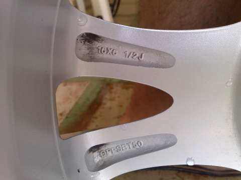

A AN7 Member Contributor : Mazda2 1.5T Sport Nov 14, 2010 #8 Louiise said: & btw whats the offset for our rims? Click to expand... Attachments 26082008841tv9.webp 9.7 KB · Views: 403
