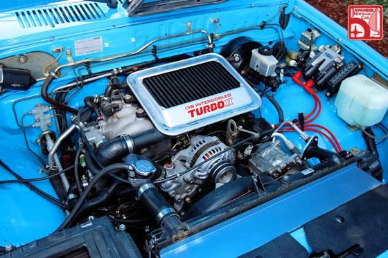

I wonder if there are pictures of the Racingbeat truck that had the 13B in it around. It was running a stock engine I believe.
-Derrick
this?
old school racing beat 1989 Mazda b2200 TII swap
"california cruisin"
god that truck is awesome.Racing beat made some nice,quality rides back in the day

Looks like the pictures from Sevenstock.
The truck is well put together, serious old school there.

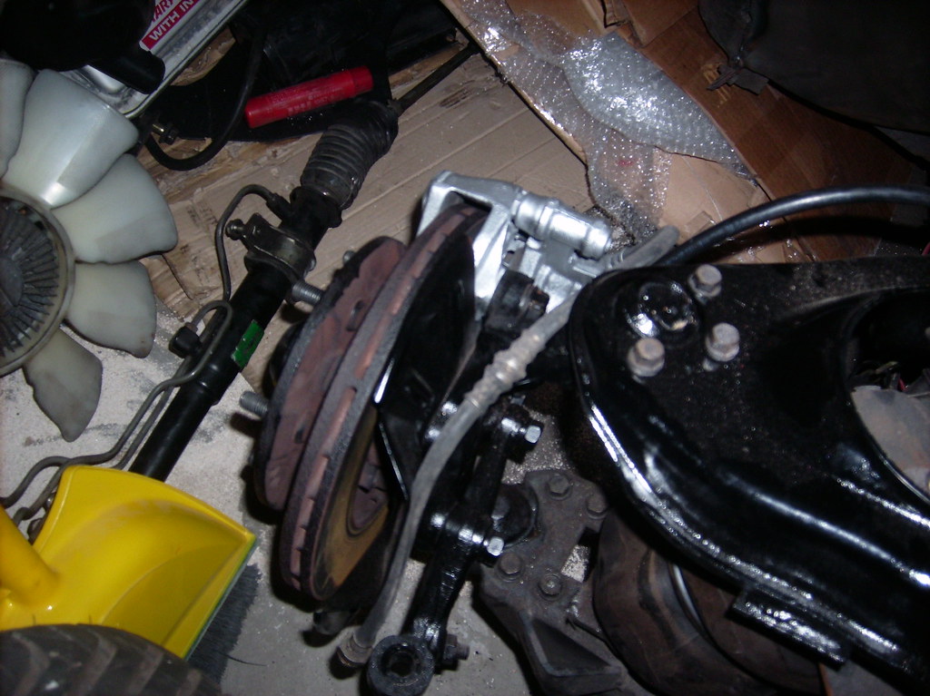

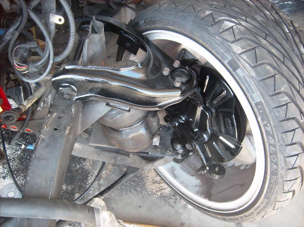

painted my brakes and a arms. just cleaning s*** up. also painted my calipers..

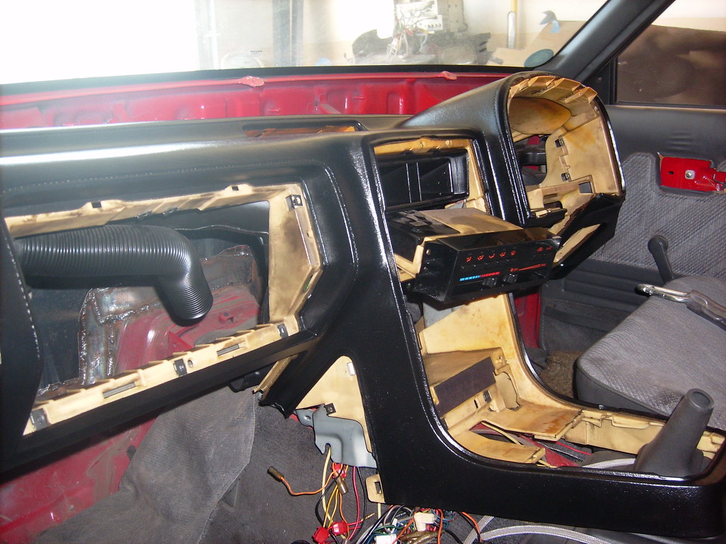

also cleaned up my dash..

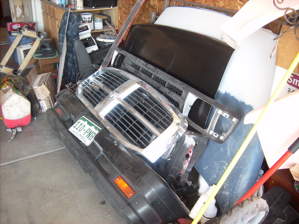

body panels waiting to go on both trucks..

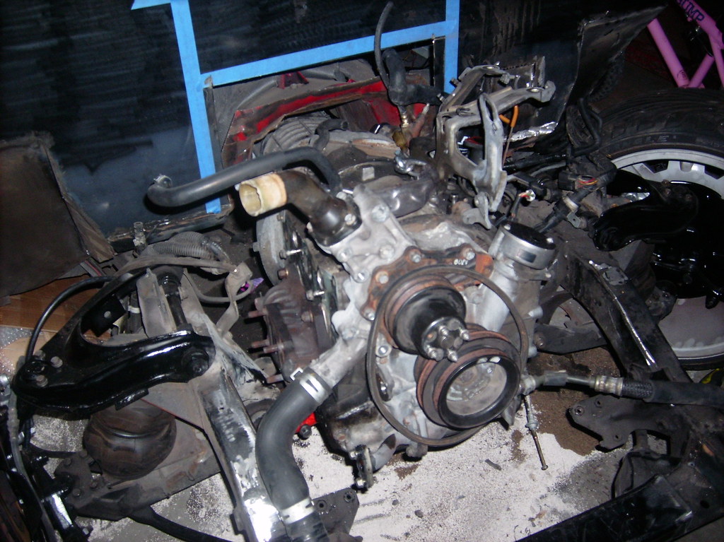

tore the engine down to a bare keg to clean things up plus i was having fitment issues. thought it was the firewall, but it turned out to be the mounts.

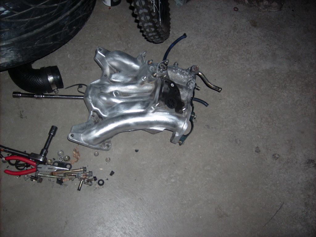

anyway, started polishing my IM...

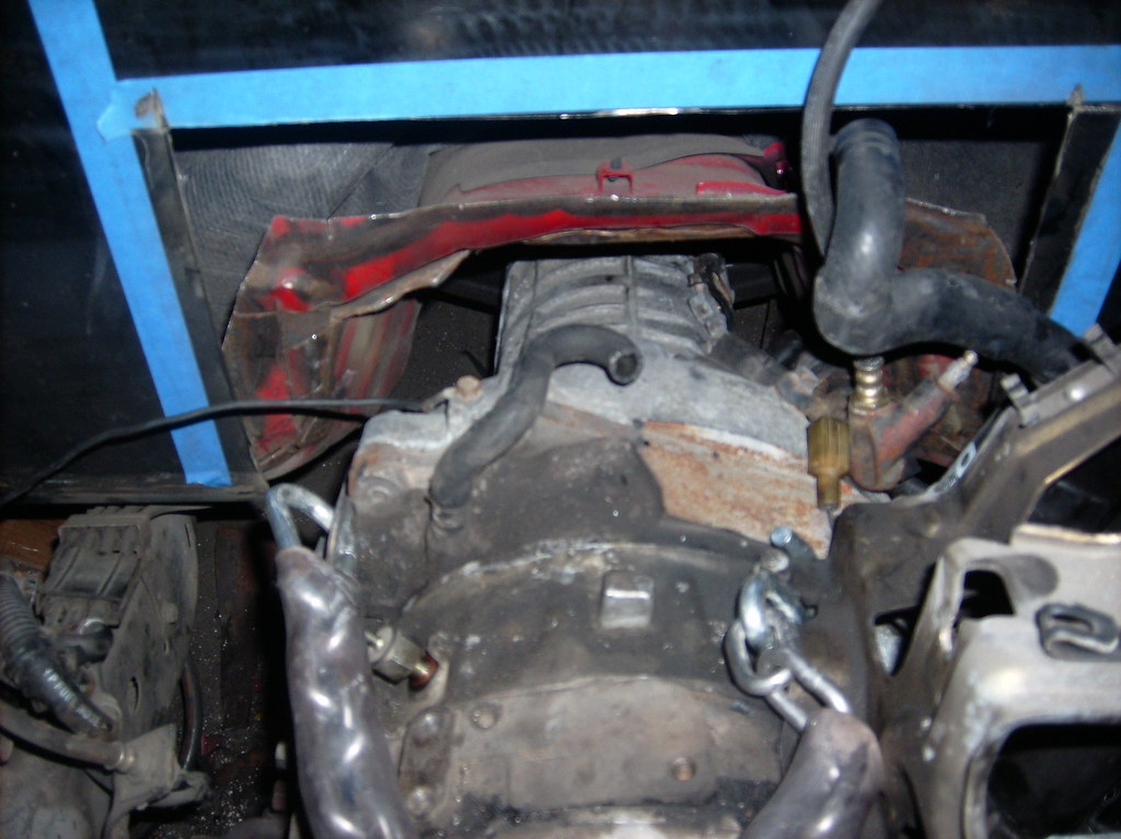

so like i said had some fitment issues so i cut out the firewall since thats what i thought the problem was, but turns out it is the mounts. so i brought the engine forward an inch or so but now i am having issues with the engine being true to the frame and being womperjod in the engine compartment, so i have to work on that now. also, then engine sits too low, so i might be rebuilding a tranny tunnel after all..
this is how i ended up mounting it for now til i can weld up new brackets. the mounts were designed to fit between the old crossmember mounts, but dont, so i will have to make new mounting points for the moints and possibly new mounts..
