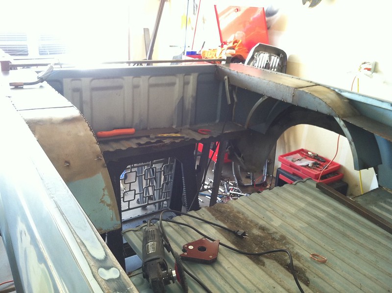

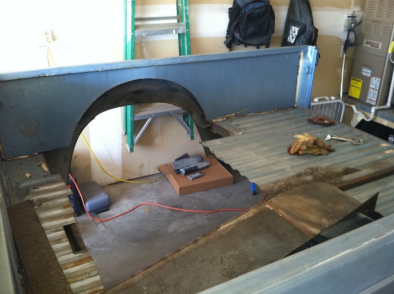

so i wanted to start working on sheeting in my new bed and getting it ready for primer and such, so i made sure i still knew how to weld, and cut out the existing usable stuff from the broken bed and started putting together my new bed.
i must say how much better i get at fabrication every year and this bed floor and other things i build this summer are going to be better thought out and super sick!
heres what i started with on the old bed
all cut out. this bed is pretty much just trash now. will be going to the scra yard for beer money!

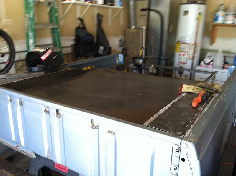

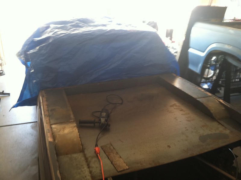

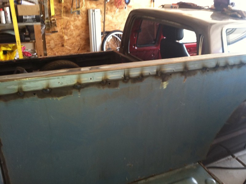

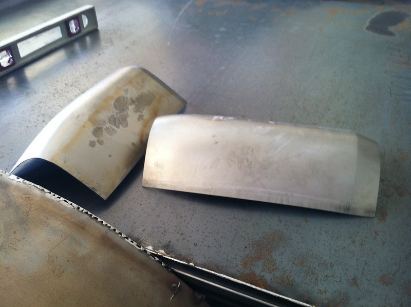

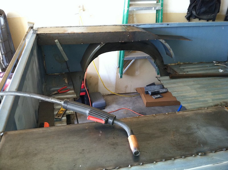

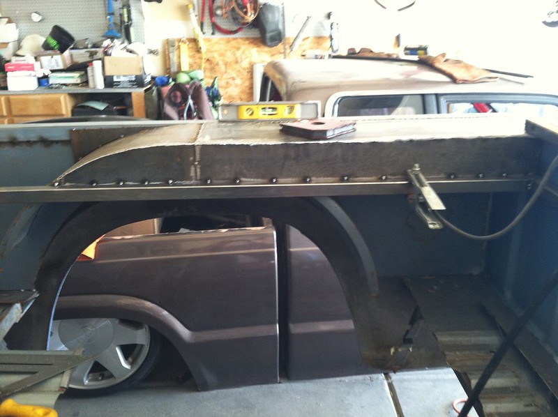

i had gotten these sheetmetal side filler pieces for free and so i decided i was going to use them for extra strength and to give me something more to weld to on the bedsides...
they will need some trimming to fit my wheels, but this gives a good idea for now...

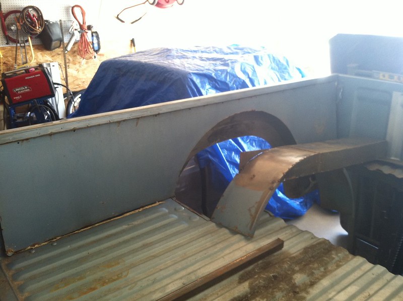

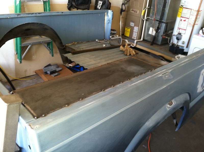

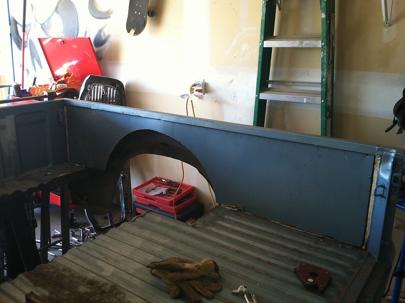

will be keeping the majority of the stock bedfloor, but will have to raise it a bit for the bodydrop. my last bed lacked a lot of structural support thus the reason for the stock floor to stay...
the messy garage was bothering me. i got a shed for a reason...

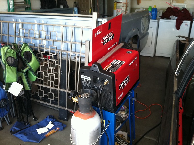

my welder was giving me fits. i was really out of practice, and forgot how to fine tune. but i got it figured out using the side sheet as practice lol.

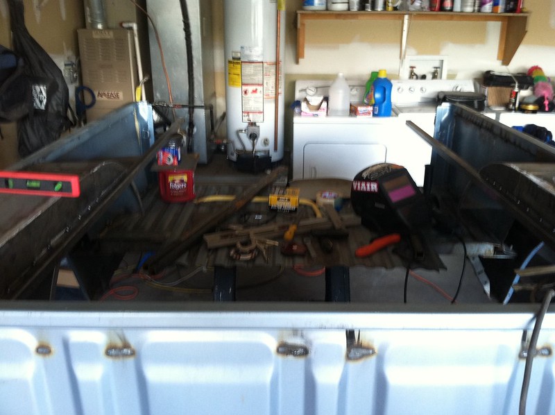

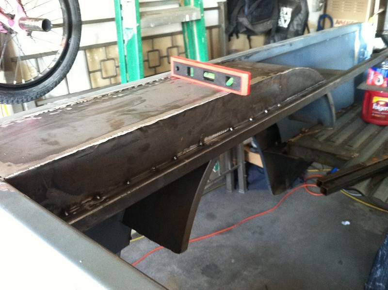

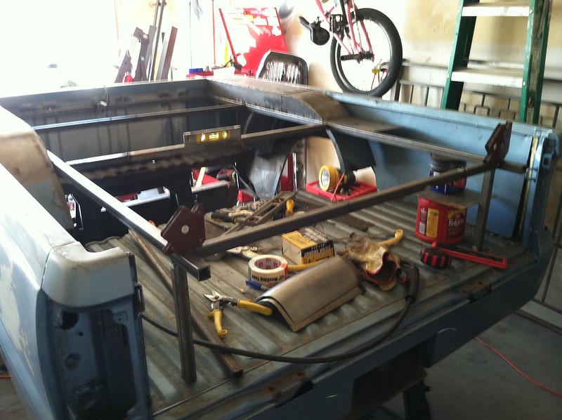

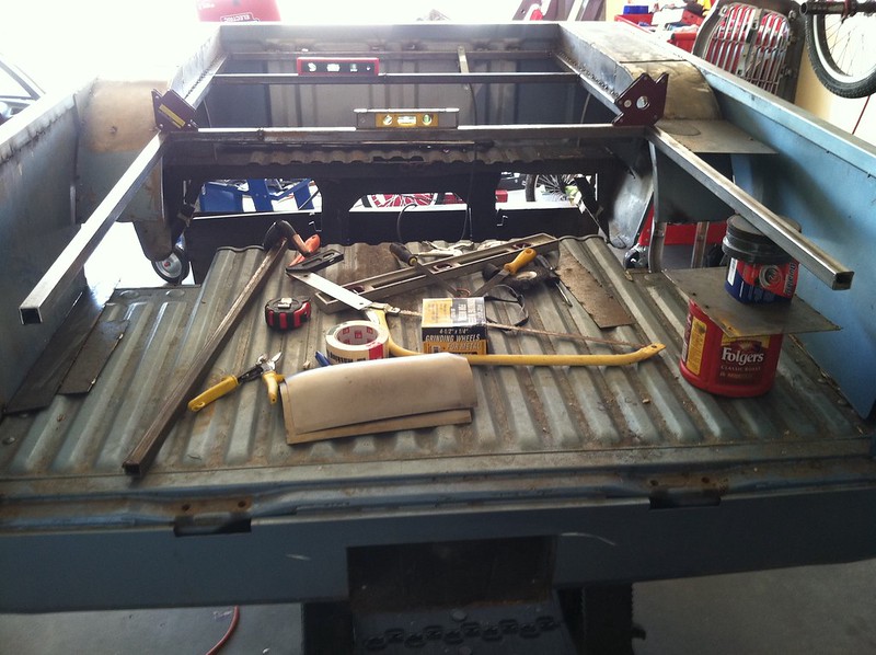

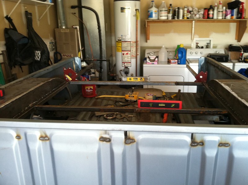

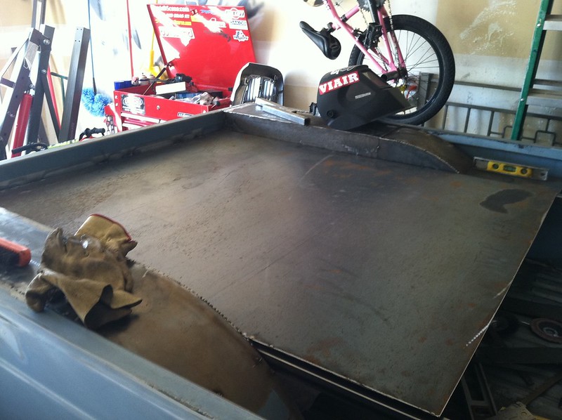

doin work! tacked in and level...

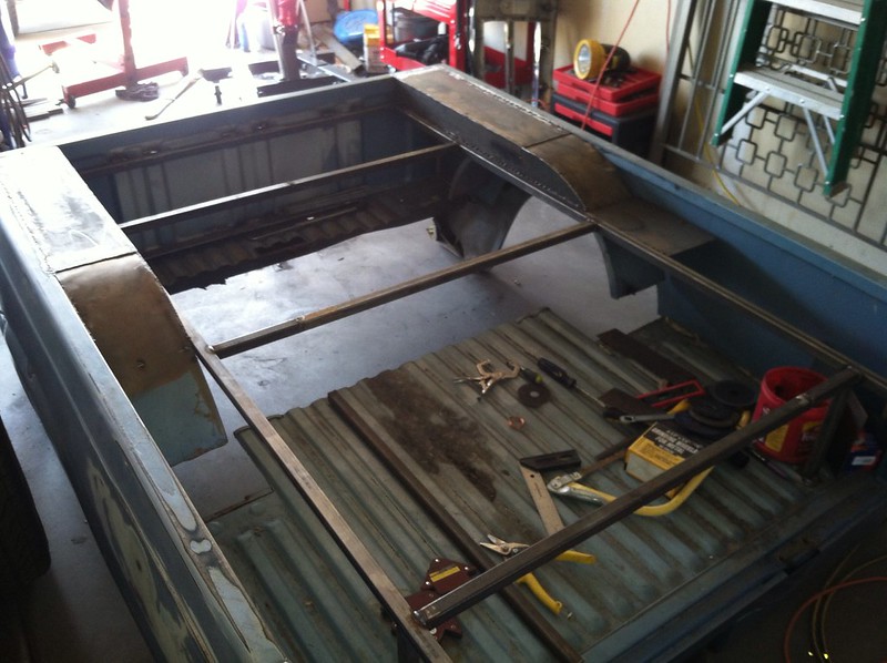

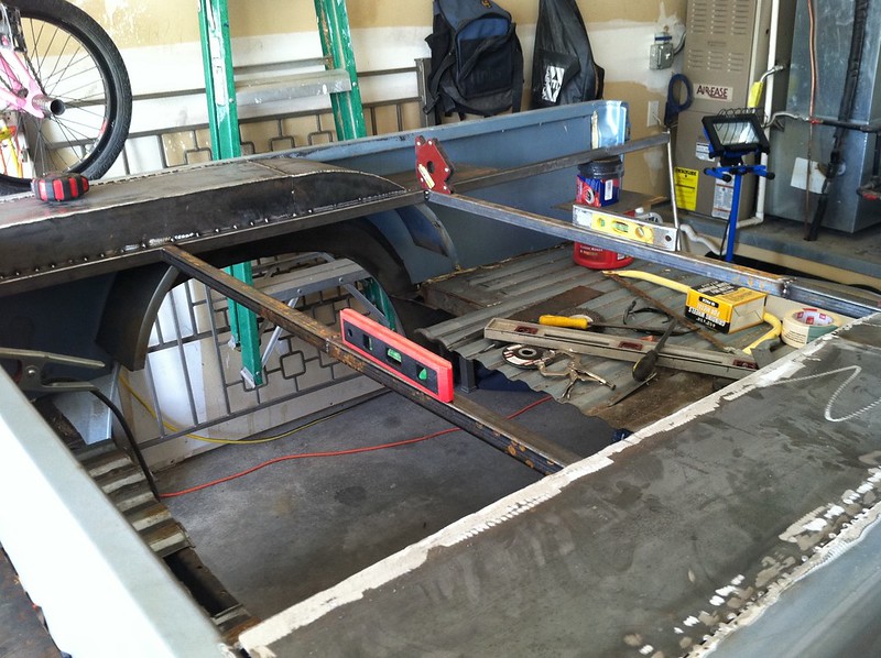

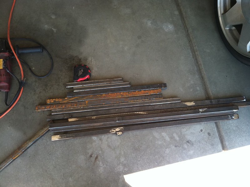

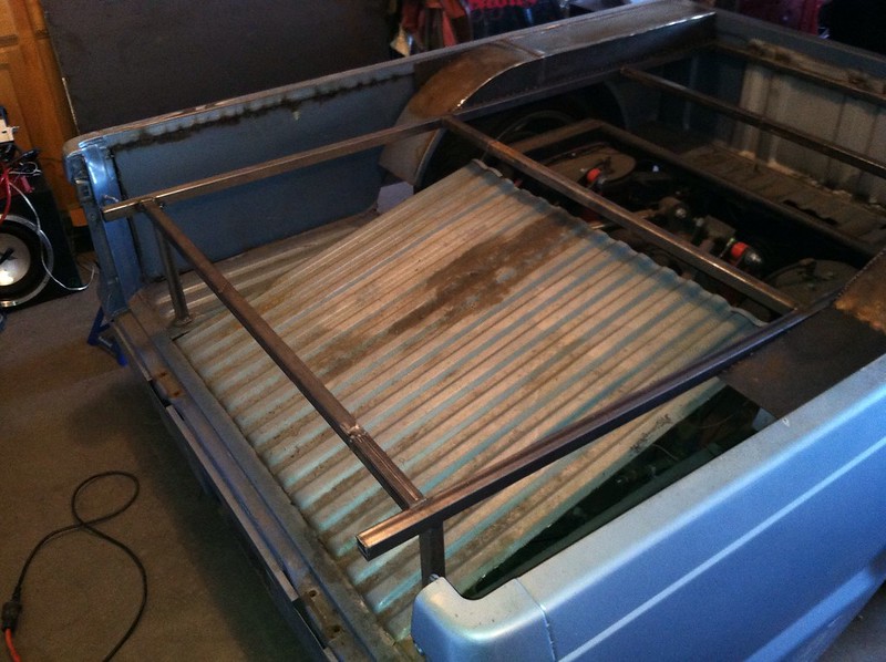

finding salvageable 1x1 square tubing from the previous bed floor to reuse for the new floor. turns out that i changed my bracing plans, so a lot of this is scrap now...

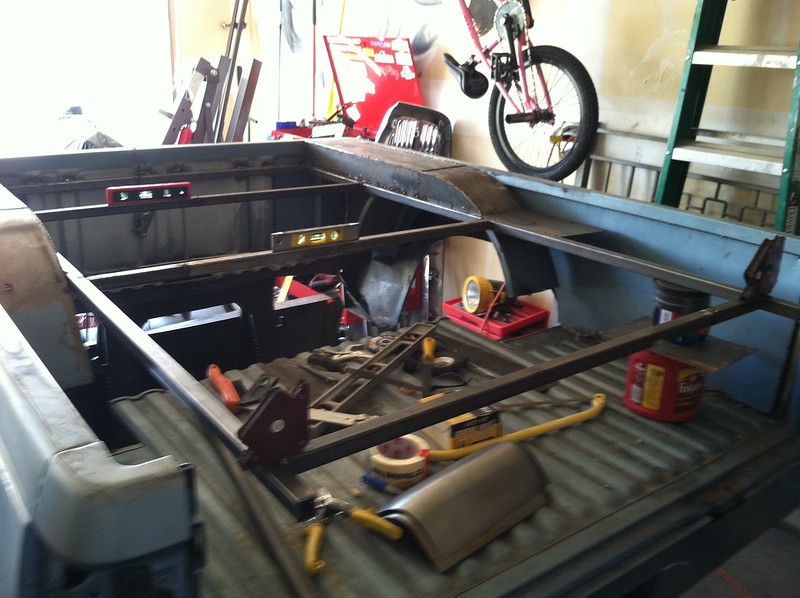

got some brand new pieces of 1x1 to start. made everything level and tacked it up
both sides tacked in and level
really sorry for the bad blurry pics, but i get in a groove and dont take the best pics lol. ur lucky u guys even get pics at all of some of this stuff...

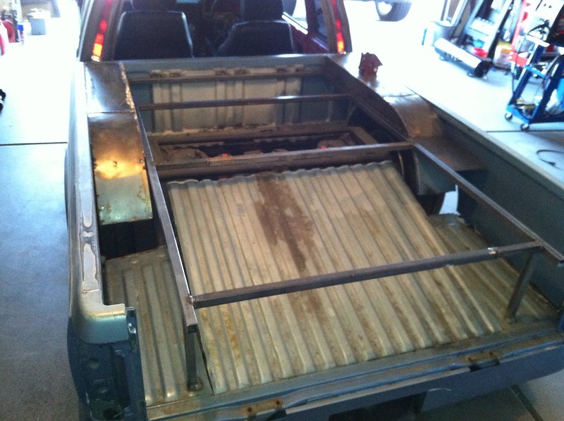

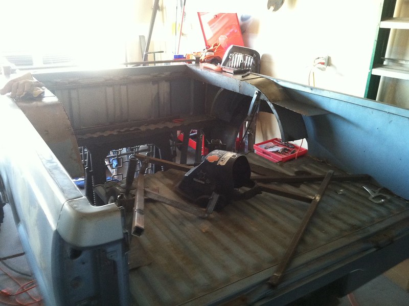

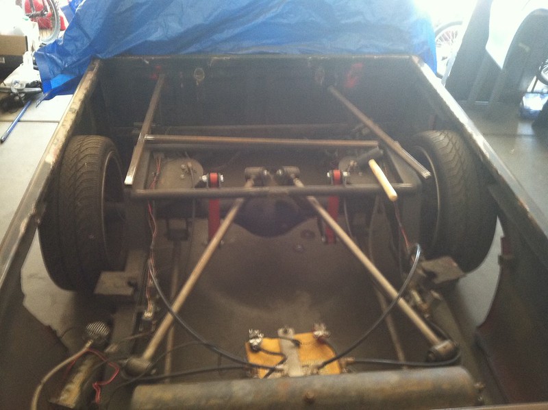

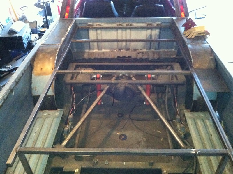

bracing it in. this will also hold my fuel cell and i have some other surprises to come later..
new tail light fillers will be going on soon!
this s*** is solid, and im not even done bracing it yet...

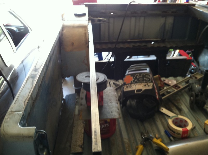

getting some vertical support for the rear. will gusset this later after i move the floor up. the back will be a storage compartment. more on that later...

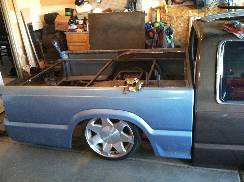

test fit...

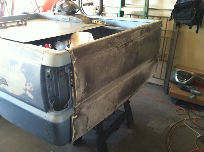

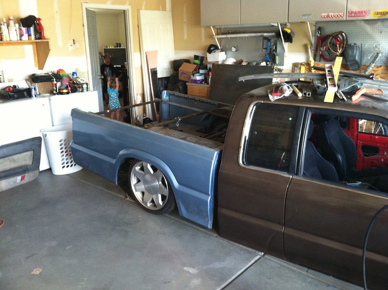

well, i needed to get the trashed bed off, but all my friends have moved away or dont have time to help out or whatever, so i just decided to hack the bed into pieces so i could remove it...
heres the bedsides hacked off lol
front of old bed

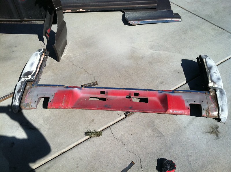

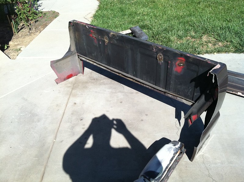

the rear after i cut out the existing roll pan and tailgate delete. not sure if imma use this or run a tailgate as of yet, but im leaning towards a tailgate but cant find one in good shape to save my life...

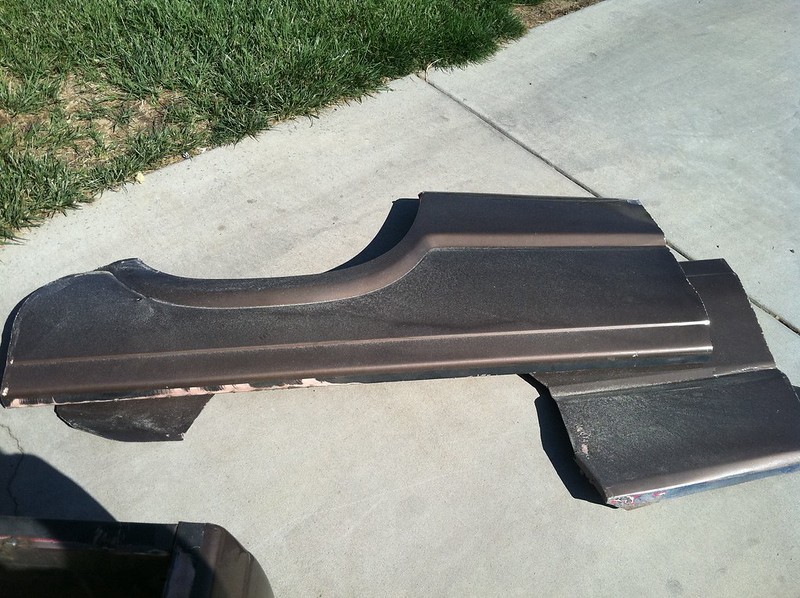

my tail light fillers. these are bad, but i wasnt gonna pay $180 for the good ones. i can make these work. just have to add a few body lines in to them...

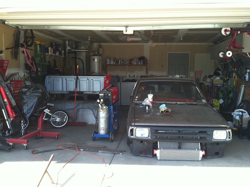

a shot of the garage...

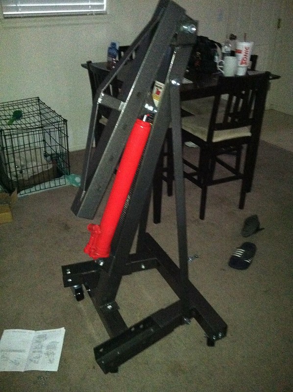

picked up some new tools. heres my new 1 ton cherry picker.

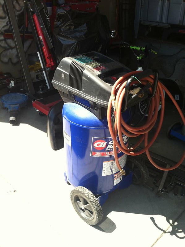

picked this compressor and hose up off the street corner for $100. cambell hausfeld ftw!!!!

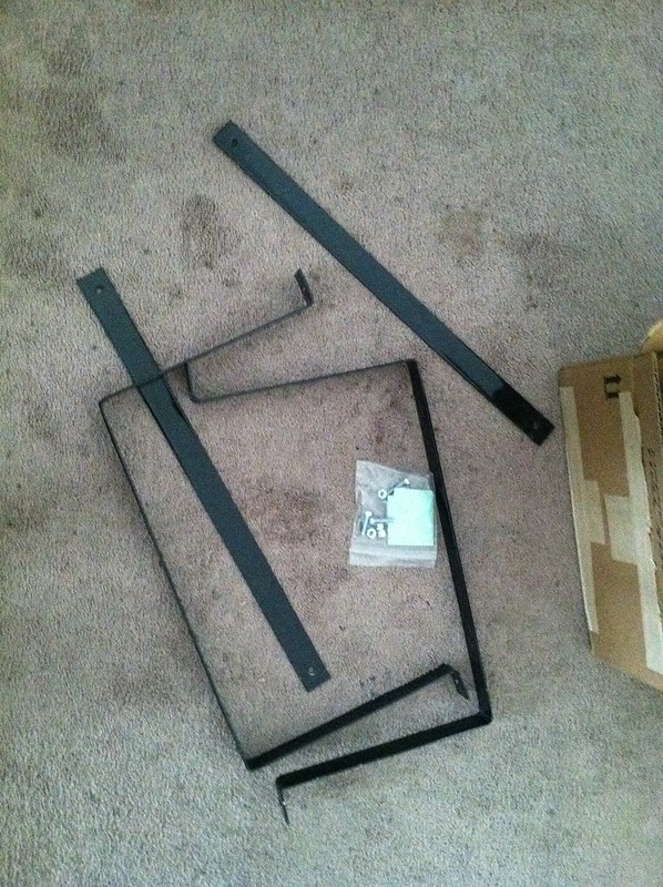

my ridiculously overpriced mounting brackets for my fuel cell. if i wouldve known this was all there was then i would have made my own brackets... what a joke. and this picture makes my carpet look hella dirty. wtf? lol
now i just need some fitting and to run new fuel lines and get a bigger fuel pump!

other than that, its just a lot of welding and hopefully one day i can splurge and buy a tank of argon so i can get going on my intercooler piping.

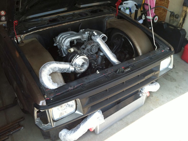

so when i was pulling stuff off my frame i decided i was gonna mock up my intercooler piping since i hadnt even taken it out of the box since i had gotten it lol.

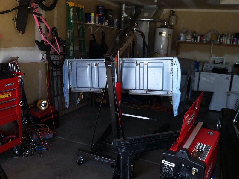

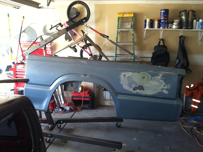

so then i got the bed lifted off of the saw horses and set it on the ground. i used the cherry picker cuz i thought it would work, but needless to say, it didnt work worth a ****...
and here it is set on the ground and made sure everything was still square and level...

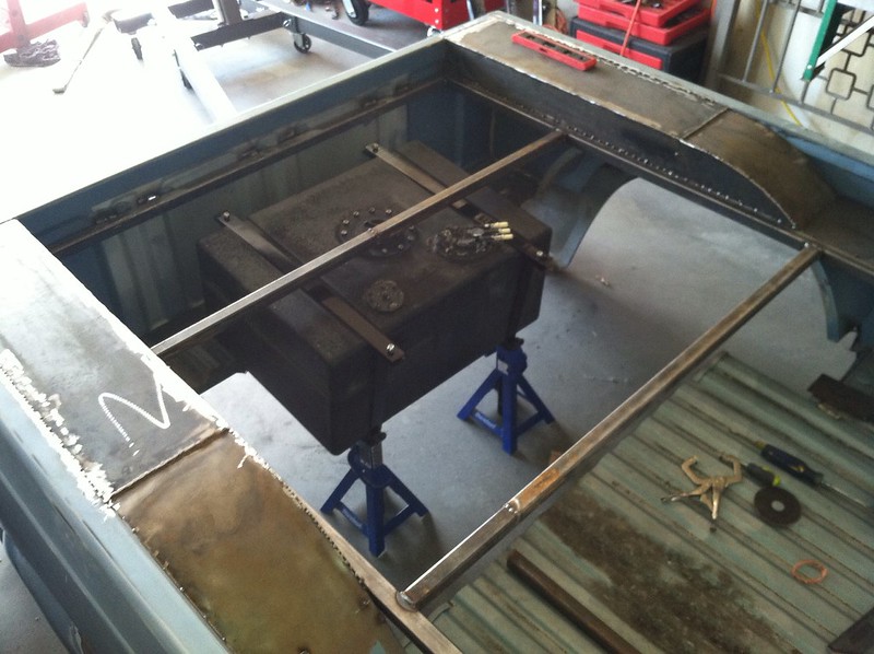

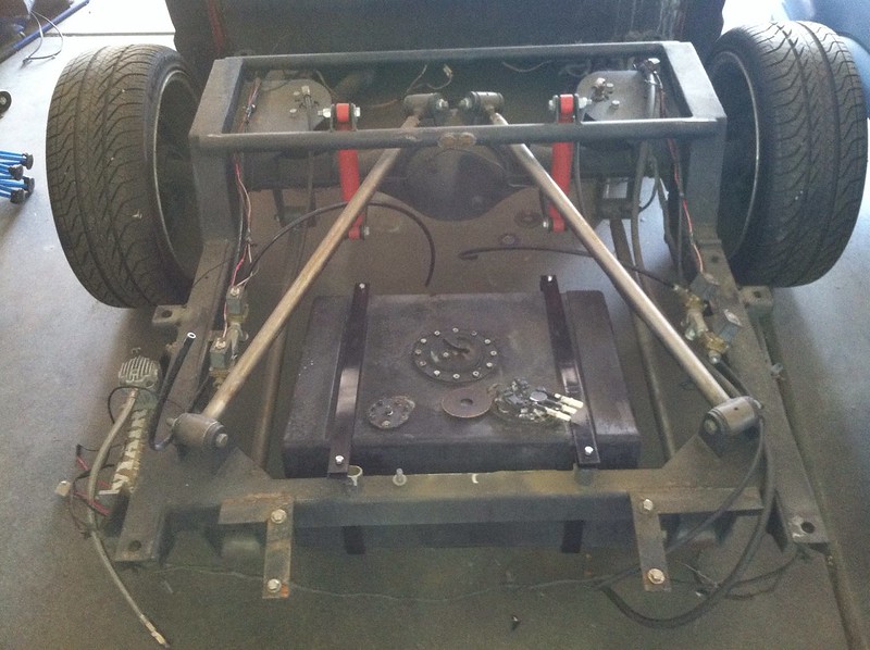

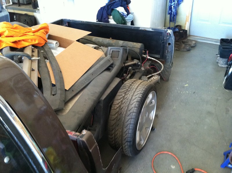

started checking for where i could put my fuel cell. this is a RCi 16 gallon fuel cell. i wanted to put it here, but for driveline issues and the floor still has to be raised for the bodydrop and such, this location will not work. damn the luck...

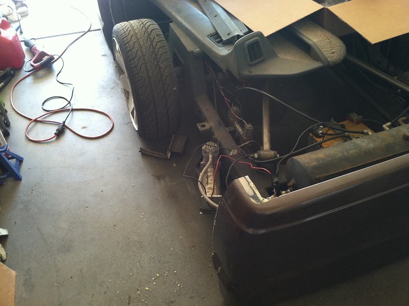

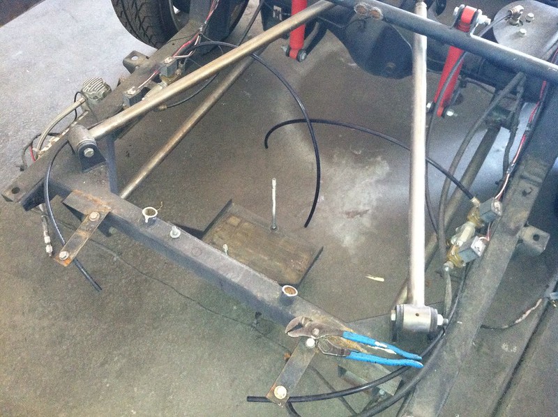

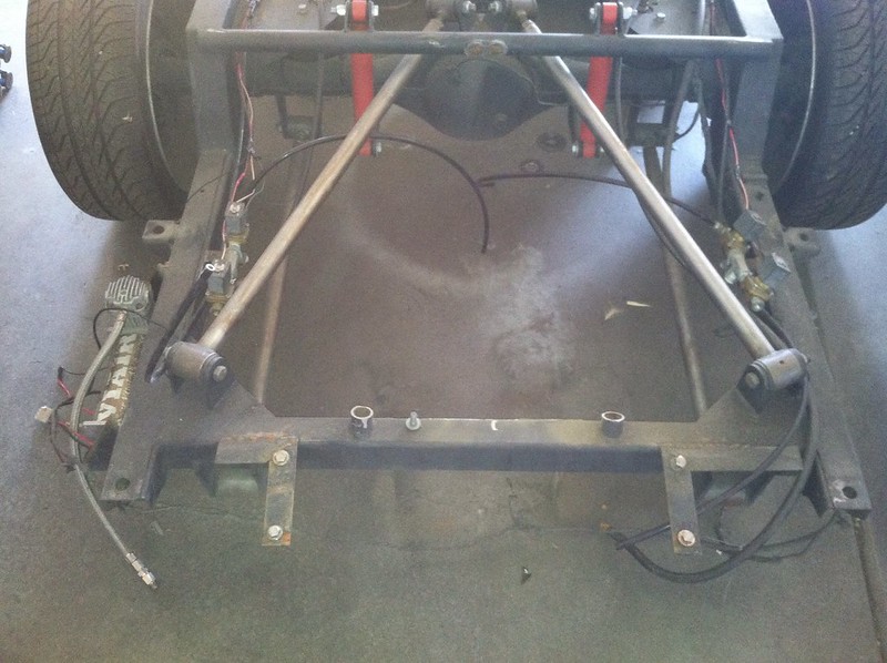

it really sucks, cuz a lot of thise stuff in the rear is going to be in the way and i want to redo it so bad and do a rx7 irs, but im not digging back in to the suspension even though it is outdated. i just want to get this thing in a rolling complete chassis and be done, so i decided to cut everything that will be in the way out of the way and make it work...

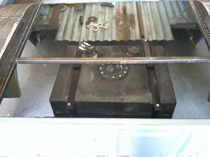

the battery box needed to be removed so i could mount my fuel cell in the back...
battery box gone. the frame will be ground smooth and powdercoated once all this s*** has been taken care of. i still need another compressor....
fuel cell mocked up. will be raised as high as possible to prevent any chance of it catching fire....
still quite a bit of stuff that needs to be moved, but this was good enough for now...

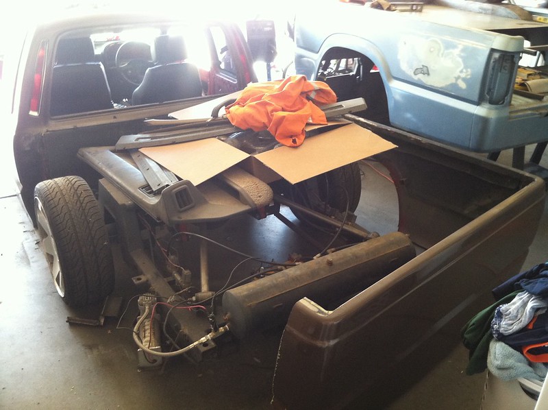

just exactly what i didnt want to do to this bed, but i had clearance issues, so things had ot be cut to make room. dont worry, when the floor has been lifted for the bodydrop, this will all be plated back in!
heres the difference in a stock height bed and the 5 1/2+ inches of bodydrop that thie cab has. i still have to cut 2 inches out of the bottom of the sheetmetal on this bed so it matches up with the cab and plate it all in. more on that later...
i will build around the 4 link and other stuff, and have to cut a hole for my compressor and airtank and all that jazz, but here the bed is before the rest of the floor is cut and dropped to bring it down for the body drop. i havent decided if i want to stock floor the bed or do a traditional body drop on it, but either way there will be a lot of welding and a lot of capping...
