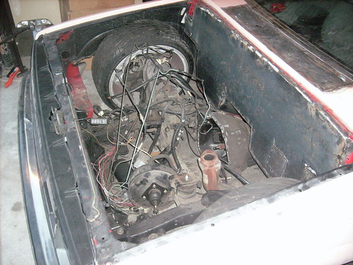

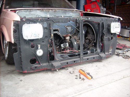

ok, well ive got some pics. noting special, so dont hate.
like i said the truck is back together for the most part. i just wanted to make sure everything mounted up right.
maybe ill get to tear back into it tomorrow...

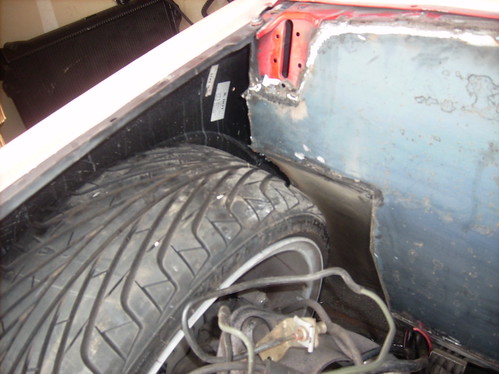

anywho, heres it going back together. shaved cowl vents, just need to shave the windshield wiper hole..
its still really rough for the most part, but i have enough clearance for 20's now..

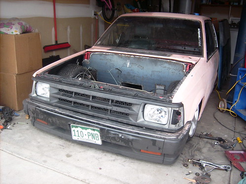

different angle. the whole fender is going to be boxed in over the trailer fenders. i just cant do anymore sheetmetal til i get the engine mocked up..
i dont care what anyone says, that s**** low..

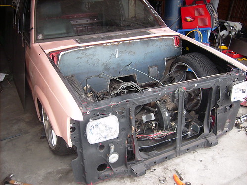

bumper and grill back on. ready for a rotary? i think so...

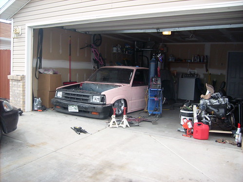

messy ass garage...

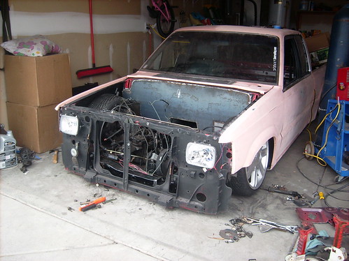

time to tear down again and finish the grinds and start some bodywork..

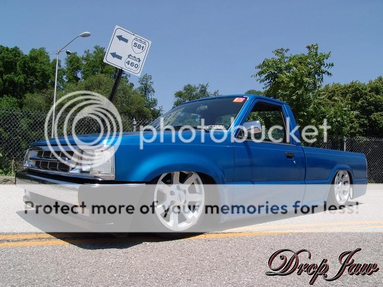

thats the truck that brought me to this site...
a member on another forum that i am on posted a pic of ur truck and suggested i check out this site..
