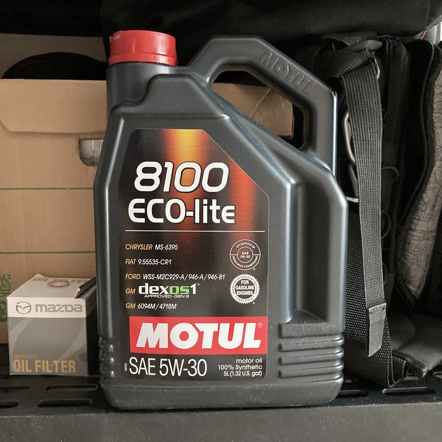

Canada, 1800Km, Motul 8100 Eco-lite 5W-30, 5L (full jug).

5L was 1mm above above the full mark, when checked cold. So 5 quarts would not make it to the full mark. I'd rather be slightly over-filled than under-filled.

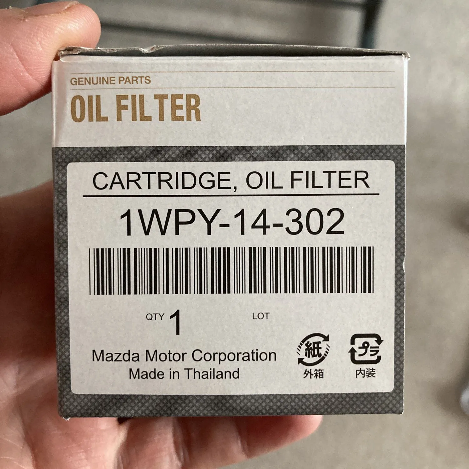

And I assume you use OEM 1WPY-14-302 oil filter.

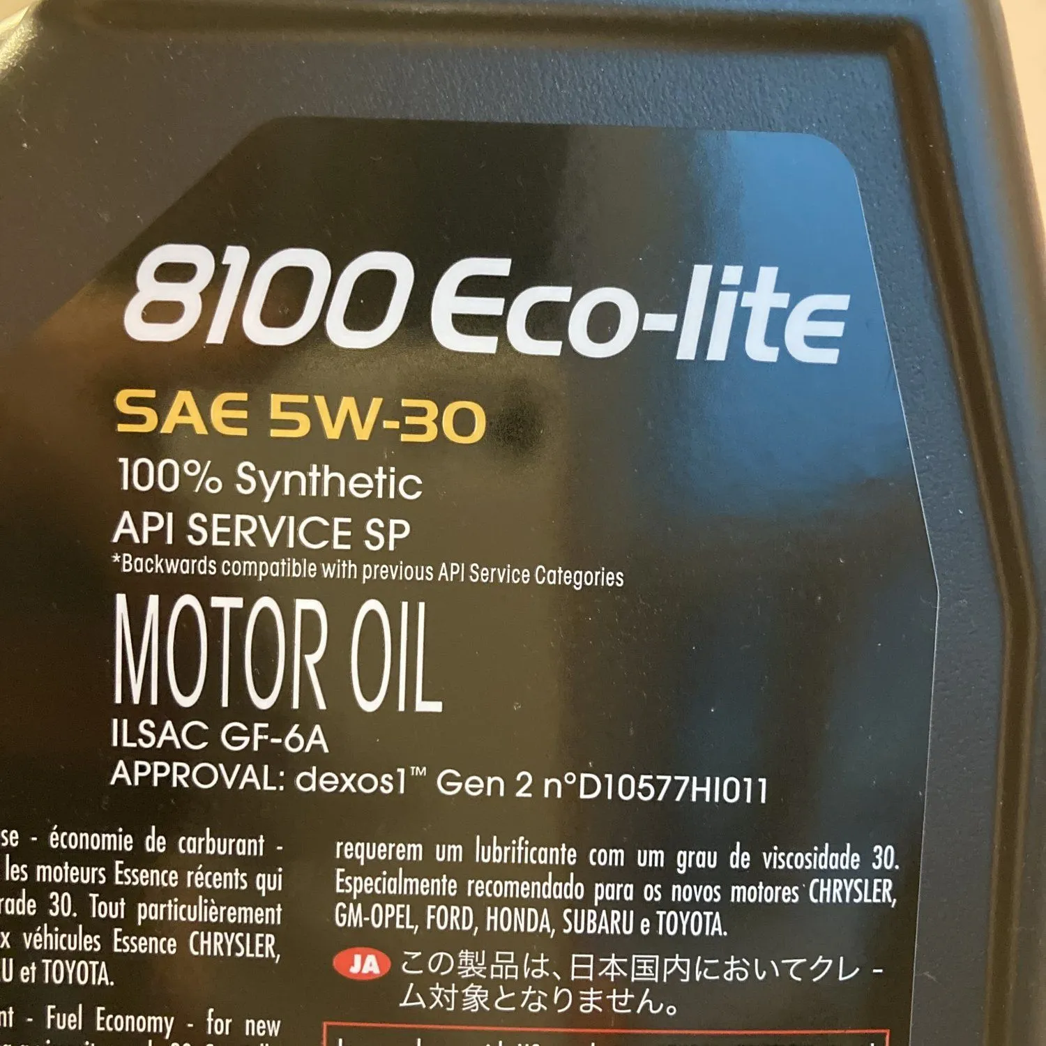

The Motul is also API SP and ILSAC GF-6. I chose it because it is on the thicker side of 30 weight and has a higher HTHS (3.3 @ 150) than most other SP/GF-6 oils. I think that's why the engine runs smoother and quieter with it.

Motul 8100 ECO-lite 5W-30 is a great oil from France. The reason I mentioned Idemitsu SP / GF-6 5W-30 is because for some reason we can only get Motul 8100 ECO-lite 5W-30 oil with API Service SN certification in the US. In your picture it says SP, but no GF-6 mark.
