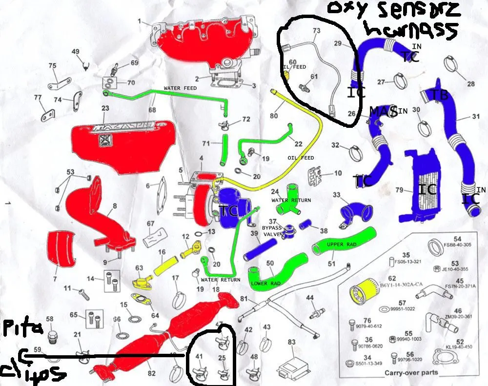

Ok guys, got a couple questions. Check the attachment for the circled parts. 1. How the hell do those funky little clamps come undone? 2. The mid oxygen sensor harness, number 73 in the diag, do I have that on the p5 already? Is this for the sensor that connects to the exhaust mani? Hope you all enjoy the mspaint skillz, lmao..

i think they actually sell a tool for them but i've used a pair of channel lock pliers and they work fine, it's a mighty tight clamp!!
sorry about the other, not sure, but i think the p5 would have that already...check it out here...
http://protege5.ugly.net/
I think it is just for the exhaust mani o2 sensor. And for those clips just get a set of pliers sqeeze and shake lol.

yeah those clips come off really easy with the channel locks, some of the hoses are on real tight even after you get them undone, turn the hose and then it slides off pretty easy
