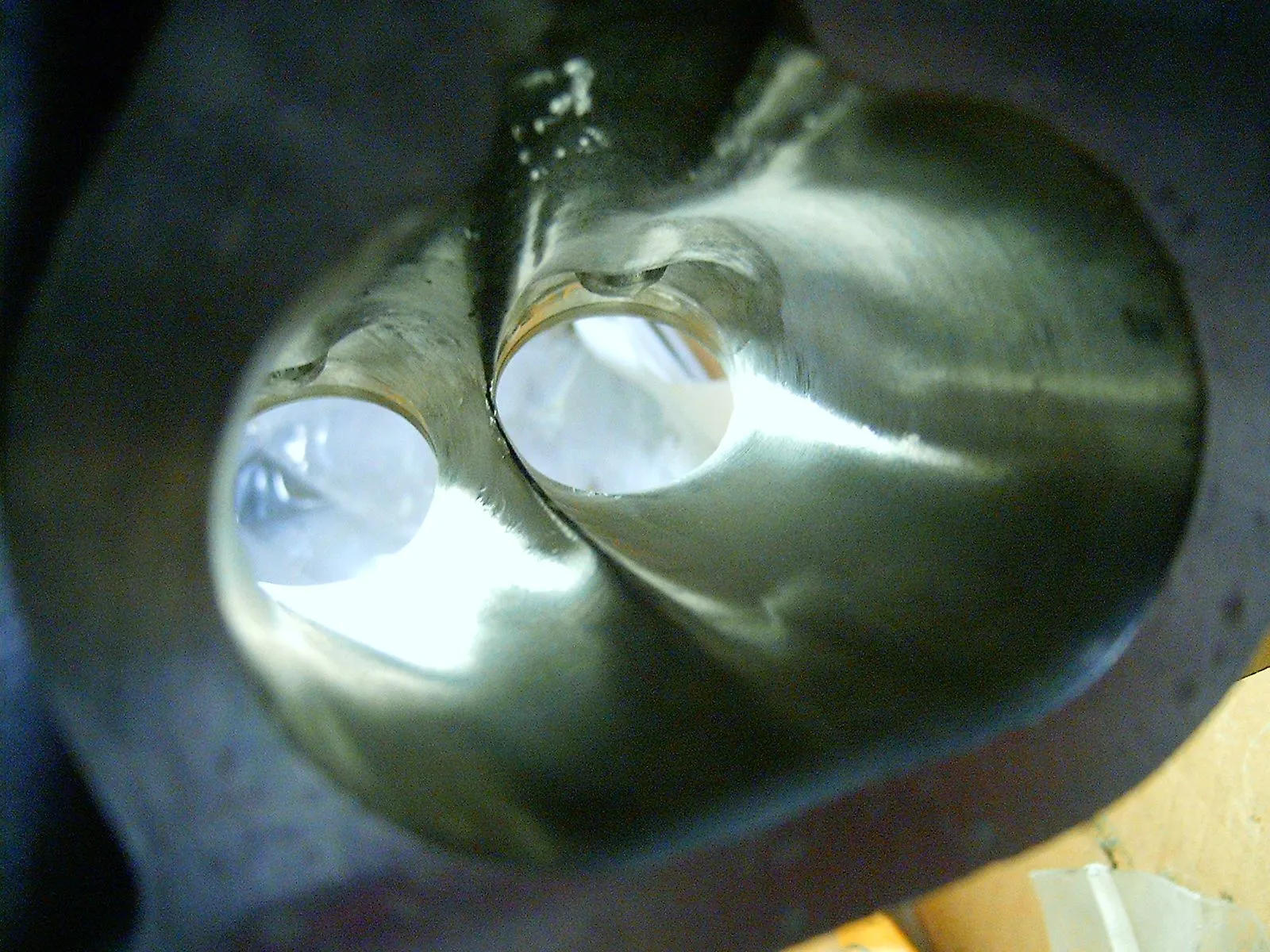

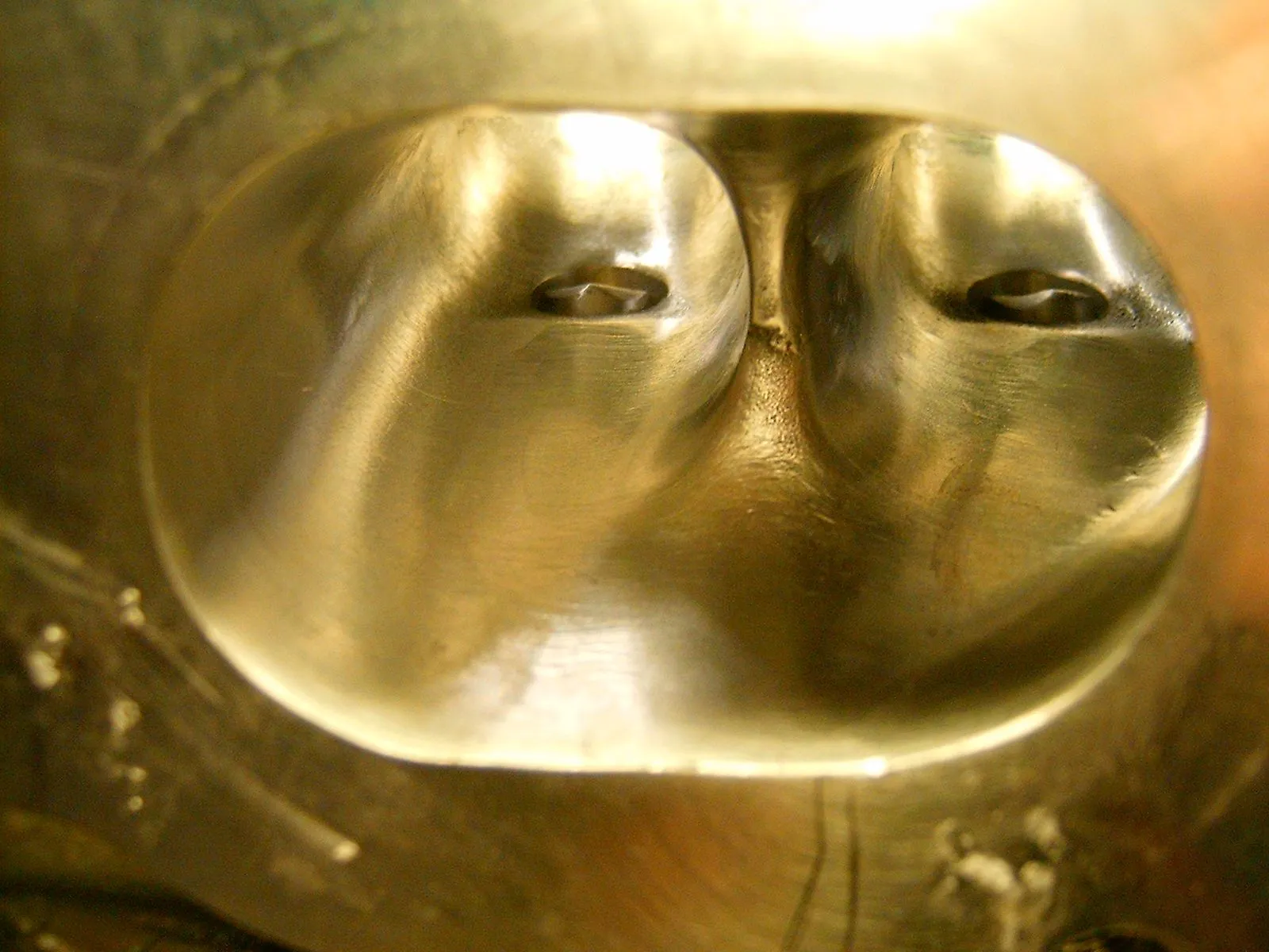

have you seen the stock ports? there is pleanty of room for more HP
Nope....never seen them. lol

Right now we are working on a race head.Our head has Stainless steel valves, aftermarket valve springs,retainers,etc.The head includes gasket matching of the ports, blending the valve seats, and completely smoothing the valve guides to match the port roof. Ports are completely reshaped and polished for maximum flow and velocity. Combustion chambers are reworked and polished.Retail is going to be around $1600
