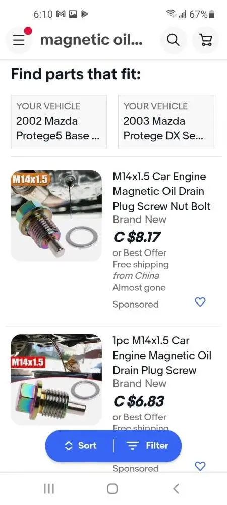

One of these should help keep your metal bits from circulating through your engine...
