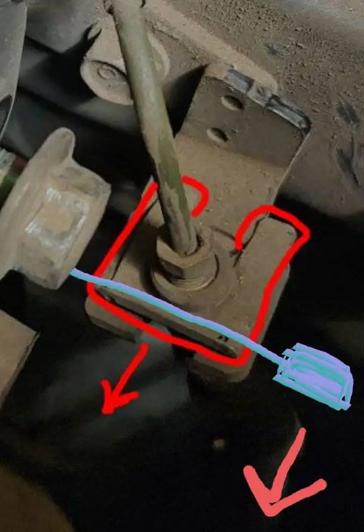

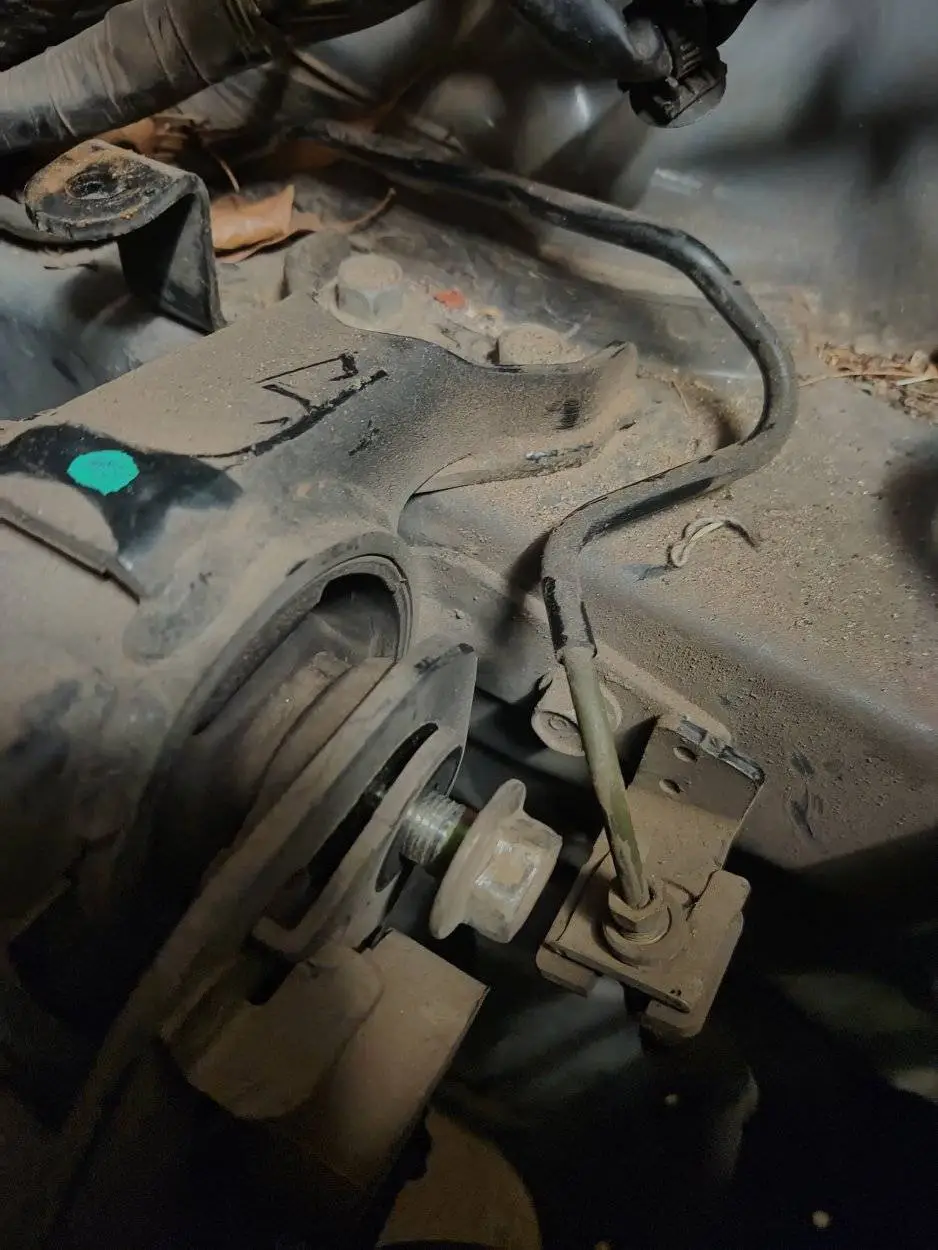

Help, there is some sort of hydraulic/fuel line attached to my engine mount making it very hard to remove. Can anyone suggest next steps? Photo attached

Removing that line is actually quite simple once you've done it and understand how it works. Let me see if I can try to explain it. You need to grab the end of the clip that is bent up with a pliers, then pull it off. It's going to be stiff at first. You can try to wiggle it from side to side too, it'll pivot on the circular bushing thing around the line.
Try to remember orientation of the clip when reinstalling too. It'll only go back on one way, and will take some force with the pliers. Make sure you put the clip through the groove in the circular bushing thing too, so that the line is held in place.
That type of clip is present on other places on the vehicle (I think brake lines for one) so it's good to know how to take them off.
You don't need to remove that bolt.

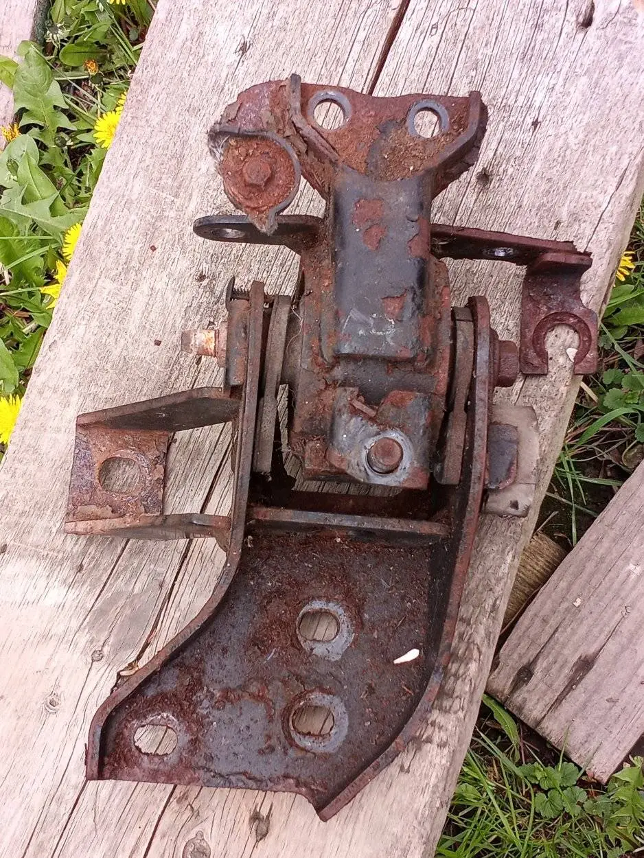

This is the transmission mount that I removed from my parts car.
I kinda forget what I did to get it out, but that hydraulic line needs to be disconnected from the bracket.
I don't know what all is included with your new mount, but if it looks like my old mount, you don't need to remove that bolt at all.
PCB - I was interpreting headofjar's problem as how to get the hydraulic line off, but I see what you're saying about the through-bolt. Unfortunately, if his mount is anything like mine, he definitely will need to remove that bolt. I happen to have a brand new mount right here on my desk, and it does not include the side that mounts to the engine.
Sorry, not trying to contradict you. Just want to throw out an alternative opinion :)

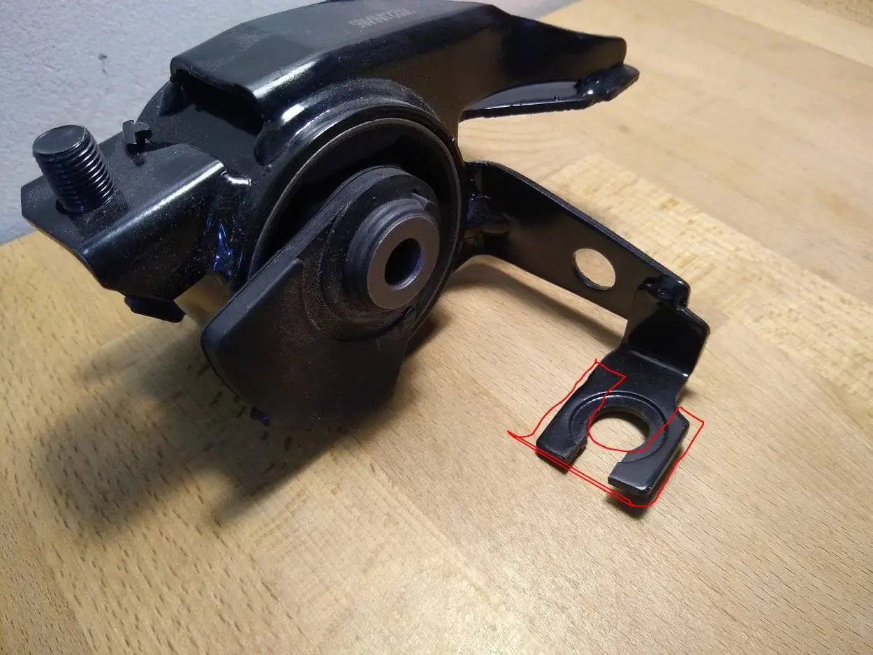

The issue is, I have a complete new mount, when I remove this mount what do I do with this stamped bracket?
You should just be able to install the new mount, put the line in it and install the old clip, like it was before. See my badly sketched illustration on a photo of the new mount below.

I remember those clips.
They use them on the rear brakes for the P-brake cable.
They have to be removed every time you replace the pads or rotors.

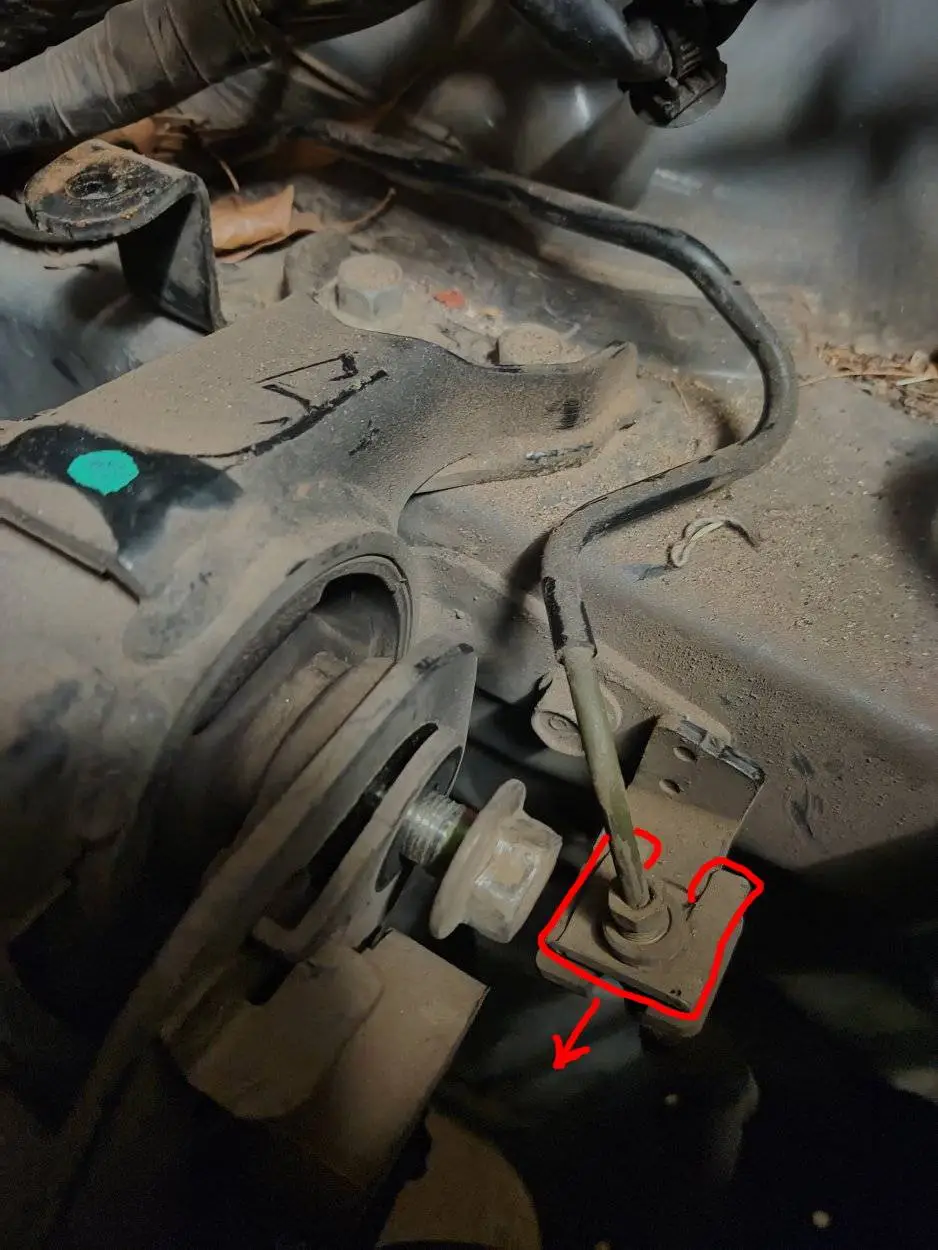

I use a small screwdriver laid down on the clip, between the lip and hydraulic line and pull on the screwdriver handle. It kinda rotates the clip to loosen it up.
Pulling on the clip with a pliers can be difficult, and when it lets go, your bound to take out a few knuckles. Lol
I tried to draw a picture on Benji's picture of what I mean, but I'm drawing with my finger on my phone. Lol
The blue blob on the end of the blue line is supposed to be the handle of the small screwdriver.
You guys are legends. Thanks for the advice. It did aid me in removing the mount. My new mount does not have this same bracket so I will have to come up with another way of securing this line. It's a kelpro LH mount. It's installation seems to have made my new rear mount vibrate like crazy. I had the rear mount done at the mechanic and I think it's not suitable. So I am open to any ideas how to solve that. I may have to try putting an OEM rear engine mount in to finally fix these issues. 4 new mounts. Hopefully this will be sorted soon. The car was so close to perfect)))) oh well I'll persevere. Thanks again guys, really appreciate your advice.
The new mount did not include the piece that attaches to the transmission. So I removed the bolt to get the central part of the old mount off. I may have the wrong mount as it is missing a few of these other projections as well. I specified a manual mount but I think eBay has struck again.

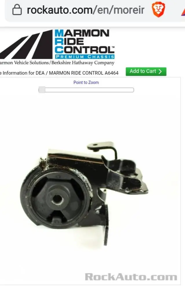

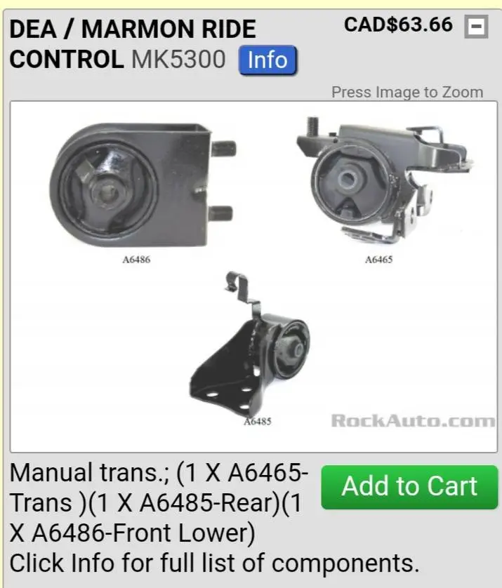

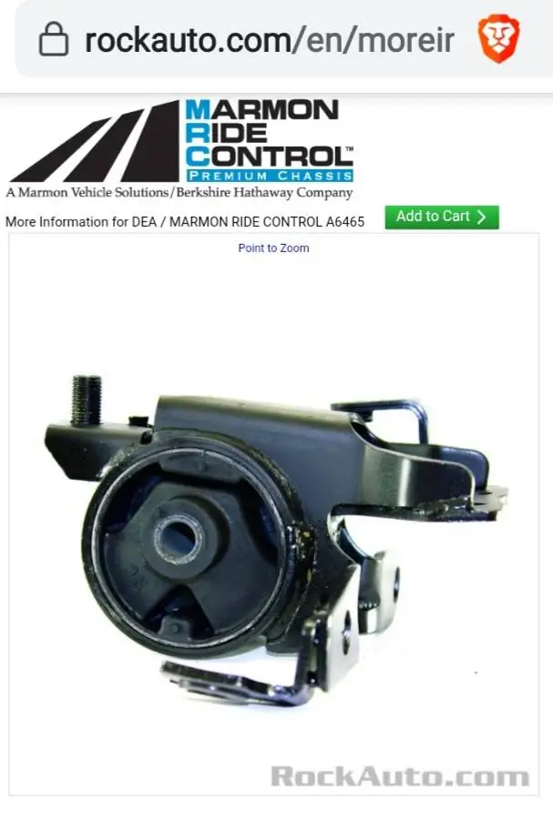

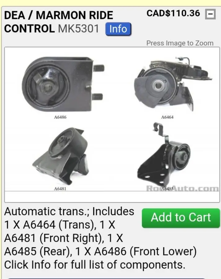

Is this photo of the new mount a automatic or manual mount,?
...I may have the wrong mount as it is missing a few of these other projections as well. I specified a manual mount but I think eBay has struck again.
Yeah, I think you got the wrong mount...
These are pictures from RockAuto...
It looks like you have the "A6464" instead of the "A6465"
View attachment 298189View attachment 298190View attachment 298191View attachment 298192

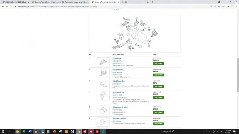

I noticed while re-installing my son's transmission and the support beam under it, the beam has a big hole for something (like maybe some kind of insulator) that wasn't there in my case and maybe not yours.
The front of that support beam has rubber isolators between the beam and car body where the bolts go through to mount the beam. The very rear of that beam is bolted into the body metal to metal.
As I tightened the front beam bolts down, the transmission case was resting on the metal beam - metal-to-metal.
I loosened up the front beam bolts and installed a 4"X5" piece of rubber matting about 3/16" thick into that area and tightened up the bolts hoping this will help dampen any vibrations.
Note:
Further researching this issue, I found parts breakdown listing at the link below.
It looks like there are vibration dampers but why would one near the center of the cross beam be on the "underside" of the beam?
See lower drawing of the two on the webpage linked below for the manual transmission parts.
A partial snapshot from the website page is attached below.
