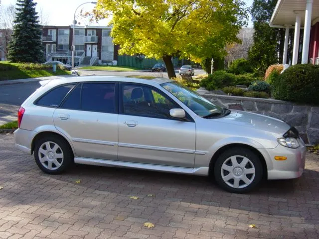

btw here's my car, my new snow tires have been installed (Toyo Garit KX), Mazda 3 hubcaps.
