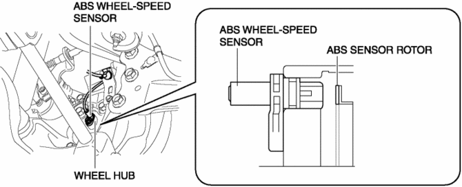

Where is that old style sensor located? I've always had the internal style.
Front ABS wheel-speed sensor and sensor rotor:

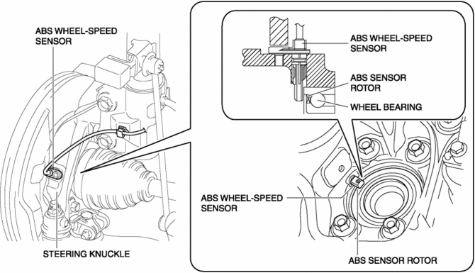

Rear ABS wheel-speed sensor and sensor rotor (2WD):

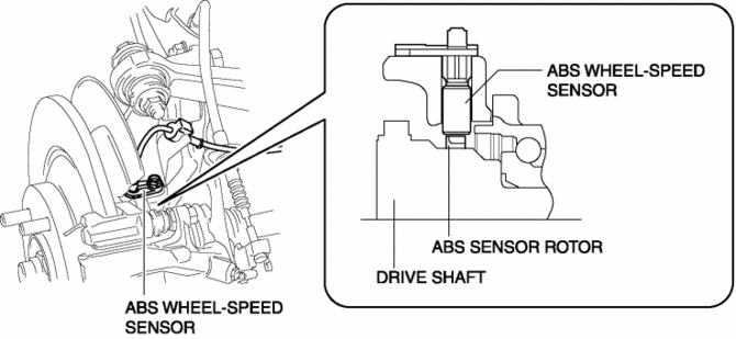

Rear ABS wheel-speed sensor and sensor rotor (AWD):
