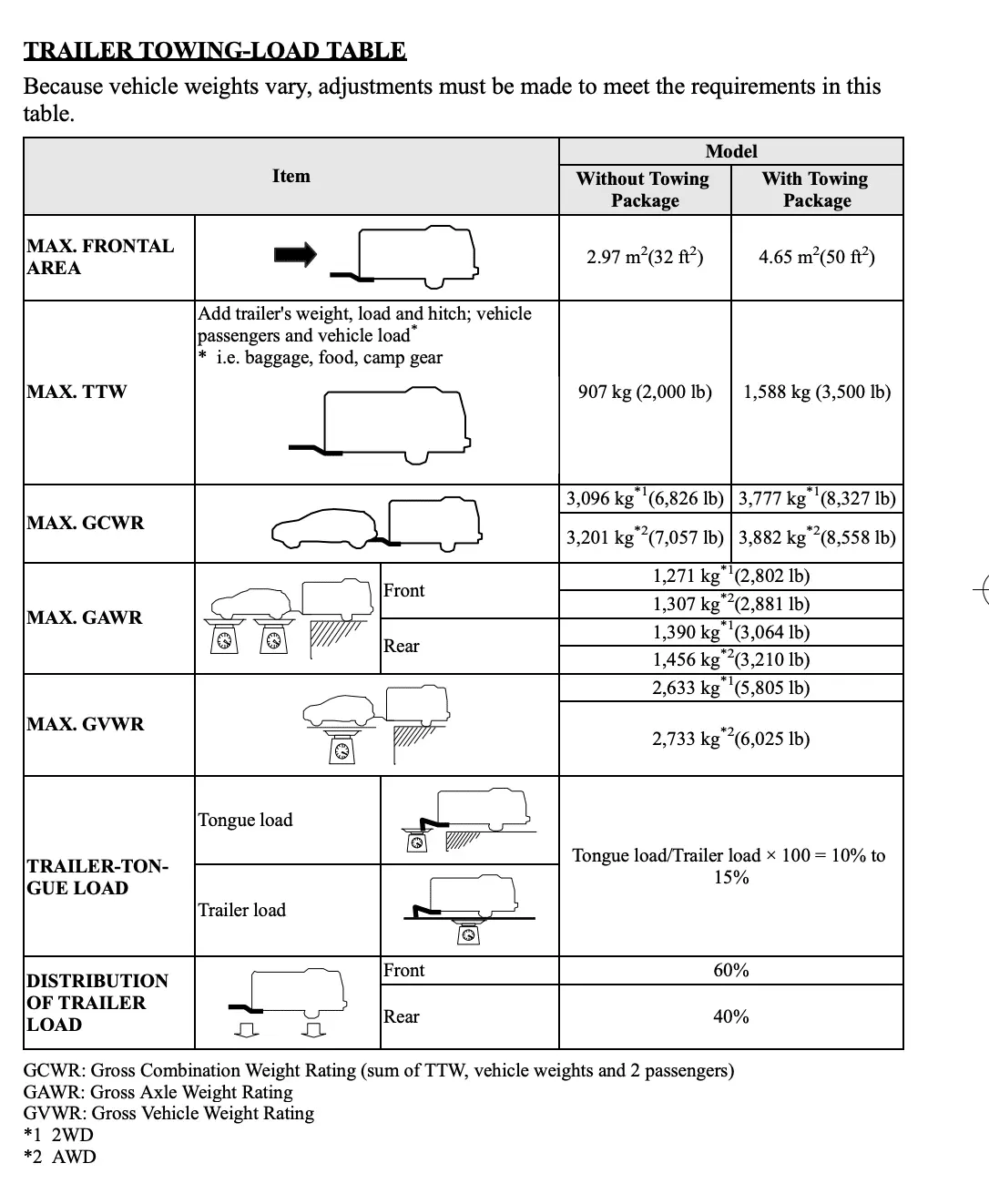

Good points. I am going to be in mountains at times. However, the DMV rules in California say you don't need trailer brakes if your trailer is under 1500 lbs. The Mazda handbook is stricter than California law!
Woah! I'm of the impression that anything smaller than the CX-9 can tow only a maximum of 1,000 pounds. If that's not true, how can I find out what weight my '09 CX-7 can haul?
From the 2009 CX 9 manual Screen Shot 2020-09-17 at 10.00.39 PM.webpBeginning 4-14. It appears to be 2,000 lbs which INCLUDES weight of trailer and the weight of passengers and all other items loaded in the CX9. I wonder if passenger includes driver? 1,000 should be safe weight. I am sure others will help.
