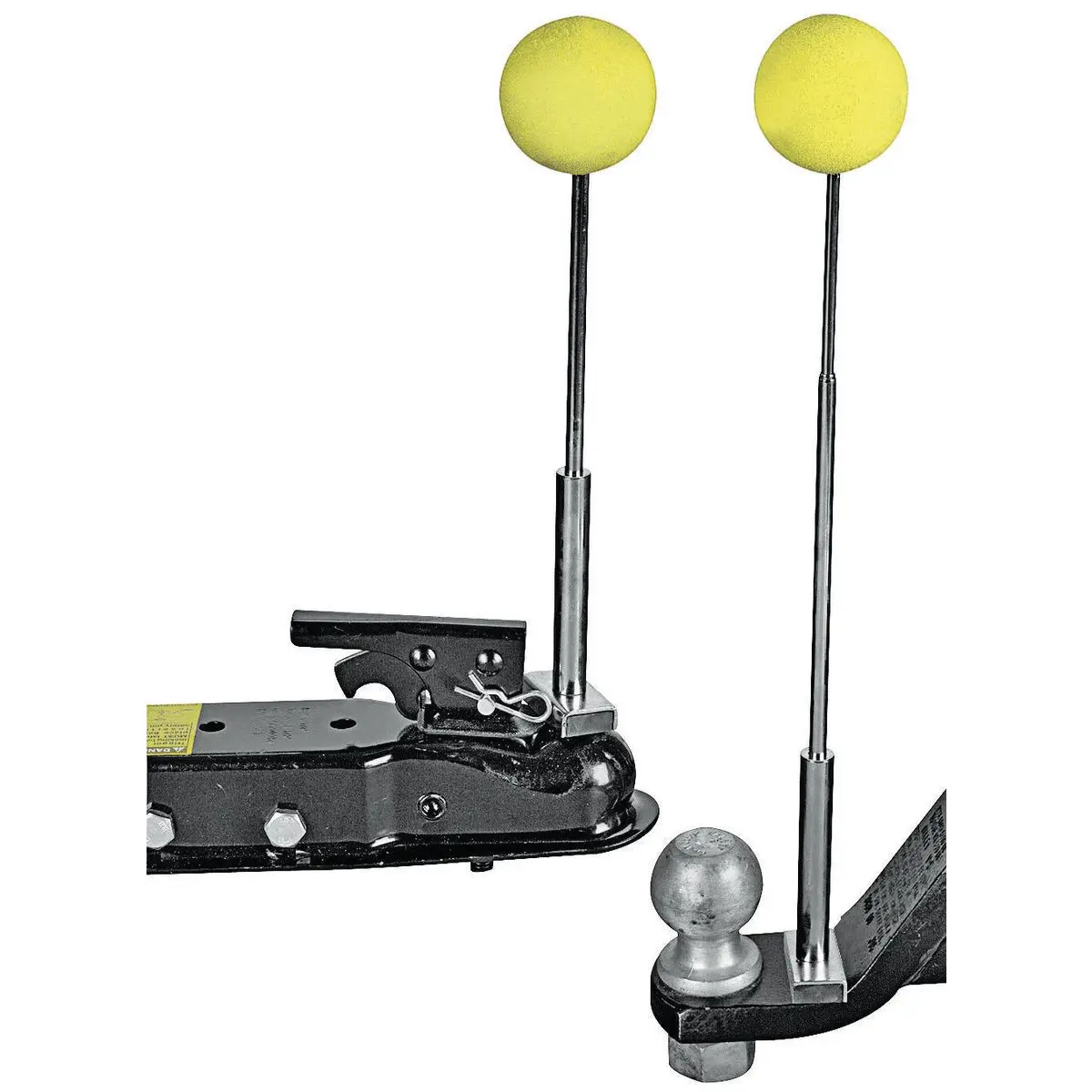

Easy. The most difficult part will be backing it with the poor rear sight lines of the CX9. Think of some visible gizmos you can attach to the back corners of the boat or trailer to give you something to see. (These from HarborFreight are portable for hitch or the back of the trailer.)
Really good idea! I will also never being unloading and loading the boat myself, or backing it up myself so I'll have someone with me to direct me.

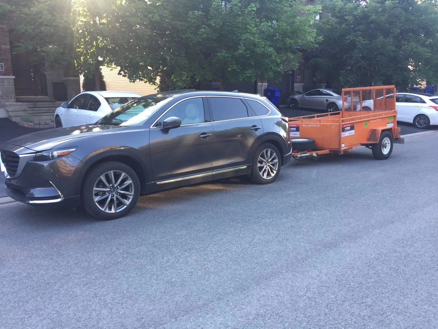

I rented a trailer a few weeks ago to do some landscaping. It doesn't look like much, but about 2000lbs of paving stone and cement block, and I assume the trailer is at least 1000lbs by itself (5x8 trailer rated to 3700lbs cargo). So I was probably getting close to 3500 lbs. I could feel it in acceleration and braking, and definitely a bit of wheel hop from the front wheel having less weight on them but overall the car didn't really have any issues. The photo is with the trailer loaded.
