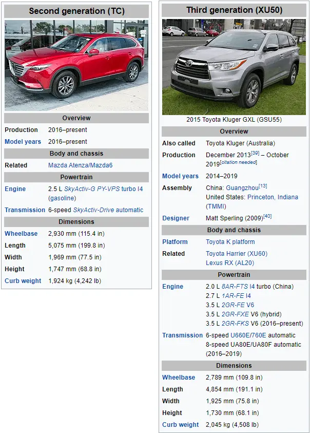

What are our cars only rated to tow 3500 lbs when other simliar models like Highlander are rated for 5000. Is it the frame of our cars? If I put a class 3 or 4 hitch on, am I OK towing more weight?
2009 Mazda CX-9 GT
Bigger vehicle, bigger transmission, bigger engine = larger tow capacity.
You could tow more, but when you kill your transmission or brakes, that is on you.
Mazda CX-9 Grand Touring 2016
Agree with sm1ke...more towing capacity requires bigger, heavier, more expensive transmission and the rest of the drivetrain, brakes, engine cooling, frame, axles, bearings, other parts.
2018 CX-9 GT
Also the suspension and the wheels/tires needs to be adequate to tow more. If you look at the cx-9 the maximum axle weight and maximum passenger + cargo weight limit is pretty limited.
but sometime the difference between a 1850 lbs towing capacity and a 3500 pound capacity is a transmission cooler. So go figure, it is quite hard to tell what the limiting factor for the cx-9 exactly is.

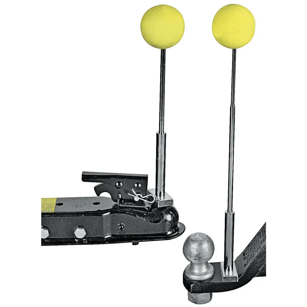

Easy. The most difficult part will be backing it with the poor rear sight lines of the CX9. Think of some visible gizmos you can attach to the back corners of the boat or trailer to give you something to see. (These from HarborFreight are portable for hitch or the back of the trailer.)
