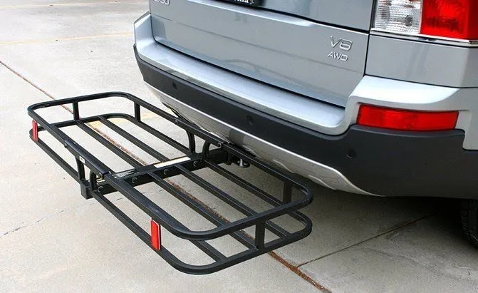

Just to clarify, the platform mentioned here looks like this:
Not really suitable for long pieces of wood, drywall etc. the only solution for those remains a trailer which you can rent if you don’t need one often enough to justify buying one.

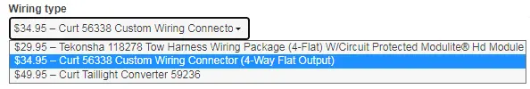

U-Haul has these options:
These would be installed on my car, correct? What is the difference in these (i.e. how do I know which one to select?)

Trailers usually have all the wiring and have a connector that you connect the car to. The wiring installation on the car is to install the connector and route it to the back where you can plug it into the trailer. Depending on t installation the connector can be in the trunk where you rake it out when tou need it or routed to the outside permanently to the side of the hitch where it is always ready to connect.
i don’t know the difference between the kits quoted above though.

Tekonsha, DrawTite, U-Haul, Reese...same item, different labels. Curt is very good, also.

I might just do that as well. Seems to me the only difference in the wiring kits U-Haul offers is the brand itself.
