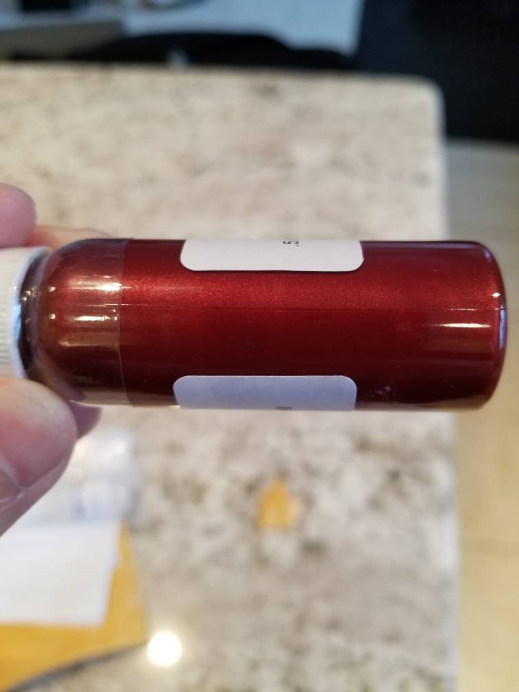

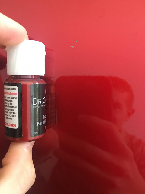

I ordered a Dr. Colorchip kit using the previous Soul Red paint code (41V). Holding the bottle of paint up to the car is looks nearly identical. I will post pics once I fill in the chips!

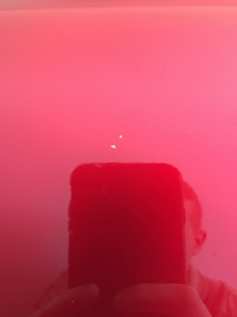

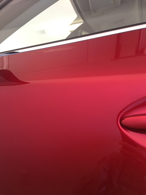

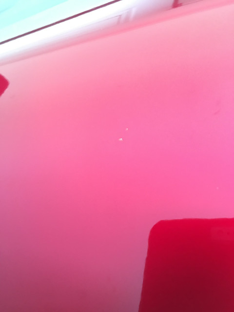

I finally got around to touching up my paint chips using the Dr. Colorchip standard kit with Soul Red (41V). This is the result I got using 41V, be aware that Soul Red Crystal is actually 46V.
All in all I think it turned out great, but if you have the impression that the kit will completely make chips invisible then nothing will probably impress you! From almost all angles it takes much longer to identify the chips and my wife could barely find them.
Chip Before
Soul Red Crystal vs 41V
Application of Dr. Colorchip
1st Coat
3rd Coat

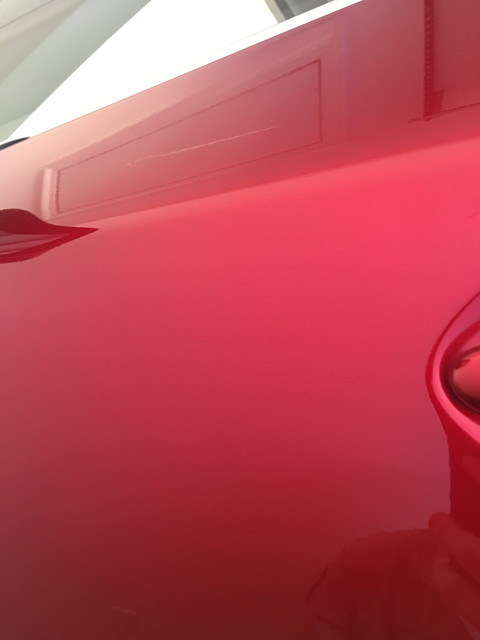

This is probably the 10th coat I did. I tried a few by just dabbing the paint in the chip itself, but when I used the blending solution is actually made it look worse on those attempts. The dab and smear method seems to work pretty good. After a few coats though I wasn't seeing much of a difference so I called it quits. From about 2ft away they are nearly invisible unless you know exactly where they are.

In the interest of being unbiased towards a product, in direct sunlight when you get up close you can still see the chip. I was walking out to my car yesterday and the sun was to my back, and the chips did stand out a little. In indirect light, or a cloudy day they are nearly invisible. Soul Red is a tough paint to color match perfectly. Overall I am still very happy with it.

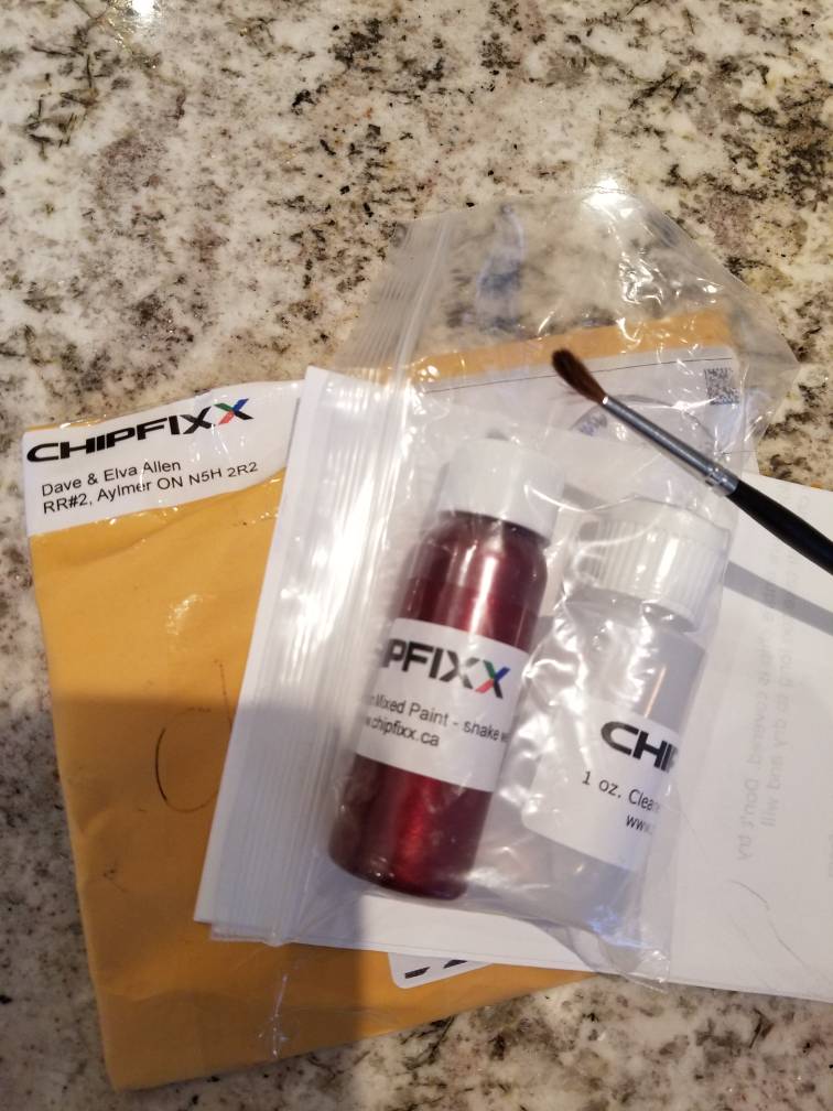

Looks great from the pictures though. I too, contacted the dealer for the 46V touch up pen, and they are not sure when they'll actually get it. I contacted a local shop that specializes in paint chip repair kit, and they were nice enough to customized a sample for me to try. Once I get a hold of the kit, I'll report back with the results, and share their contact if you guys are interested.

Just got my custom mixed paint. I'm going to do the repair trm., but the colour looks like a good match! Keep you folks posted.

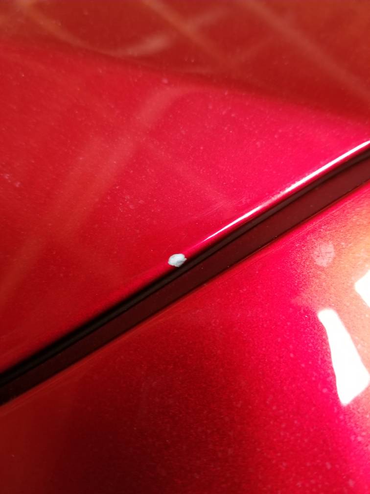

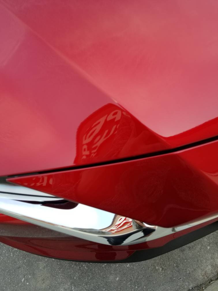

Lol, was reading over your thread the other day saving it for future reference. Well, yesterday, my wife got a HEALTHY chip on driver's side rear door. I will post before and afters when I fix it up.

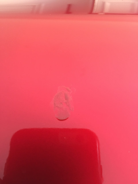

Got a chance to try out the kit from chipfixx last night. Really happy to report back with the results. Took a few trials to get it to fill the edge properly, and heat gun definitely helps.
Overall quality seems great. Hope this is not something I'll be doing often with this car. =p
