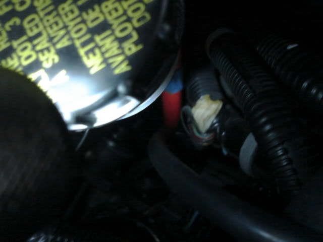

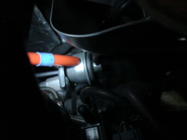

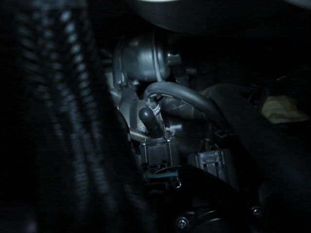

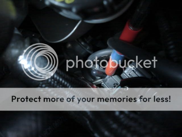

The two fittings on the wastegate actuator are a straight passthrough. I did an experiment by leaving the hoses as stock, and capping the actuator. Boost was limited to around 15 lbs by the spring in the actuator. Then I installed the controller and made run after run slowly adjusting it. Here are some pics.
This is the factory boost control solenoid, The cap is where the hose ran to the wastegate actuator, the hose went to the nipple on the intake.
This is the wastegate actuator, the hose attached to it goes to the inlet side of the Manual Boost controller
This one is hard to see. The pointer is resting on the nipple on the intake. The hose in the picture runs to the outlet of the Manual Boost Controller. Follow the hose from the solenoid to find it, it can be pulled off and installed by feel.
Here's a pic of the solenoid and actuator together, without pointers in the way. Very easy to get to, and can be put back as stock in about 5 minutes.
