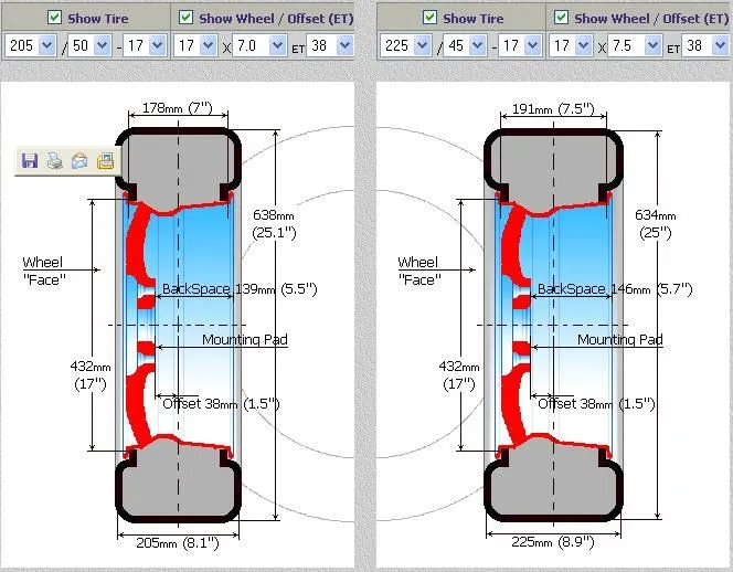

I m wandering if 225 45 17 will fit instead of the 205 50 17. It is almost the same ratio but i m wandering if 225 will be too large for the wheel.
Thanks
Check here. I mounted my 225's to 17 X 7.5 wheels. I think the OEMs are 17 X 7.

http://www.wheelsmaster.com/rt_specs.jsp
According to this link, the difference in width between the 205/40 vs the stock 255/35 would be 1.9" (or 25mm closer to suspension than stock). The difference between the 205/50 vs the 225/40 is 1.1" (or 10mm closer to suspension than stock).
But that's without entering the offset, since I don't know it.
If we knew the actual offset of the MZ5 wheel and the RX-8 wheel, we could get a much closer idea of how much clearance the tire will have.
