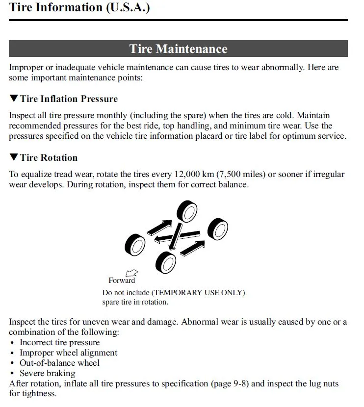

is "X" rotation pattern ok ?
I get free tire rotations from where I got tires and saw that the tech used an "X" pattern rotation (OPTION B) below
owners manual recommends (OPTION C), just wondering which pattern most member use for non-directional tires ?
attachment.php
useful link I found on rotation patterns: https://www.tirebuyer.com/education/tire-rotation-patterns
