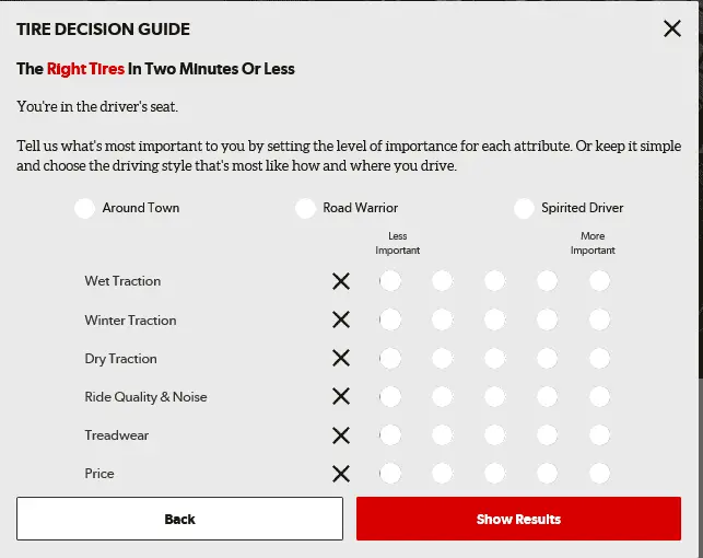

Start here: https://www.tirerack.com/content/tirerack/desktop/en/tire_decision_guide.html
After a couple of pages you'll get to the Decision Guide where you indicate how important each of six attributes is to you. This gives you a great starting point for picking tires that will do a good job for what you want. There are a few brands that TireRack doesn't sell, and these won't be listed, but otherwise it works very well.
