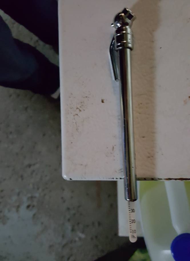

Just wondering if im at the recommended tire pressure ?
Its a 2017 cx 5 gs 17 inch tires .
Please see image below.
Your tire pressure gauge is showing 39 lbs, what does the sticker specify for recommended psi on the driver's side door jamb? 32 psi?
You should be fine. I run mine at 36. The recommendation is 35. 36 is easier to read.
Should i take some air out ?
The tires were installed and inflated by the dealer but just wondering why they would add more than the recommended psi

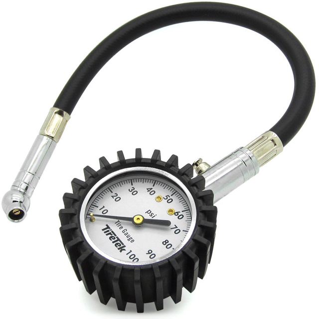

Or get this kind of air gauge
Great because it’s easy to read and you can bleed it down.

You have 2 threads going on, I'll reply here in the correct category.
When did you make the measurement? You've to measure tire pressure when tires are cold. The best is doing it the first thing in the morning before you start the engine and any of the tires is not getting exposed by the sun.
Do invest a digital tire pressure gauge which is easier to measure and more accurate.
Your gauge reads ~38.1 psi ;) and factory recommended tire pressure for your 225/65R17 tires is 34 psi. But I wouldn't let any air out yet as many CX-5 owners are running this pressure, and factory recommended psi usually is low and will cause faster wear on outer tread.

The car has not moved for a good 4 hours and yes i will be getting a digital one .
So at this pressure i shouldn't worry to much.

I wouldn't worried at 38 psi unless I feel something is wrong on tire pressure. Do get a digital gauge and check them again the first thing in the morning in your garage. Check your spare too.

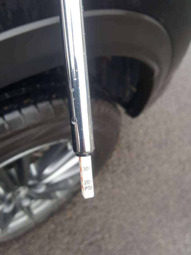

Just used a different gauge on same tire and shows a little higher .
Defiantly buying a digital one this week.
The door decal on my 2014 touring with 225/60/17 tires suggest 34 psig which is what I use. I tried higher and noting nothing changed except for a harder ride and at 38, I noticed less traction in heavy rain. Ed

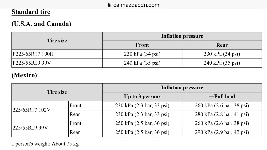

As long as the tire pressure is between 34~42 psi on 17" tires, it should be fine. Sometimes it becomes a personal preference for ride quality. From my experience "one-size-fit-all" factory recommended tire pressures used for US vehicles most likely have always been on the low side which wears outer tread more. See Mazda recommends different tire pressures for different load (many times for different speed) for 2017 CX-5 used in Mexico:
