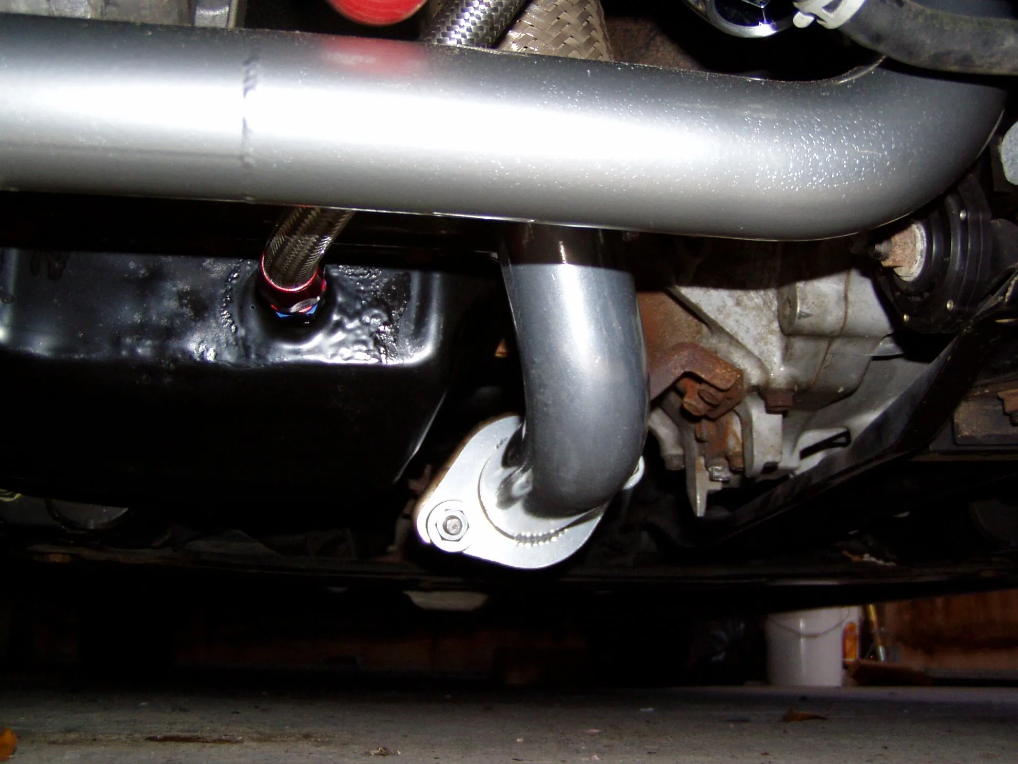

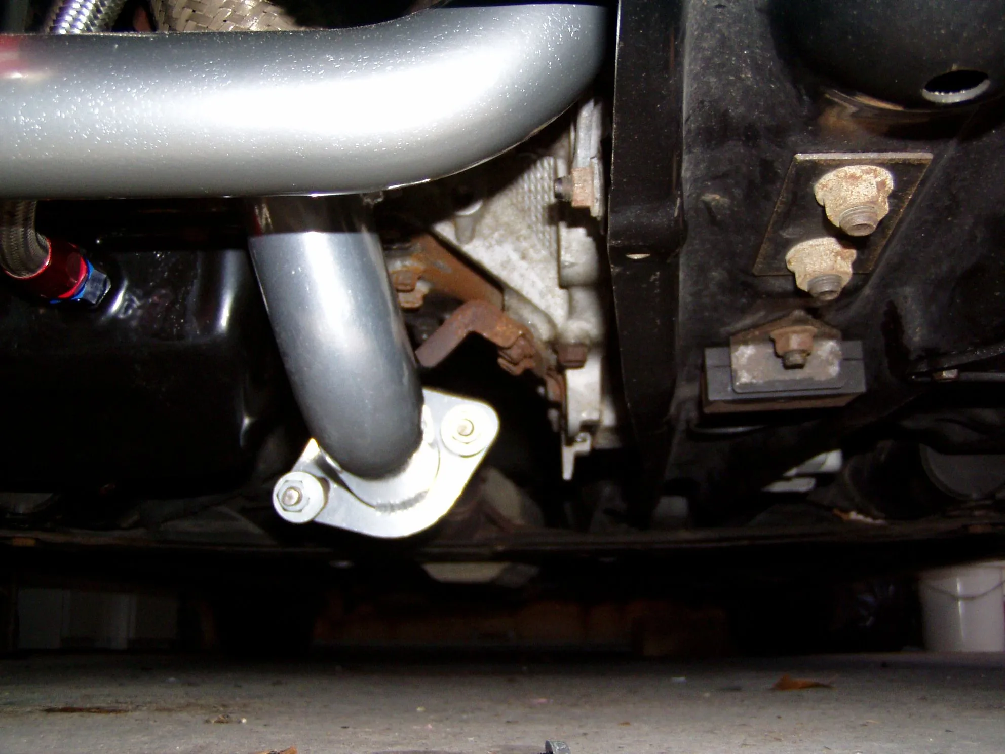

What did you MAM guys do for the Oil Return bung. Did you get a fitting? or did you fit a bung with the threads on the outside? (is that still a bung?) My oil pan is dented from some sort of impact(s). I think I will wait on the new one from MAM, and just keep using mine for now.

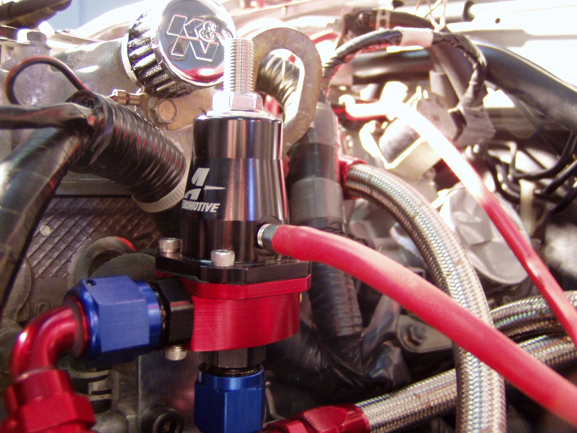

oh yeah, i'm also trying to figure out where that little air filter goes, too

beau supplied the fitting, you just need to get it welded to the pan at the right height, read the directions for this measurement. ya, i'm going to upgrade my pan too!
8. Clean the oil pan. Clean the adhesive off. You may want to get a gasket scraper to get it all off. Best bet is to buy "starting fluid" at NAPA. If not available, use a wash screen and get all the grime off. It needs to be a NICE flat, non sticky surface. VERY clean. Spend 30mins cleaning it. Look at where the oil return line is. Near the top. Make SURE the top of the oil pan (where the adhesive was) is clean with no imperfections so it will sit nice and flat and so no leaks will occur. If there are ANY bends on the "lip" of the pan, straighten them out.
that goes on the far right side of your valve cover see pic below. it's a breather filter.

I haven't gotten that fitting, either. A lot of stuff missing from my stuff. I am sponsored, so I don't get instructions. I get to figure it out. Make me better equipped to support customers.
I do have the oil pan off, just haven't cleaned it up yet. I broke my flathead trying to get it off, finally resorted to my air chisel which popped it off. Don't worry, didn't damage anything. Other than the flathead.
Does anyone have a picture of the location of the return bung? As far as I know, those directions didn't give you measurements. Unless "Near the top" was the measurements.
What is the purpose of the breather filter? Didn't notice that in the directions either.

i'll snap a pic for u
Thanks! Much appreciated.

my advice to you is if you are still confused contact wagnermotorsports.net and purchace an oil pan with the bung already on it, or just get your old oil pan and weld the bung on the front of the pan away from the bolt holes on the top but as close to the top as you can get it. use a rust proof high temp spray paint to protect the weld.
