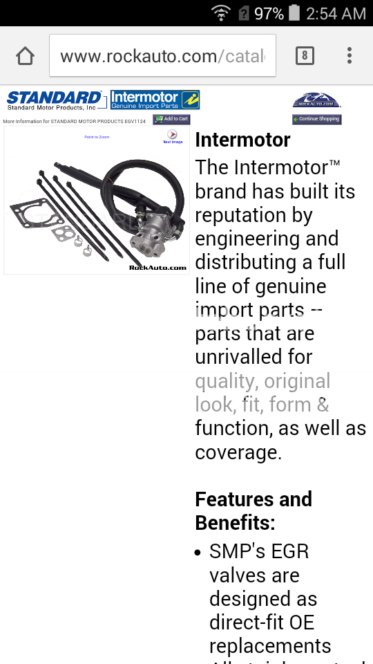

Lol I just went with a good ol oem from Mazda cause the Canada ones around here are closer to the 400 dollar mark and I wanted it fixed its a little cold in Maryland to ride my motorcycle right now so I payed 150 for the USA model egr
Yes they went way up in price. They used to be cheaper than the original design...
