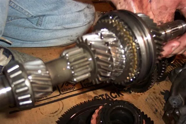

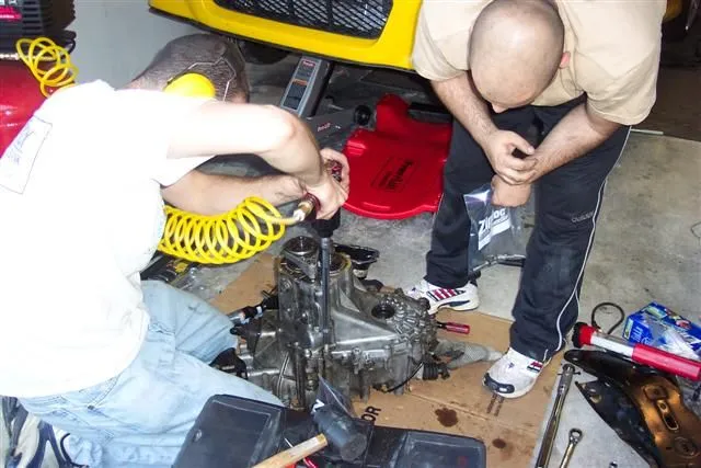

Well, DiS, CustomMSP and I pulled my trans today and tore it down...
Pic 1 - there is a magnet inside the trans. It picked up a lot of the busted teeth. Genius.

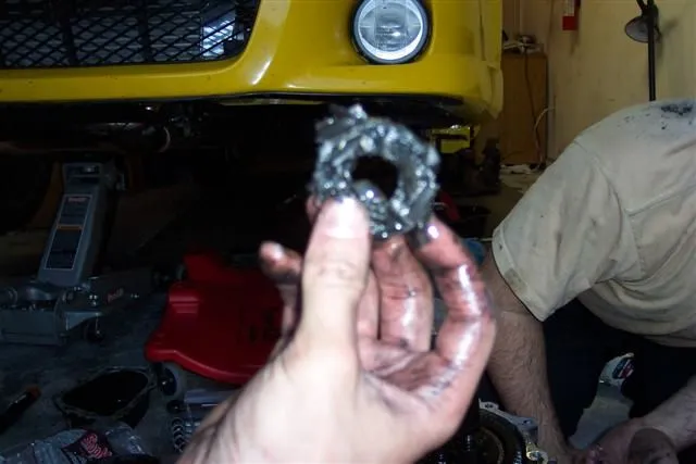

Pics 2,3 - 3rd gear. 0wn3d.

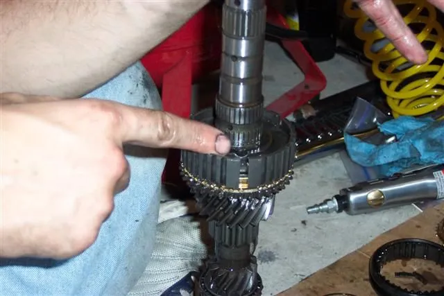

Pic 4 - How the hell do I get this thing off????? Anyone???

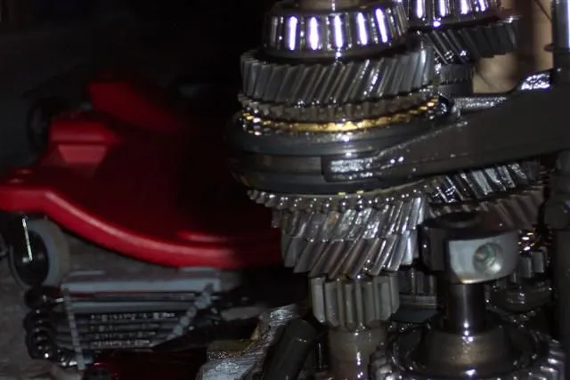

Pic 5 - New impact gun. Badass.

Soo...apparently I need a press to remove the gears??? Never heard this before...
dadrgon: wonderful
dadrgon: go buy a press
Kooldino: aren't presses big and $?
dadrgon: get a 20 ton press and you can rebuild the tranny
Kooldino: can't I rebuild it by hand?
dadrgon: nein
Kooldino: what? are you sure?
dadrgon: n00b, I ******* rebuilt trannys before
dadrgon: no way you can get a gear out without a press
Kooldino: I've gotten several out without a press

lol!!! I can back it up! CustomMSP and I were standing today next to Kooldino as he was pulling the gears by hand!

Yeah, you don't need a press to remove a gear. I was just telling dana about when I burned my first transmission. I sheered three entire teeth just from hardshift while auto-crossing. From the way the gear is orbitally sheered its just from the torque dumping on the gear. It happens, but focus is right, it's not so much from the strength of the gear, it's from weak lubrication. A stonger gearset won't necessarily solve the problem. Maybe some sort of tranny cooler or re-designed lubrication system would help. At least these trannies are easy to get..
Why bother changing gears on the shafts. Just drop in the mainshaft and output shaft right in to your casing complete.
